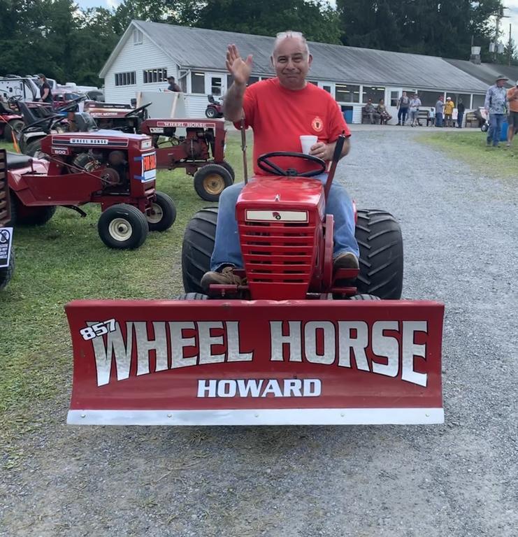

953 nut 66,719 #18 Posted December 14, 2020 Not sure what brand paint Howard used but I like it. 4 Share this post Link to post Share on other sites

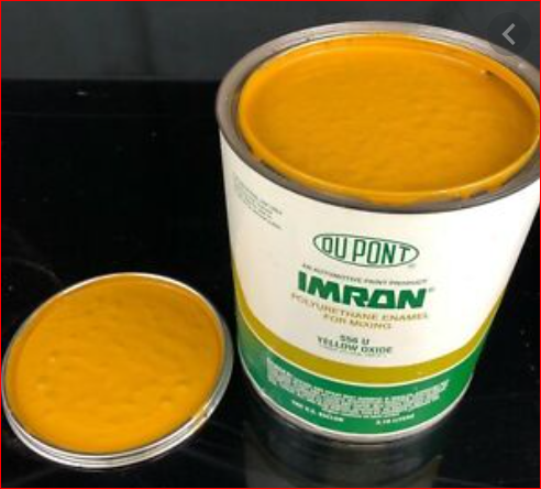

C-85 804 #20 Posted December 14, 2020 When I worked at a new car/truck/heavy truck dealers body shop, we used Dupont Imron paints for industrial usage. Municipal trucks like dump truck bodies and plows were often specked out to use Imron when painting, It was super expensive but lasted. I remember that some of us didn't wear a paint mask using some of the other paints, but we always did when spraying Imron, because it was known to be extra hazardous. C-85 3 2 Share this post Link to post Share on other sites

RandyLittrell 3,944 #25 Posted December 15, 2020 11 hours ago, C-85 said: When I worked at a new car/truck/heavy truck dealers body shop, we used Dupont Imron paints for industrial usage. Municipal trucks like dump truck bodies and plows were often specked out to use Imron when painting, It was super expensive but lasted. I remember that some of us didn't wear a paint mask using some of the other paints, but we always did when spraying Imron, because it was known to be extra hazardous. C-85 I'm a big fan of Imron, like you, I worked in a body shop when young and painted a whole fleet of concrete trucks. 4 hours of spraying for the Variprime and 4 hours for color per truck. I was damn tired at the end of those days! Imron is expensive but easy to spray I think. Absolutely wear a respirator with any paint you choose to spray. You can buy cheap disposible ones still I think, and your health will thank you later! Randy 1 2 Share this post Link to post Share on other sites
