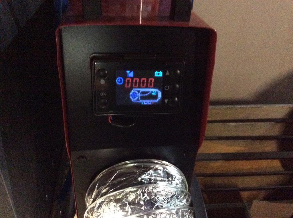

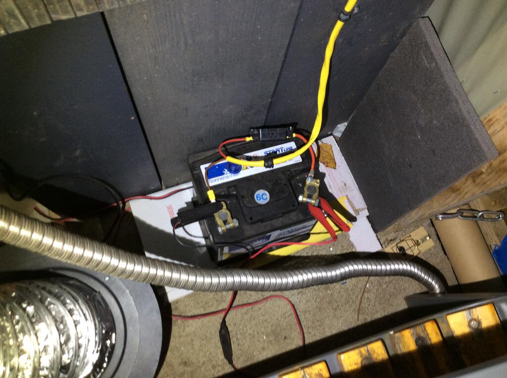

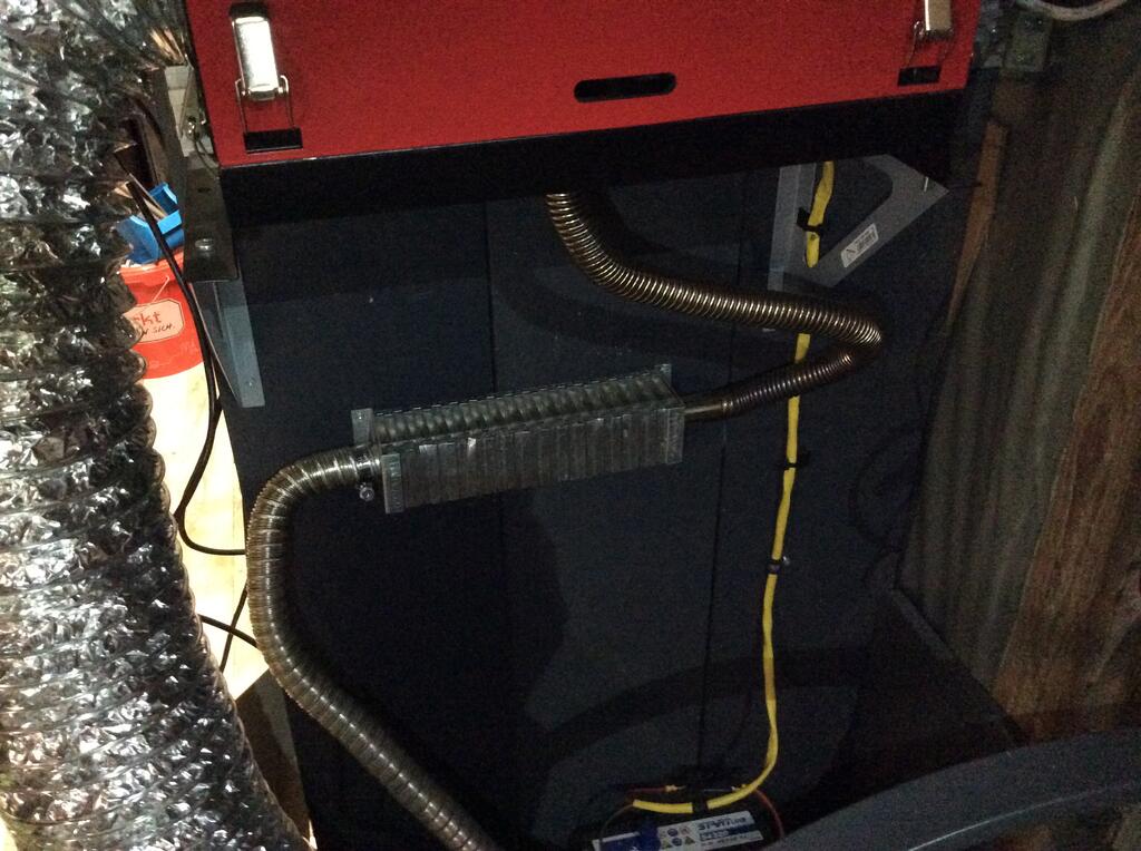

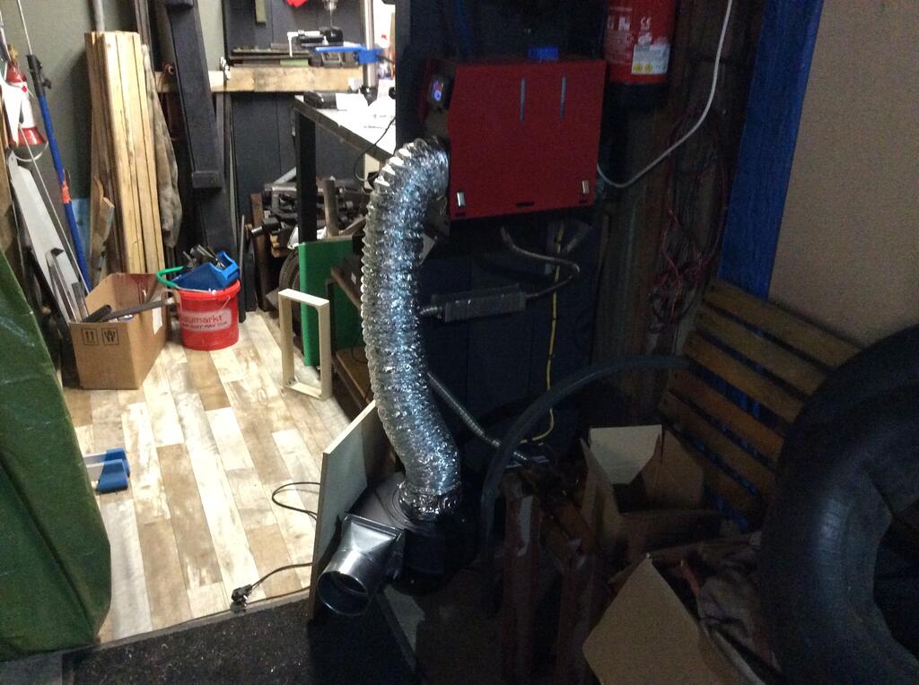

Tractorhead 9,218 #20 Posted December 8, 2020 (edited) I had buyed this unit All needed parts are integrated, i just reworked the sheetmetal a little where the lines and pipes internally passing it with a edgeprotection. then fill up and it works nearly each Day since 4 Weeks. @DennisThornton didn‘t know how it works with Kerosene, but curious about. The both Manufacturer you meant are Webasto and Eberspächer, the working on this Heater types over 60 years. Where Webasto picked now Whale in the row. So they had a bigger option with Diesel and LPG also. Eberspächer build just on Diesel and Gas. I don‘t see any Gas version at the chinese but with that solution on external Tank i‘ll be fine with. btw. Here Diesel will be made safe here up to -20deg at oct. on each filling Station. The other option here is heating oil, same as diesel, but no frostprotection. you can bring it safe to - 20 with adding Petroleum about 20%. I liked the idea of that Case, simply and compact and don‘t need any further connections except Exhaust and 12V I payed for mine 110€ that will be about 120-130 $ including this Case and i love it. @wallfish as long as your shed was shielded from Wind and little insulated it was able to heat the room, but than i would suggest a little bigger Tank and maybe the system i have because of easier mounting. An Attached 12V Starterbatt and an 12V Charger to recharge the battery so you are able to heat longterm. Runned mine 2 days without interrupt just refilled in the morning and later evening. Touched everytime the Case to see how hot it becomes, what was just Handwarm. If your Shed is little insulated it‘s just depending on time to get it Warm no doubt it will get it. it‘s just a5 KW and not a 20 KW heatgun. mine is an 80 year old Wooden structure, no insulation where i mount just few windshieldin tarps inside for now. Roofheight inside is about 5 meters without any insulation. The gaps between the wood slats is about 1-3 cm so you can spit thru without hittin them, but with the Attached external Fan i‘m able at - 5 deg to give me an warmed Place with about 15-16 deg where i can Work. And the windshielded tarps helps me a lot on this issue. will take tomorrow a Pict of my Setup, to show you how it is actually. Edited December 8, 2020 by Tractorhead 1 1 Share this post Link to post Share on other sites
WHX?? 58,324 #21 Posted December 8, 2020 15 hours ago, Tractorhead said: have one of these heaters You know the rules TH .... Pics??? 1 Share this post Link to post Share on other sites
Tractorhead 9,218 #22 Posted December 8, 2020 6 hours ago, WHX24 said: You know the rules TH .... Pics??? Huh yap Daddy, i know i know... give me a few Minutes... 1 1 Share this post Link to post Share on other sites
Tractorhead 9,218 #23 Posted December 8, 2020 Ok, i think a Video tells more than 1000 Picts.. Sorry for stumbling, but i‘s not my native language. Here also few Pict‘s the show it also. battery Setup, this is a 12V 60AH Starterbattery out of the old white Opel. the capacity is about on 90% usability. I recharge it with an 12V Charger directly. front side of the Heater with connected Fan (125mm diameter) high temp airpipe This is the whole Setup from the Sideview. And the Exhaust pipe with an added Cooler, basically used for Warmwater heaters to cool down the exhaust temps down to 70 deg. So i be able to lay the exhaustlice along my Sheddoor to prewarm incomeing Airstreams also.. Because all is wood, i like to keep the themp below 100 degrees.C hope that will clear my Setup. 2 2 Share this post Link to post Share on other sites
DennisThornton 4,773 #24 Posted December 8, 2020 Need to know a little more about this: I understand what you are doing but I've never seen one of these. How does it work? Share this post Link to post Share on other sites
