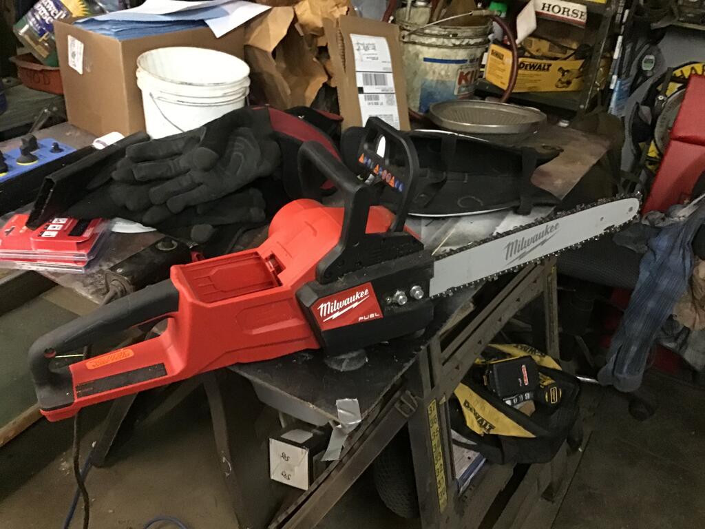

C-85 822 #59 Posted January 17, 2021 Here's how I tuned up! All I've ever had was old used gas saws until now that may or may not start. This things great, it always starts! Santa was very good to me this year! C-85 3 Share this post Link to post Share on other sites

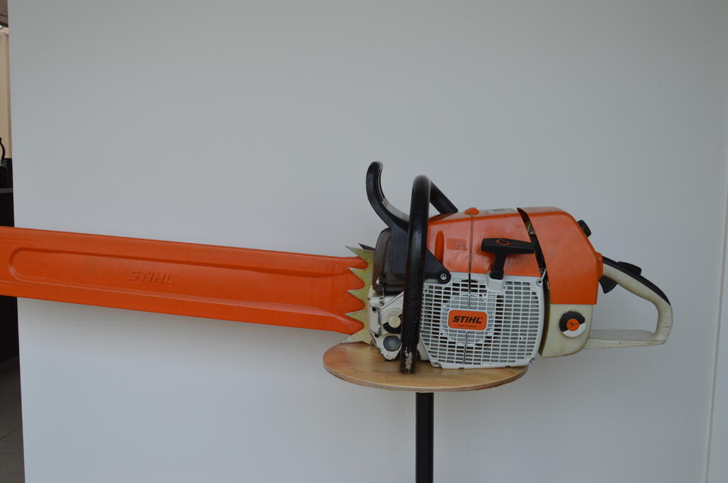

Maxwell-8 4,371 #63 Posted January 18, 2021 (edited) 3 hours ago, cschannuth said: My kids always used to look at me crazy when I told them that our chainsaw had a bigger engine than their 70 cc minibike, haha. I had a MS880 hahaha, 121cc, that is the same cc's most motorcycles are around here are. I sold it because the saw weight 25% of my own weight, the saw was playing with me instead of me with it. Edited January 18, 2021 by Maxwell-8 2 1 Share this post Link to post Share on other sites

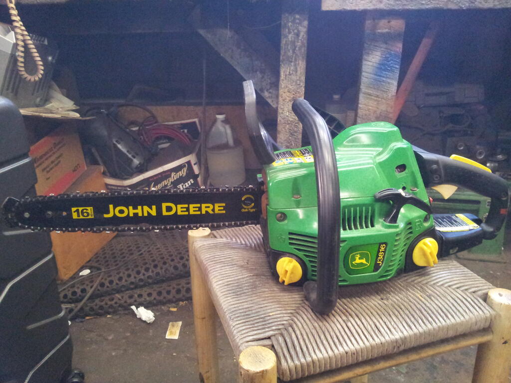

D_Mac 9,339 #73 Posted January 19, 2021 Cover your eyes gentleman, I saw this saw a few years back for sale kind of cheap so I bought it for my brother. Started easy and was in nice shape. He still uses it. One of the best deals I ever had was buying the Stihl. I got it in a package deal.. 5000 watt generator, a brand new 12g shotgun, and the Stihl MS361 all for 300 bucks. I went there to buy the generator and the guy asked if I was interested anything else. Was one of those days where I wish I had more cash on me. Still have the generator, sold the saw and the shotgun. Got more for the saw then I spent for everything. 1 Share this post Link to post Share on other sites
