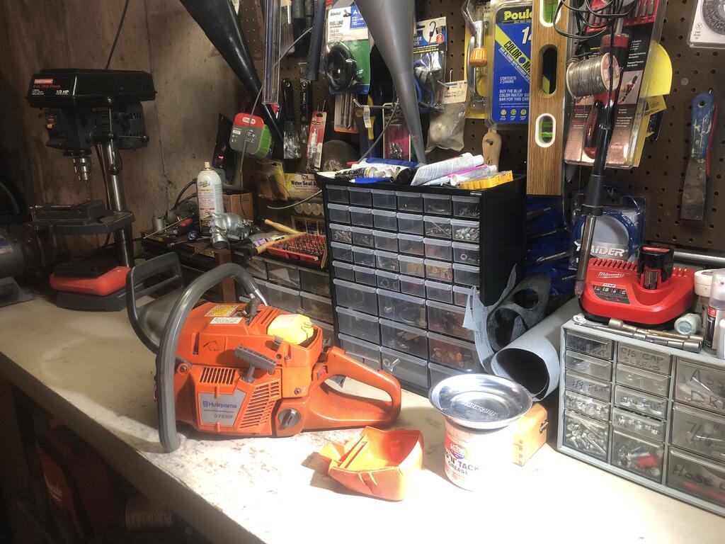

WheelhorseBob 1,550 #1 Posted December 6, 2020 Thought I’d share one of my many hobbies with all of you. I really enjoy rebuilding pro saws during the cold winter months. Mainly Huskys and Stihls. Gonna start in on this one tonight and it is my favorite model, a Husqvarna 372XP. The owner says it’s down on power so he wants it completely gone through. At a minimum it will get piston&rings/cylinder/seals/fuel lines and if the bottom end is at all loose bearings. If your at all curious about rebuilding these things, I recommend afleetcommand on YouTube. He’s awesome. 3 1 Share this post Link to post Share on other sites

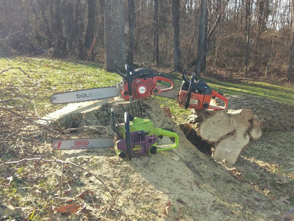

WVHillbilly520H 10,379 #5 Posted December 6, 2020 (edited) 11 minutes ago, ebinmaine said: I miss it's strength but MAN was it heavy!!! I do love my 2 "light weights"... excuse the green 1 but I did buy it new over 10 years and many cord of wood ago ALL 3 never fail to fire by the 3rd pull. Edited December 6, 2020 by WVHillbilly520H 2 1 Share this post Link to post Share on other sites

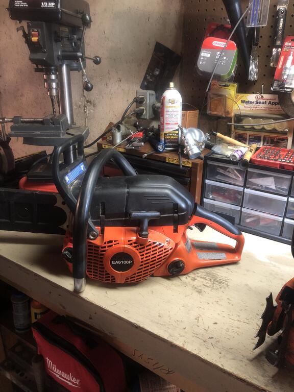

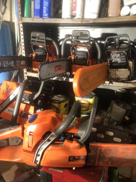

WheelhorseBob 1,550 #6 Posted December 6, 2020 Dolmar makes great saws! I have a Makita /Dolmar 6100p and it rips! I’m a bit saw heavy at the moment but I like them all! Current herd consists of a Stihl 044, three Husqvarna 372’s, a 357Xp that I made into a modified big bore (cuts like a light 70cc saw!) and the Dolkita. Oh and my lowly little Echo CS-450. That echo is the best “little” saw I’ve ever owned! 2 2 Share this post Link to post Share on other sites

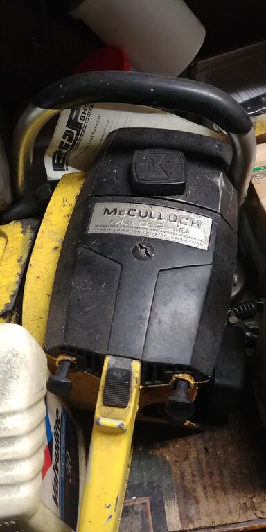

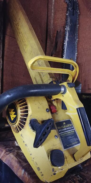

Digger 66 3,530 #8 Posted December 6, 2020 5 hours ago, WheelhorseBob said: I really enjoy rebuilding pro saws I find it fun too , nothing of that caliber in my arsenal . Just old junk that has people scratching their heads when they see chips flying . My Dad's old McCullagh and a newly acquired and "gone through" Poulan . 2 Share this post Link to post Share on other sites

ebinmaine 80,762 #10 Posted December 6, 2020 7 hours ago, WVHillbilly520H said: excuse the green No excuses needed there Jeff. Provided they're owned and maintained right that's a great little saw. 2 hours ago, Digger 66 said: newly acquired and "gone through" Poulan I've had saws similar to both that you have pictured. Had a little McCullough 10" bar maybe 12 or 15 years ago. Nice little "limber" but of course no chain brake. Didn't feel quite right using it and wasn't burning wood at that point. The Poulan Pro I had was a 46cc. Could have been more powerful but it was a nice running saw. 1 Share this post Link to post Share on other sites

WheelhorseBob 1,550 #15 Posted December 6, 2020 6 hours ago, Digger 66 said: I find it fun too , nothing of that caliber in my arsenal . Just old junk that has people scratching their heads when they see chips flying . My Dad's old McCullagh and a newly acquired and "gone through" Poulan . Nothin at all wrong with the older Macs! Lots of guys really love them. Check out Bellhopper McCulloch Chainsaws on YouTube, he really knows his Macs! 1 Share this post Link to post Share on other sites

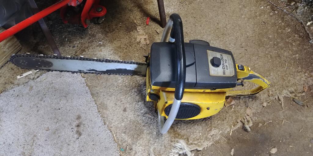

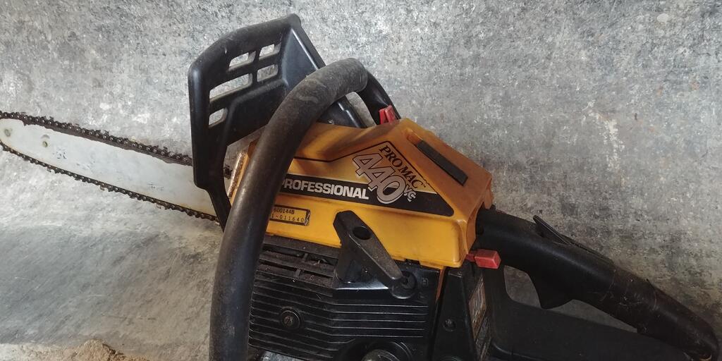

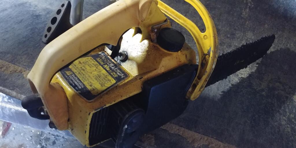

WVHillbilly520H 10,379 #17 Posted December 6, 2020 (edited) 20191026_142343.mp4 Here's my dad's collection of Macs, that old CP-70 was a screamer... The 440 was given to him and then to my boy... The MiniMac 25 was they only saw he ever bought new... And then big boy is a slow saw but some the harder trees this thing doesn't even skip a beat while the fast saw seems to "spark" the chain and dull. 20191026_142431.mp4 20191026_142431.mp4 20191026_142343.mp4 20191026_142343.mp4 20191026_142343.mp4 Edited December 6, 2020 by WVHillbilly520H 2 Share this post Link to post Share on other sites
slim67 2,825 #18 Posted December 6, 2020 12 hours ago, WheelhorseBob said: Dolmar makes great saws! I have a Makita /Dolmar 6100p and it rips! I’m a bit saw heavy at the moment but I like them all! Current herd consists of a Stihl 044, three Husqvarna 372’s, a 357Xp that I made into a modified big bore (cuts like a light 70cc saw!) and the Dolkita. Oh and my lowly little Echo CS-450. That echo is the best “little” saw I’ve ever owned! I had an opportunity to get a 6100 from Home Depot rental but missed it. I still keep checking but they are all makita colors now. 1 Share this post Link to post Share on other sites

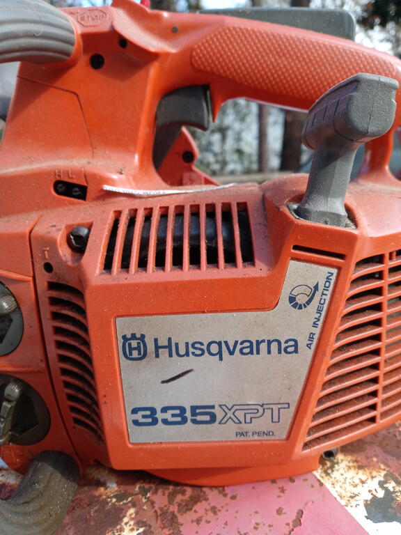

Horse Newbie 7,405 #19 Posted December 6, 2020 4 hours ago, WheelhorseBob said: I miss read your first post, it still pulls over but it gets more difficult? Than yes, as previously mentioned I would look at the decompression valve. @WheelhorseBob Please see the pic for my model. I don't believe it has a decompression valve, at least the manual did not mention one. But then again it was not a service manual...jist an owners manual. Don't think its the wrong plug as it's either got the original plug , or I generally put the exact same plug back in. Always make sure to compare plug length before I install also. Share this post Link to post Share on other sites

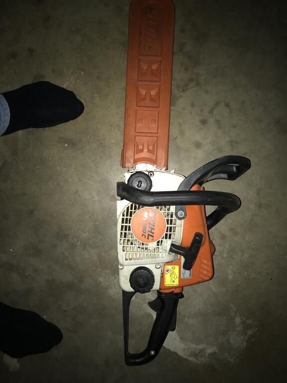

oliver2-44 11,758 #20 Posted December 6, 2020 the first chainsaw I began using in roughly 1972 was an old Mono-??something. It was a beast of a saw. I believe my dad bought it in about 1965. In about 1974 we had to do a lot of clearing to replace a long section of fence and he bough a McCulloch Pro Mac 10-10. i kept that saw running until about I years ago and sold it at a garage sale. I miss it. I bought Stihl Ms180C for light duty trimming . I barely used it 2-3 tanks of fuel over 3 years and the lower polycarbonate case warped so it has an air leak. it runs good until it gets warm and then you just don't have any power. They had a "Stihl Day" at the Feed/Outdoor Power Equipment Store , and I talked to the rep about some warranty help since it was 3 years old and the paint wasn't even worn on the bar. But no help. At the time I bought my Stihl I didn't realize part of the case was polycarbonate plastic. I guess that's one place they cut cost. I'm keeping it with the though that some day I will do a full disassembly to repair that case air leak or use it for parts. Then a neighbor gave me an identical Stihl that wouldn't run. I did a good deep carb cleaning and now it's been a great running saw. I don't know if it matters, but I'm careful to not run it to long at a time so I don't over heat the polycarbonate case. 1 Share this post Link to post Share on other sites
WheelhorseBob 1,550 #21 Posted December 6, 2020 1 hour ago, Horse Newbie said: @WheelhorseBob Please see the pic for my model. I don't believe it has a decompression valve, at least the manual did not mention one. But then again it was not a service manual...jist an owners manual. Don't think its the wrong plug as it's either got the original plug , or I generally put the exact same plug back in. Always make sure to compare plug length before I install also. Well it looks as though that saw may have a decompression valve and an auto one at that. I’ve never actually worked on nor ran that model saw so it’s hard for me to trouble shoot via this post. Check for the decomp and see if it is working. I found this when I looked, it may help. http://www.mymowerparts.com/pdf/Husqvarna-Service-Bulletins/B0401016.pdf. If all checks out with the decomp, pull the recoil and turn it over by hand to rule out recoil issues. Then pull the clutch cover and check the chain break and clutch for anything out of order. Kind of a process of elimination. Share this post Link to post Share on other sites
WheelhorseBob 1,550 #22 Posted December 6, 2020 48 minutes ago, oliver2-44 said: the first chainsaw I began using in roughly 1972 was an old Mono-??something. It was a beast of a saw. I believe my dad bought it in about 1965. In about 1974 we had to do a lot of clearing to replace a long section of fence and he bough a McCulloch Pro Mac 10-10. i kept that saw running until about I years ago and sold it at a garage sale. I miss it. I bought Stihl Ms180C for light duty trimming . I barely used it 2-3 tanks of fuel over 3 years and the lower polycarbonate case warped so it has an air leak. it runs good until it gets warm and then you just don't have any power. They had a "Stihl Day" at the Feed/Outdoor Power Equipment Store , and I talked to the rep about some warranty help since it was 3 years old and the paint wasn't even worn on the bar. But no help. At the time I bought my Stihl I didn't realize part of the case was polycarbonate plastic. I guess that's one place they cut cost. I'm keeping it with the though that some day I will do a full disassembly to repair that case air leak or use it for parts. Then a neighbor gave me an identical Stihl that wouldn't run. I did a good deep carb cleaning and now it's been a great running saw. I don't know if it matters, but I'm careful to not run it to long at a time so I don't over heat the polycarbonate case. One of the main reasons I like to work on Pro saws is the two piece magnesium cases. Saws that utilize poly case bottoms are known as “clamshells”. They are almost all homeowners saws and from what I’ve seen a pita to work on! The way the two piece crankcase is put together begs for air leaks. 1 1 Share this post Link to post Share on other sites
oliver2-44 11,758 #23 Posted December 6, 2020 44 minutes ago, WheelhorseBob said: One of the main reasons I like to work on Pro saws is the two piece magnesium cases. Saws that utilize poly case bottoms are known as “clamshells”. They are almost all homeowners saws and from what I’ve seen a pita to work on! The way the two piece crankcase is put together begs for air leaks. I really only needed a homeowner type saw for trimming a few tree limbs and cutting some BBQ wood. Ive certainly learned my lesson. I’ll only buy Pro saws from now on. 1 Share this post Link to post Share on other sites
