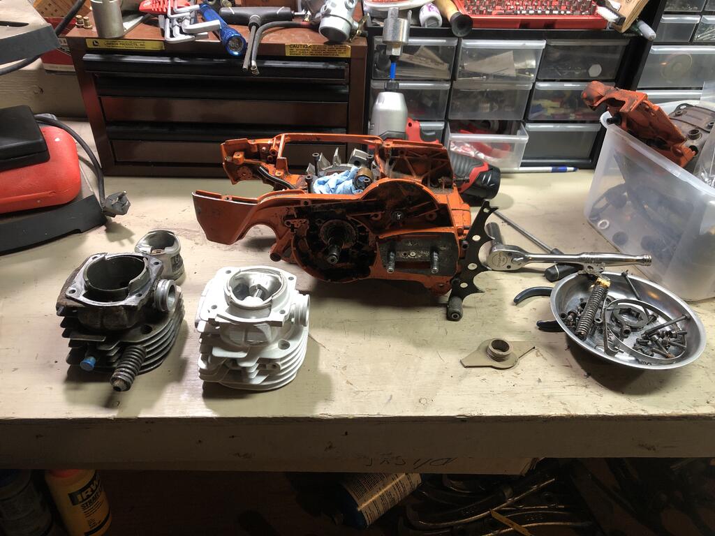

WheelhorseBob 1,550 #36 Posted January 9, 2021 Stripped and ready for a serious cleaning! Been a bit behind on things lately, but got my transaxle back together yesterday and started in on another saw today. Trust me cleaning bar oil and sawdust gunk is not fun! 3 Share this post Link to post Share on other sites
ebinmaine 80,116 #37 Posted January 9, 2021 30 minutes ago, WheelhorseBob said: Trust me cleaning bar oil and sawdust gunk is not fun That stuff is kinda like the muck in certain places on a horse that hasn't been cleaned .... Ever. No good way to remove it. Looks good now! Share this post Link to post Share on other sites
