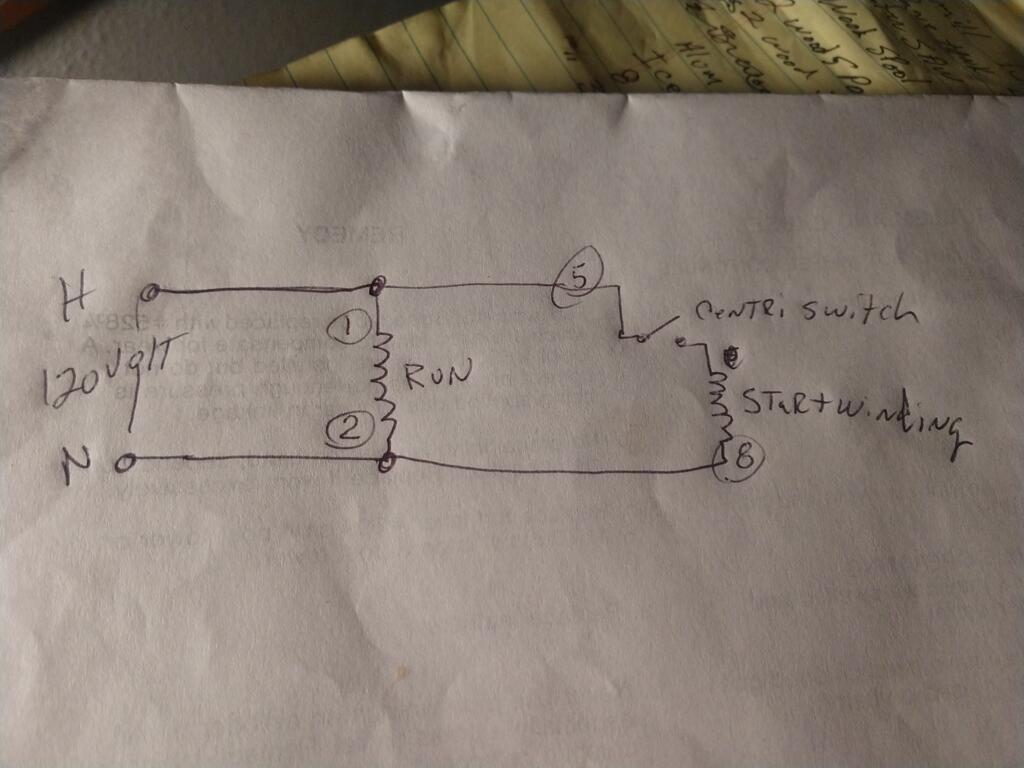

seven 202 #26 Posted December 3, 2020 1-2 is your run winding 5-8 is start winding interchange 5-8 it should go in reverse . Im pretty sure you hook the two windings in parallel . 1 Share this post Link to post Share on other sites
formariz 12,381 #28 Posted December 3, 2020 2 minutes ago, seven said: That is exactly what I figured out. Its in service already. Many thanks. Share this post Link to post Share on other sites
