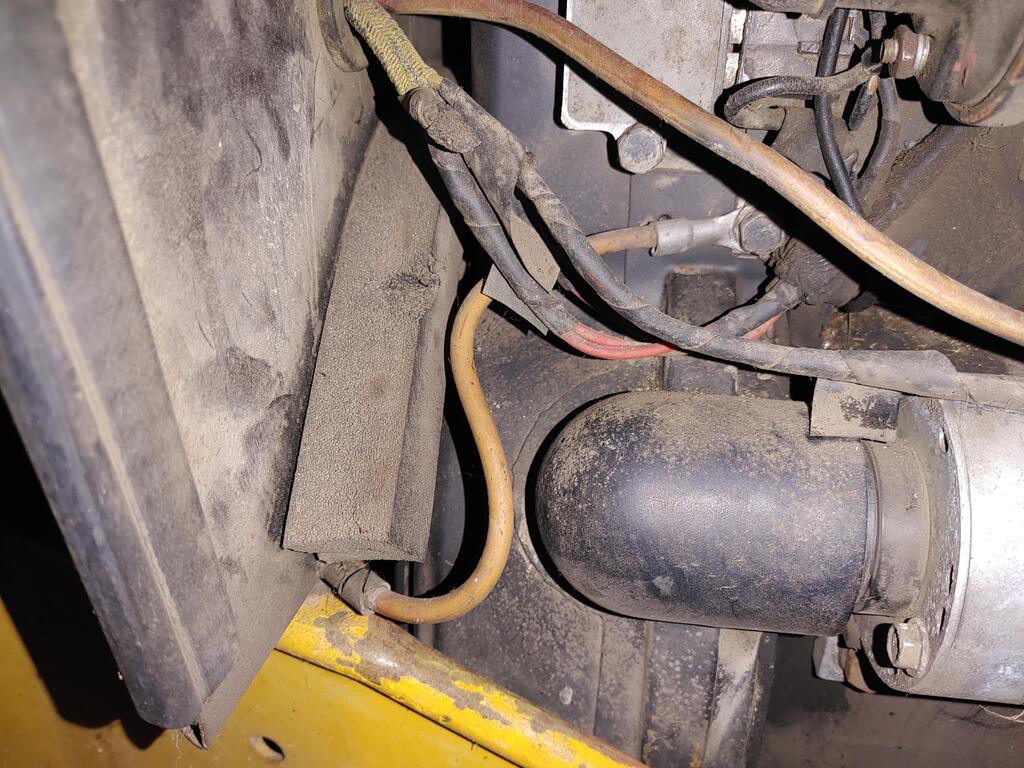

Might have found something today while looking at my Dad's unmolested 1200... Looks like there's an extra factory ground strap from the block to the frame :eusa-think:... gonna give this try and I did order Kohler O.E. points and condenser to try as well.
