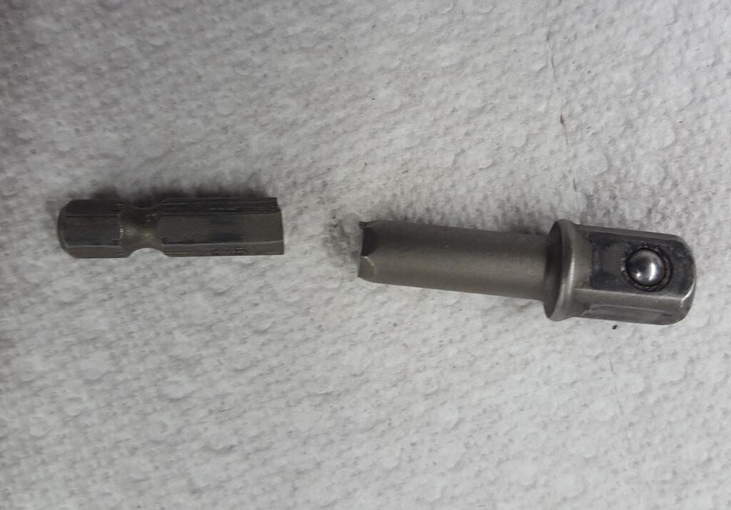

Gregor 4,848 #60 Posted December 24, 2020 The Tecumseh H70 has almost reached official status of doorstop. I hate to give up on anything, but this has me stumped. It started that first night, and a couple of time since, but never ran long. I honestly don't know if it's a fuel problem, or an ignition problem anymore. It doesn't help that the Tecumseh Tech Manual gives 2 different BTDC specs. .080 on page 95, and .090 on page 96. Which one should be used? I have had the flywheel and head off of this thing so many times, I can't count. So many times in fact, I made a flywheel puller. (see tools section) When and if it ever runs again, I plan to get a new head gasket, and new head bolts. One of the things that bother me is the fit of the woodruff key. It is 1/8 by 3/4. It seems to fit very loose. A 5/32 will not begin to fit. Is there such thing as a 9/64 ? If there is, I haven't found one. I ordered new keys from a Tecumseh parts supplier, I guess I'll find out. Before I ever took this motor apart, I marked the timing position. The last time I had the flywheel off, I set the timing there. Didn't help. Then I did something I REALLY hate. I resorted to starting fluid. This is what can happen with starting fluid when things go bad. Snapped my driver bit in 2. I guess I will pull the head and flywheel one more time tonight, and set the timing again. Just not sure what I am going to set it at. Any suggestions? Thanks Greg 1 Share this post Link to post Share on other sites

ZXT 2,402 #62 Posted December 25, 2020 You say you aren't getting spark through the plug, but that it broke your driver - which indicates that it kicked back and has spark. Is the condenser in it new? That's definitely where I'd start. 1 Share this post Link to post Share on other sites

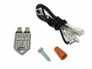

305 381 #70 Posted December 25, 2020 Tractorhead....what is this module to convert from points to breakerless on a Tecumseh H60? Share this post Link to post Share on other sites

Tractorhead 9,217 #73 Posted December 25, 2020 3 hours ago, 305 said: Tractorhead....what is this module to convert from points to breakerless on a Tecumseh H60? This thing is called a nova -2 electronic ignition module the connection is as simple as it can be. there is a negative terminal and a positive terminal on it. They send it with a simple to understand leaflet. on the negative terminal the wire with premounted groundconnector will be connected and mounted with the module together to ground on Engine. If you remove the points, the place of the Points can be used and the former points screw can be used as connection place. The Terminal with the plus mark will be connected on the wire from the ignition coil ( magneto) that normally goes to the points and the condenser and replaces them both. The wire nut in the Set is for connecting this both wires together, but i will connect it by Crimp mounts. that‘s it, Hardwareparts mostly be done. At least the complete ignition module will be moved little in advance direction for about 1,5 to 2 mm turned with the complete mounting plate. That means you have to Bring the ignition little more advanced of BTDC so ignition is a bit earlier than with points that‘s it. At this steps you can remove the points forever and the condenser and no points setup must be done after that conversion. So it’s cheap and simple Way to bring a points ignition to breakerless. mine is on it‘s Way and i will make a short Video with the How To when it arrives. the technics behind is a simple voltage dependent switch. while the magnet passes the magneto Coil a voltage of up to 250V on the Triggerwire will be occur. If this Voltage reaches a defined voltage level i guess 200V a electronic Switch acts an shorts the wire to ground until magnetic field collapses and a spark will be inducted. Bang - Spark than the same process again on each revolution, just without any Points. A simple electronic device, that if correct installed - is a genius solution. Share this post Link to post Share on other sites
ebinmaine 80,319 #74 Posted December 25, 2020 3 minutes ago, Tractorhead said: This thing is called a nova -2 electronic ignition module the connection is as simple as it can be. there is a negative terminal and a positive terminal on it. They send it with a simple to understand leaflet. on the negative terminal the wire with premounted groundconnector will be connected and mounted with the module together to ground on Engine. If you remove the points, the place of the Points can be used and the former points screw can be used as connection place. The Terminal with the plus mark will be connected on the wire from the ignition coil ( magneto) that normally goes to the points and the condenser and replaces them both. The wire nut in the Set is for connecting this both wires together, but i will connect it by Crimp mounts. that‘s it, Hardwareparts mostly be done. At least the complete ignition module will be moved little in advance direction for about 1,5 to 2 mm turned with the complete mounting plate. That means you have to Bring the ignition little more advanced of BTDC so ignition is a bit earlier than with points that‘s it. At this steps you can remove the points forever and the condenser and no points setup must be done after that conversion. So it’s cheap and simple Way to bring a points ignition to breakerless. mine is on it‘s Way and i will make a short Video with the How To when it arrives. the technics behind is a simple voltage dependent switch. while the magnet passes the magneto Coil a voltage of up to 250V on the Triggerwire will be occur. If this Voltage reaches a defined voltage level i guess 200V a electronic Switch acts an shorts the wire to ground until magnetic field collapses and a spark will be inducted. Bang - Spark than the same process again on each revolution, just without any Points. A simple electronic device, that if correct installed - is a genius solution. We have one of these in a Briggs and Stratton that works great but it has no charging system hence no extra magnets. I'm really hoping your Tecumseh engine WITH a charging system will be able to use the module. If you're successful I'll likely try one on Trina's techie at some point. Share this post Link to post Share on other sites
305 381 #75 Posted December 25, 2020 And they told you that it would work with the H60 with two magnets in the flywheel? Share this post Link to post Share on other sites
