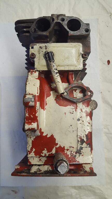

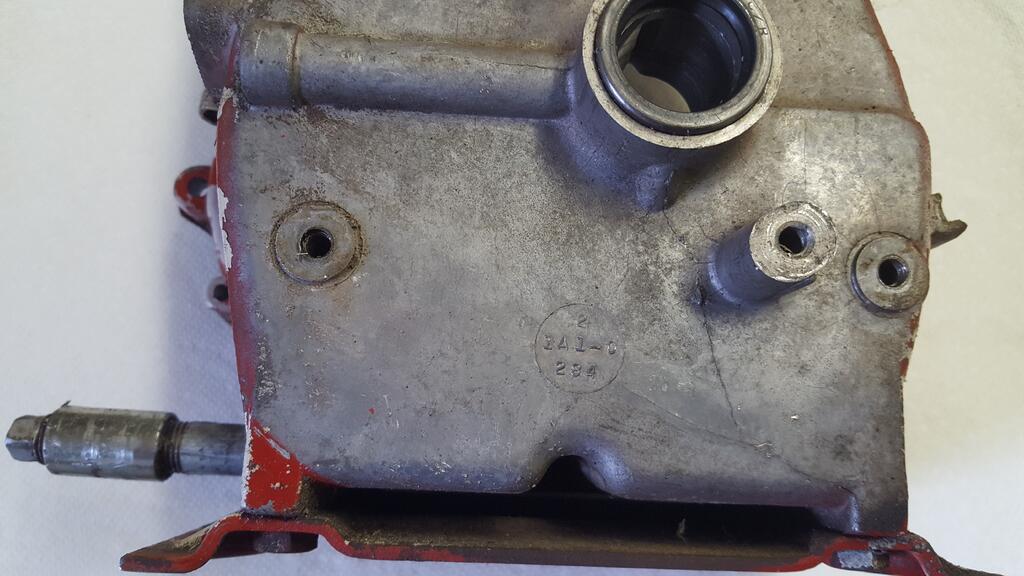

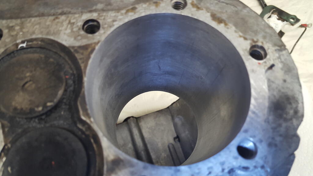

Gregor 4,848 #30 Posted December 4, 2020 I mentioned earlier that I had ordered an H70 block from ebay. I just got it. Bore measures 2.75. I will remove the valves, look things over and decide which block to use. The good news is, the block I just received has the same mark as my original block. I am going with casting mark, and definitely not a crack. I am not sure how these pics are going to load. First pic last? Last pic first? The block with all the red paint is my original block. I didn't do anything to the new block except wipe it with a little acetone.. Share this post Link to post Share on other sites

squonk 47,890 #34 Posted December 4, 2020 On 12/2/2020 at 2:32 PM, Gregor said: I looked up everything again.(took a while) All that did was confuse me more. On page 95 of this manual, https://www.allotment-garden.org/rotavator-manuals/Techumseh-L-Head-Engines-Manual.pdf (if you want to look it up), it says cylinder bore for an H60 is 2.62" On page 96 it says cylinder bore for an H70 is 3.06". Mine measures 2.75" This lead me to believe I had an H60 block bored 10 over. Doesn't that make sense? NOW I notice on page 95 it says cylinder bore for an H70 is 2.75" Why the discrepancy in the specs in the manual? Or am I reading the manual wrong? So....If I do in fact have an H70 block, I just ordered the wrong rings. Here is a pic of the piston and rod. The number stamped on the rod is 25 026 if that means anything. Sp If that's the piston out of the engine you're going to use, that block would not get cleaned up with a regular hone. It would need boring. As far as cracks go, spray some carb cleaner on it and walk away. Come back in an hour and if it looks worse, it's a crack. Share this post Link to post Share on other sites

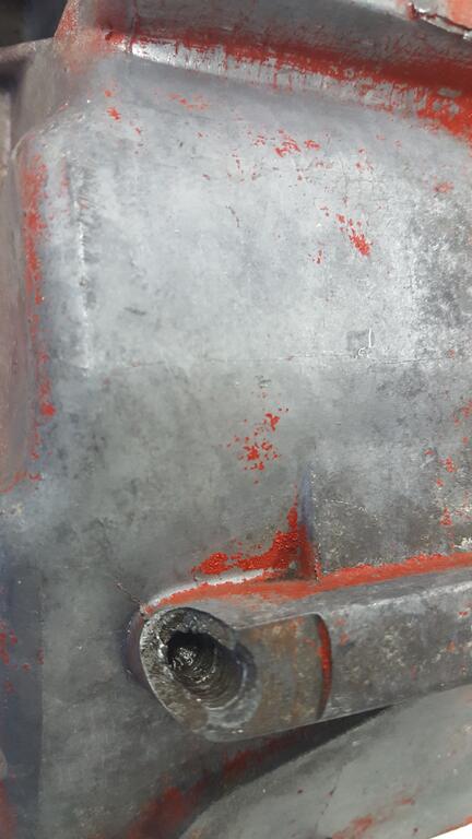

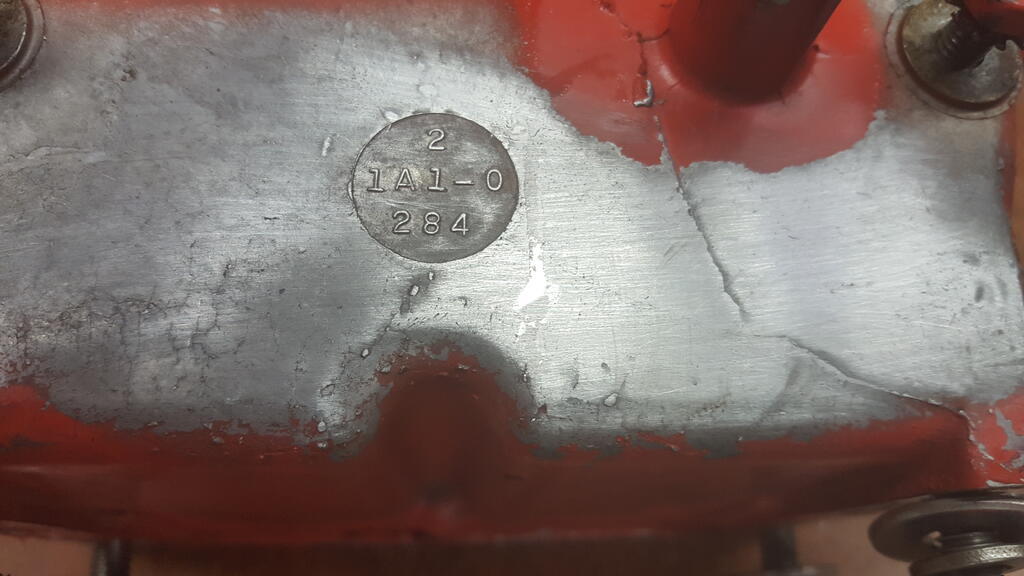

Gregor 4,848 #35 Posted December 4, 2020 1 hour ago, squonk said: If that's the piston out of the engine you're going to use, that block would not get cleaned up with a regular hone. It would need boring 1 hour ago, squonk said: I am not using that block. I have another. I have been cleaning up the new block I just received. At one point, someone thought it would look better white than red, I disagree. The cylinder does have some scratches in it, but honed nicely, and measures 2.75. While cleaning up the block, I discovered this. This is one of the bosses where the starter bolts on. I have been considering options. Leave it as is, hope for the best. Drill completely through, and tap it. Apply some aviation sealer, (that is some sticky stuff) to the bolt. The oil capacity is 19 oz, so I believe it will be above that line. What would you do? Share this post Link to post Share on other sites

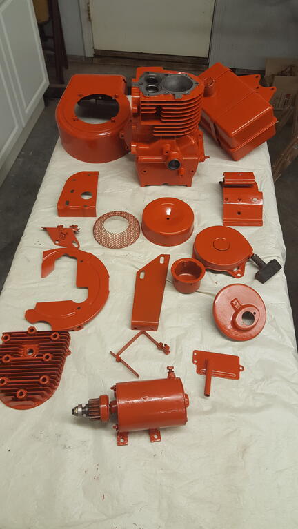

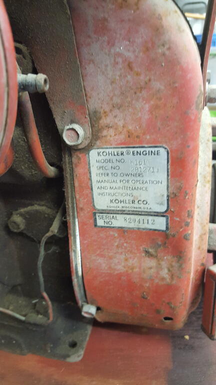

Gregor 4,848 #36 Posted December 5, 2020 I am making headway on the H7. I think I have repaired the broken starter boss. Mostly still cleaning parts and removing my skin on a wire wheel. In the meantime, look what I found! My small engine guy called me and told me he had the coil for me that he had ordered for another project I have going on. When I went to pick it up, he had this. A Kohler K161T. According to the serial number, if I am reading it right, it is a 1977. It turns over, that's all I cared about. He told me it came off a snowblower many moons ago. It's been in his shed. I have too many projects going right now to tear into this, but I am going to be looking for parts.Possibly a new motor shroud that will accommodate an electric starter. A flywheel with a ring gear. I don't even know if this motor is built o accept a stator, but the block will accept a starter. This motor has something I have never seen before. It has a button on the points cover. Is this a kill button? If not, what is it? 1 Share this post Link to post Share on other sites

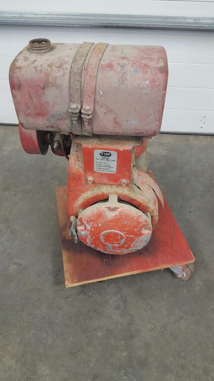

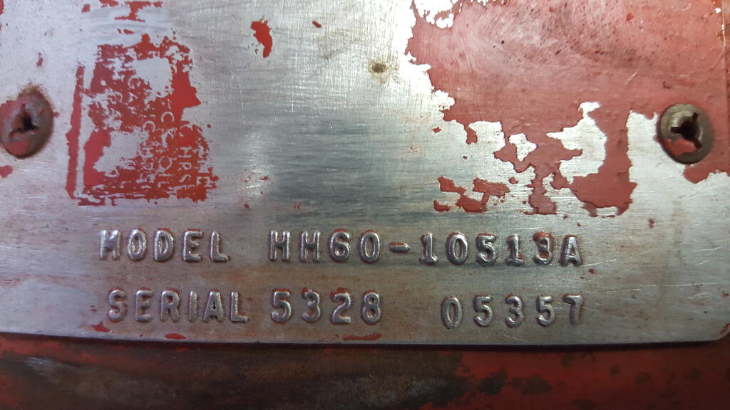

Gregor 4,848 #43 Posted December 14, 2020 I took this model and serial number plate off the Tecumseh. It's caused me nothing but problems. I would like to have another made. Not sure what I would put on it, but I do know it is an H70. Is anyone reproducing these? Thanks Greg Share this post Link to post Share on other sites
305 381 #44 Posted December 14, 2020 i doubt that anyone is reproducing the model/serial number plate. then you would also have to know the type number if you need it marked H70 i suggest you make one out of thin aluminum using that as a pattern and pop rivet it on. you do have number and letter stamps? Share this post Link to post Share on other sites
Gregor 4,848 #45 Posted December 14, 2020 I don't have a stamping set. If the motor runs when I'm done, the type # would be GregorBuilt 2 1 Share this post Link to post Share on other sites
WHNJ701 4,173 #46 Posted December 14, 2020 1 hour ago, Gregor said: I took this model and serial number plate off the Tecumseh. It's caused me nothing but problems. I would like to have another made. Not sure what I would put on it, but I do know it is an H70. Is anyone reproducing these? Thanks Greg Try @Vinylguy he might be able to make you decal for you to put on a piece of aluminum. There's a few people out there that make restoration grade engine plates. Somewhere I have a dudes card he makes nice stuff but not cheap. Share this post Link to post Share on other sites

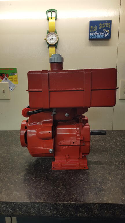

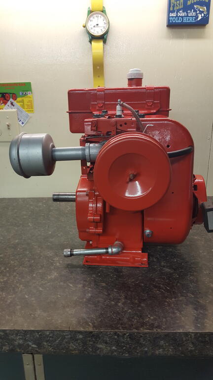

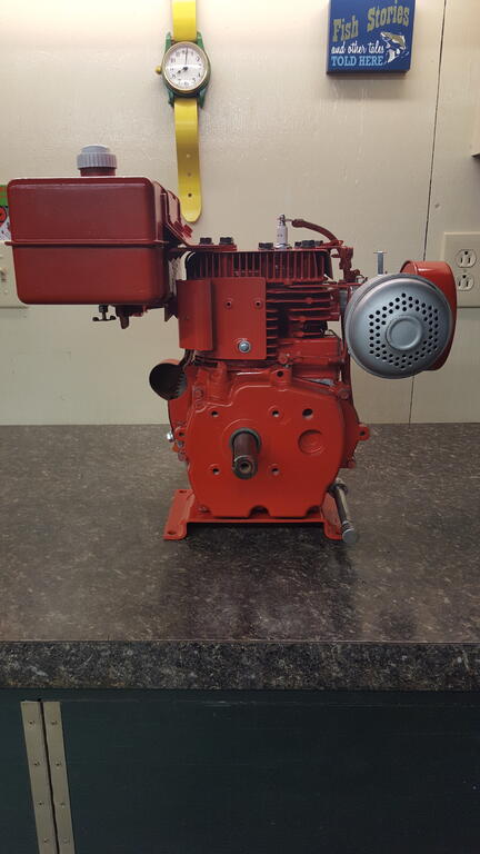

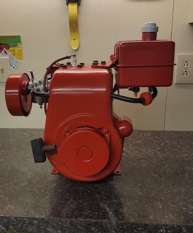

Gregor 4,848 #49 Posted December 23, 2020 (edited) The Tecumseh H70 is all back together, except for the starter. I wasn't paying close enough attention when I disassembled the starter, and I think I have it put back together wrong. Will Have to work on that. I spent a LOT of time on installing the intake valve, then I taught myself a trick, and the exhaust went very quick. I also spent a LOT LOT LOT of time on setting the timing. Before I took it apart, I marked where it was. It is no where near that now. I hope it's close enough to work. I have spark, I have good compression. I am assuming these motors do not have ACR, which would account for me almost breaking my wrist, the first time I went to spin it with a drill. I'm glad I had it clamped down. It has fuel in it, and oil, and is ready to go, but not tonight. If it didn't start, I would lay awake wondering why. Now I can just lay awake wondering if. When I got it, it didn't have a gas cap. That's a Lawnboy loaner. Is that wrong? Edited December 23, 2020 by Gregor 1 2 Share this post Link to post Share on other sites
305 381 #50 Posted December 23, 2020 that's a nice looking motor, good job. i look forward to here about how well it runs. i see you do not have the exhaust brace on yet do you have plans to use it , or are you sticking with the Predator ? Share this post Link to post Share on other sites
