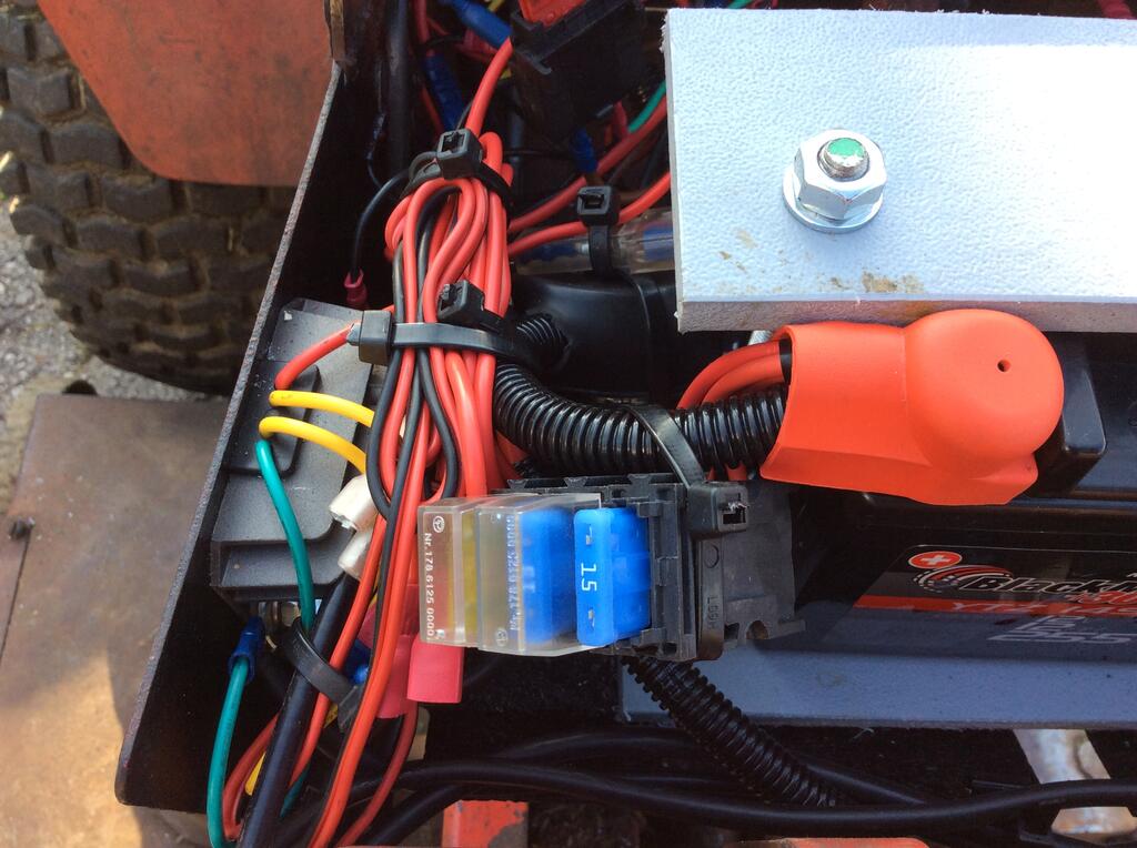

Tractorhead 9,217 #280 Posted January 23, 2021 (edited) 3 hours ago, Gregor said: @Tractorhead I received this today. I ordered it several days ago. Can you tell? Is it actually a REGULATOR, or simply a RECTIFIER? Thanks Greg Voltage Regulator Rectifier That is a Combo rectifier regulator, i have the same in my Tracta. To use this, you need a Ground Free AC input, that means you must bring it back in the Order, it was before the diodes working. It have to be connected like my first pict without the Ground But instead to go to Diodes both AC Lead go directly into the both Yellow wires on the Regulator. The green Wire from the Regulator go directly to Ground on chassis or Battery( what i prefer) and the Red Wire go via a inline Fuse direct to Battery or better to IGN on Keyswitch. I put the Red Wire to the IGN port on Keyswitch, so if regulator fails for whatever Reason it cannot drop my Battery when Tracta is stopped. found few Picts from my Electric in the 656 i reworked completely. it is not in a final State, it is just a short term Testinstallation - until now... 😎 I use a 10A Inline Fuse flat car type,(left lower in the Pict close to the Keyswitch) because i just protect my Wires not a Electronic Part. Directly Attached with a Y connector is with a Violett Wire the Voltage Display. The 20A fuse directly next to the Battery is the Main Battery Fuse including Solenoid ( except Startermotor) The second 15A is planed for a Remote connector ( maybe later a Cigarett lighter) direct from Battery The third 15A is unused for now ( spare Fuse) for later purposes. In the Pict you can see, i mounted my Regulator in the Dashbox even my Motocycle Battery Fits here. It doesn‘t Touch any Metal Parts the Mounting Bracked is made of Plastic i build myself. That is my Starter Battery. I tried it one, i can run the Starterengine without any problems. 255CCA seems enough Power to fireup my Horse. That is the same Battery i use in my KTM Motorbike. Don‘t compare my Electric about Wirecolors with yours, i changed the whole Wires because i have my own Colorscheme. Edited January 23, 2021 by Tractorhead Share this post Link to post Share on other sites
Gregor 4,848 #281 Posted January 23, 2021 24 VAC input to regulator says yellow and pink wire. Green to ground, red to battery. You have a Lawn Boy gas cap too ! 1 Share this post Link to post Share on other sites

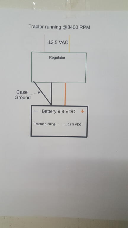

Gregor 4,848 #283 Posted January 23, 2021 (edited) 13.7 VAC into voltage regulator. Ground wire off. @ 3300 RPM 6.7 DCV out. With my diodes, Ground wire on. 21 VAC into diodes @ 3300 RPM, 15.6 DCV out. Think I'll stick with what I have. I got the voltage regulator today, wanted to try it out. Maybe it would go up if I disconnected battery? It is fully charged. EDIT:......Actually....I didn't have it connected to my battery, only my meter. Edited January 23, 2021 by Gregor Share this post Link to post Share on other sites

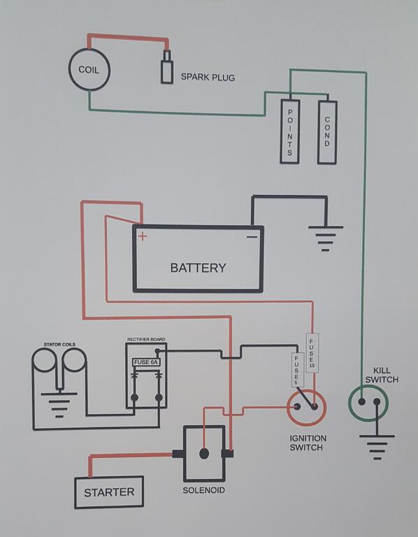

Gregor 4,848 #284 Posted January 24, 2021 @Tractorhead This is the wiring for my tractor. I have a new ignition switch on order. When it gets here I will replace the 2 push button switches. Do you see any changes you would make? Any suggestions? Share this post Link to post Share on other sites
Tractorhead 9,217 #285 Posted January 24, 2021 No changes needed. whatever you measure on that Regulator is wrong. this regulator needs urgently a battery as reference. Share this post Link to post Share on other sites
Gregor 4,848 #286 Posted January 24, 2021 6 minutes ago, Tractorhead said: whatever you measure on that Regulator is wrong. this regulator needs urgently a battery as reference. I figured as much. I have a spare battery. I hooked a light to it. I am going to let it run down, and hook everything back up again. 1 Share this post Link to post Share on other sites
Tractorhead 9,217 #287 Posted January 24, 2021 (edited) 47 minutes ago, Gregor said: I figured as much. I have a spare battery. I hooked a light to it. I am going to let it run down, and hook everything back up again. This Regulator System needs a Battery for internal reference measurings. If the system now run without a battery the outgiving Voltage can spread in a wide Variety, depending on the type of regulator, that maybe seems to make no sense. In fact this is definitely a respond reaction of the regulator. Check the Battery with a level from 12,5V that means on a gel Type ( VRLA) like i use in my tracta 1/2 of charging. The real datas will give you the Battery manufacturer but for a thumb rule on Lead Acid and Gel (VRLA) Types you can say 13.0V = Gel (VRLA) Type fresh loaded to 100% 12,8V = Battery is Full 98% 12,5V = Battery is half. 50% 12,1V = Battery is empty 30% needs recharge, deeper a Battery level should not being used. 11,8V = Battery is in a critical low Voltage status, urgently recharge or the battery destroys itself internally. This Voltages estimations are just valid without any Load. that give you a little feeling of the Status of a Battery just with a Meter aside. Nominal a Lead Acid or Gel ( VRLA) will be dealed for 4Years, each year it lives longer was given time, if it dies faster - bad luck. This values does not be comparable to LiFePoY4 or AGM types. Lifepo‘s are extremely Voltage stable until the Battery is empty, then they drop extremely quick. pro. Fantastic Capacity usability, highest enegy density. dis. Expensive, no long term experience available. Mostly unclear if a BMS is inside and how it works. AGM are Battery for short term hard Load but not for Longterm use. Pro. Good Energy density, only as Starter Battery ok, dis. Because of just fleece bound Acid the dry quick in hotter envoirement. My own result - For our Needs I don‘t like AGM because i have only bad luck with them, the best i find are actual Gel VRLA types at all. ( edit) LiFePoY‘s are not included because i know actual just 3 Manufacturers they differs in Type and mounting of the BMS and they need a special charging Unit what is also temperature dependent. There is actual no Senseful reason to use them. (end edit) Edited January 24, 2021 by Tractorhead Share this post Link to post Share on other sites

Tractorhead 9,217 #289 Posted January 24, 2021 1 hour ago, Gregor said: Results Kind-a makes me wonder why I paid $135 for a voltage rectifier for one of my other tractors a few years ago. A battery with 9,8 V in idle after longer time is normally handled ed as a dead Battery (typically it shows shortcut on a internal Cell). While charging it should show the charging Voltage but in longer charge time it becomes Warm on the outer Surface of the Batterycase and begin to smell like rotten eggs. When you couple the both Charging coils together that you see 24V AC ungrounded and hook them on the regulator in it will reduces the charging Amperage to half but the regulator will restrict the Battery Voltage to 14,4V max. Charging is allway‘s a interaction of more things that are - Time - Voltage- Amperes - Temperature. It is a dynamically process. A Lead Acid Battery or also a VRLA will normally just Use only a fract of a provided Amperage. As a thumbrule for a 12Ah Battery should be recharged with about 3-4A maximum. All above is dealed in terms as a „Quickcharge“ So for a fully recharge needs about 4-5 hours because the last percent of charge process will takes the longest time. That goes in relation of what you drop for other implement‘s like Lights or other electric externals. ( i.eg. Electric PTO) The charging process can be simple be calculated with several equations, but in natural it is much more complex and needs more Data than somebody will imagine. That results i.eg. in it‘s chemical processes internally, they also be Temperature depending. You surely can quickcharge also a Lead Acid or VRLA Battery, but the chemical processes don‘t like that and quit that „rape“ with an earlier Batterydead. On permanently quickcharge a battery ages much faster than if it‘s just normally charged. Than the factor Time will do the rest. 1 Share this post Link to post Share on other sites
