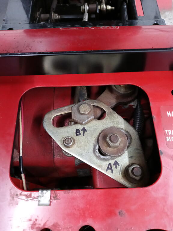

Horse Newbie 7,402 #32 Posted November 26, 2020 (edited) @WVHillbilly520H Take a look at this pic please. I know you said do not use oil on the eccentric nut on top of trans.,I seen some dry lube at the hardware store but I could not find one that said "graphite". It said "will not attract dirt". Do you reckon that would be okay to use ? My motion lever wants to creep back towards neutral so which nut/ bolt do I tighten, A or B ? Edited November 26, 2020 by Horse Newbie Share this post Link to post Share on other sites
lynnmor 8,748 #33 Posted November 26, 2020 A has the friction washers above and below the cam plate and they are to be kept dry. It might be a good idea to disassemble there and file the washers flat.then clean thoroughly. Adjust the nut down till you have drag on the cam plate like it shows in your owners manual. 1 1 Share this post Link to post Share on other sites

Horse Newbie 7,402 #36 Posted November 26, 2020 6 hours ago, lynnmor said: A has the friction washers above and below the cam plate and they are to be kept dry. It might be a good idea to disassemble there and file the washers flat.then clean thoroughly. Adjust the nut down till you have drag on the cam plate like it shows in your owners manual. @lynnmor I will get my manual out and go over that section. When you say kept dry, do you mean kept dry as in no lube of any kind, or just dry lube ? Thanks, Tim Share this post Link to post Share on other sites
lynnmor 8,748 #37 Posted November 26, 2020 3 hours ago, Horse Newbie said: @lynnmor I will get my manual out and go over that section. When you say kept dry, do you mean kept dry as in no lube of any kind, or just dry lube ? You won't find advice about making the washers flat again in the manual.. Kept dry means using absolutely nothing, just clean and assemble. 1 Share this post Link to post Share on other sites
WVHillbilly520H 10,378 #38 Posted November 26, 2020 20 minutes ago, lynnmor said: You won't find advice about making the washers flat again in the manual.. Kept dry means using absolutely nothing, just clean and assemble. That's why I said if you choose to use a lube use only "dry graphite powder" which won't attract foreign objects dust ect... https://www.lowes.com/pd/Hillman-Graphite-Powdered-Lubricant/1244381... 15 hours ago, Horse Newbie said: I could have sworn the Eaton manual said 10w-40...I'll have to check it. Are you saying even if the manual says 10w-40 still use 10w-30 ? My TORO/WH manual states 10w30 and have used 10w30 religiously since bought new for few reasons 1) says so in the manual 2) same oil in the engine and NO need to keep multiple grades of oil on hand so there's no mix ups and 3) 10w30 will be easier on the pump on those cold winter days with a snowplow/blower... Again my experiences and notice I have said before that I haven't had many issues with my 520 over the course of 22 years using 10w30 engine and hydro... I'm not saying its the only way but it certainly seems in my experiences it has been a 4-seasons oil and changed by T/WH manual recommended intervals ... Not knocking anybody else's opinions again my experiences. 1 Share this post Link to post Share on other sites
