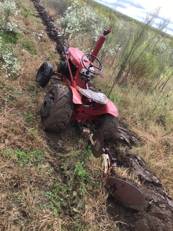

Pullstart 71,367 #4 Posted November 22, 2020 Putt Putt has stacked weights, they sure do make an incredible difference! I even notice when scooting it across the smooth pavement. 2 Share this post Link to post Share on other sites
ecsi635j 34 #5 Posted November 22, 2020 Thank you pullstart, 3 hours ago, pullstart said: Putt Putt has stacked weights, they sure do make an incredible difference! I even notice when scooting it across the smooth pavement. Thank you pullstart, so glad you posted that picture,Looks like they can in fact make a huge difference in traction if Putt Putt can pull that plough like he's doing. I'm hoping it may be possible to stack three per side.although Id'e imagine it would require some pretty long carriage bolts to accomplish that. . Might two weights per side be the maximum ? I don't know.? 1 Share this post Link to post Share on other sites

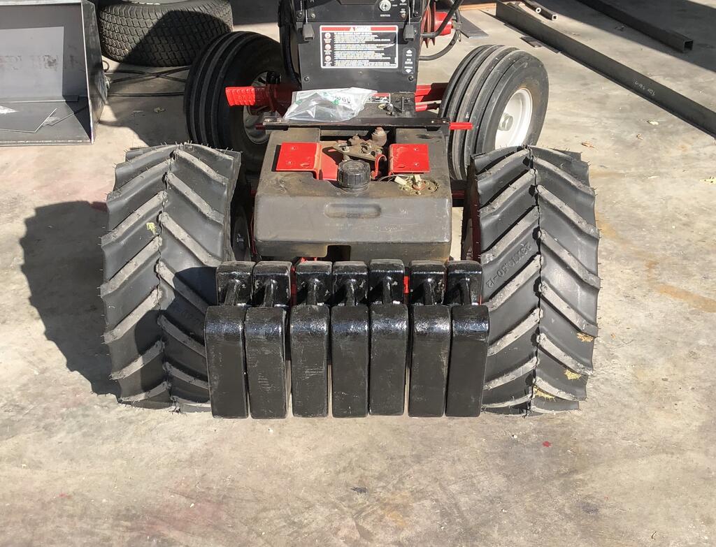

Pullstart 71,367 #6 Posted November 22, 2020 1 hour ago, ecsi635j said: Thank you pullstart, Thank you pullstart, so glad you posted that picture,Looks like they can in fact make a huge difference in traction if Putt Putt can pull that plough like he's doing. I'm hoping it may be possible to stack three per side.although Id'e imagine it would require some pretty long carriage bolts to accomplish that. . Might two weights per side be the maximum ? I don't know.? Not a problem! These ones have two hexes casted into the back of each weight across from each other and through holes perpendicular to those. To stack, you simply add a 5 or 6 inch into the back of the stacked weight then slide it over the previous bolts like wheel studs. Share this post Link to post Share on other sites

ebinmaine 80,960 #10 Posted November 22, 2020 1 hour ago, ecsi635j said: Might two weights per side be the maximum ? I don't know.? I've seen pics of Cubs with 5 or 6 stacked. Share this post Link to post Share on other sites

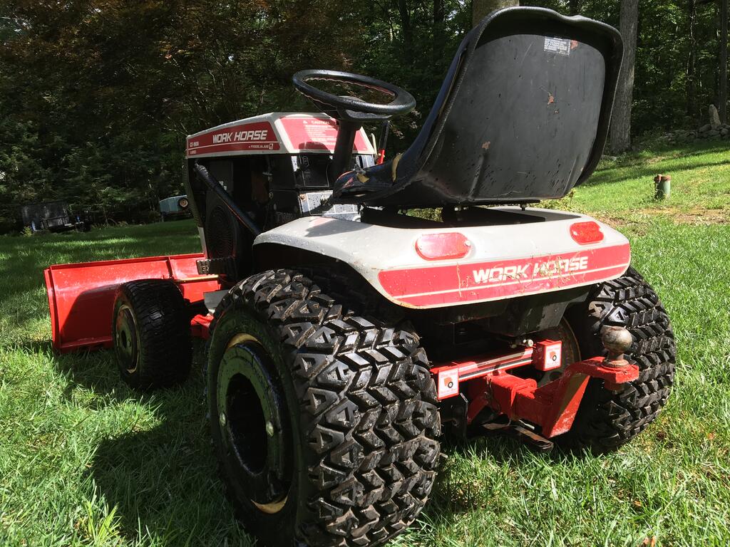

JoeM 10,317 #11 Posted November 22, 2020 14 minutes ago, ebinmaine said: fill your tires If you are wanting nice a nice lawn, caution.... they will leave depressions if the ground is soft. This pic is the morning after mow with frost. I used the worker 522xi with filled ag tires for the last mow. The filled 10.50's weigh in at just over 100 each. 1 Share this post Link to post Share on other sites
ebinmaine 80,960 #12 Posted November 22, 2020 20 minutes ago, JoeM said: If you are wanting nice a nice lawn, caution.... they will leave depressions if the ground is soft. This pic is the morning after mow with frost. I used the worker 522xi with filled ag tires for the last mow. The filled 10.50's weigh in at just over 100 each. Good info there Joe. Thanks. It's important for me to remember that although our land is fine other's may be soft. We mow with an older model push mower. Not a Horse. Share this post Link to post Share on other sites
