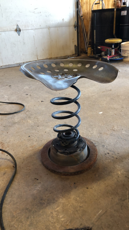

ClassicTractorProfessor 5,455 #1 Posted November 22, 2020 We have one of those rolling mechanics seats at work, but one of the wheels has been broken for a long time and it has a bad habit of dumping me over backwards when I least expect it. Yesterday was an extremely slow day, so boredom took over. I started digging in the junk pile behind the shop, and came up with a coil spring and brake rotor off of an F150, and a hub assembly off a half ton Chevy. Little bit of welding and a reproduction tractor seat and I now have a new chair. Just the right height for doing brake jobs on the ground when we don’t have a lift available, and would probably work great for wrenching on the Horses as well 5 7 1 Share this post Link to post Share on other sites

squonk 46,224 #5 Posted November 22, 2020 I dast you to jump off the bench whilst sitting on that! Those rolly seats (and creepers for that matter) are notorious for the casters loosening and stripping the threads. I went to Harbor Fright () and biought new casters with longer stems. Lock washers, lock nuts and loctite cured that problem for good! 2 Share this post Link to post Share on other sites
