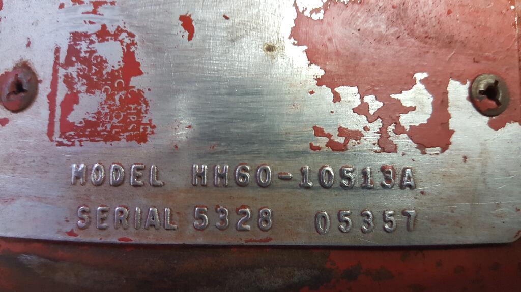

Gregor 4,847 #26 Posted November 23, 2020 I really think this engine is salvageable, and I would like to save it. Trouble is, I'm having trouble locating parts. When it comes to the HH60 are all the short blocks the same? I have never messed with a small engine before. I have talked to a couple of places, and I give them the model number, and they both told me the number is wrong. There should be one more digit. Well, I wish there was, but there simply isn't. The number is HH60-10513A. All the model numbers I find on line have one more digit, this one dos not Also, I have not found anything that ends in "A" Share this post Link to post Share on other sites
ebinmaine 75,367 #27 Posted November 23, 2020 Most modern small engine repair places don't have a lot of knowledge of anything built more than about 20 or 30 years ago. That's nothing for or against them it's just the way the industry is. What are the parts that you're looking for? Share this post Link to post Share on other sites
Gregor 4,847 #28 Posted November 23, 2020 Complete gasket set, rings, valves, maybe a carb. Won't really know for sure until I get into it. I just hate to tear it down and find out I can't get anything. Share this post Link to post Share on other sites
gwest_ca-(File Mod) 11,815 #29 Posted November 24, 2020 Try HH60-105013A original in the model 656 Click on the picture for more https://www.wheelhorseforum.com/search/?q=HH60-105013A&quick=1&type=downloads_file Found a parts list for the B https://www.jackssmallengines.com/jacks-parts-lookup/manufacturer/tecumseh/4-cycle-horizontal/hh-60/hh60-105013b Another B https://www.partstree.com/models/hh60-105013b-tecumseh-engine/ and a C https://www.partstree.com/models/hh60-105013c-tecumseh-engine/ Garry Share this post Link to post Share on other sites
Gregor 4,847 #30 Posted November 24, 2020 Jacks is one of the places that told me my model number is not valid. That's why I was wondering if all HH60 short blocks were the same. Share this post Link to post Share on other sites
Gregor 4,847 #31 Posted November 24, 2020 Even that "B" model number has one more digit than my model number Share this post Link to post Share on other sites

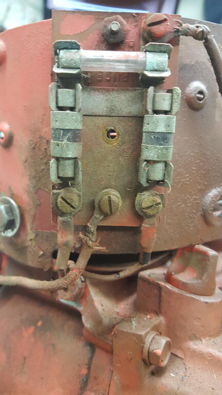

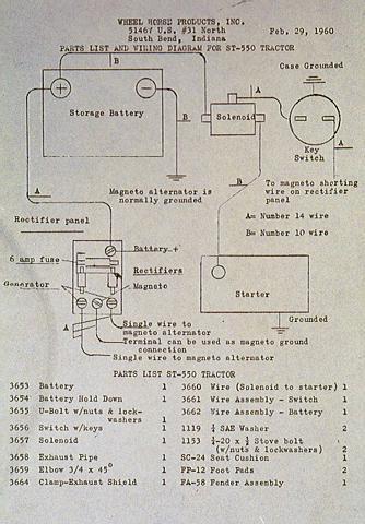

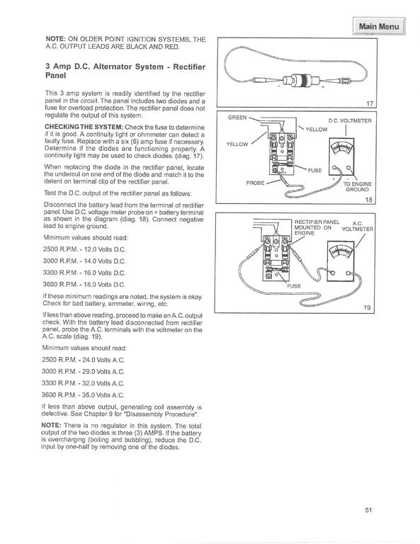

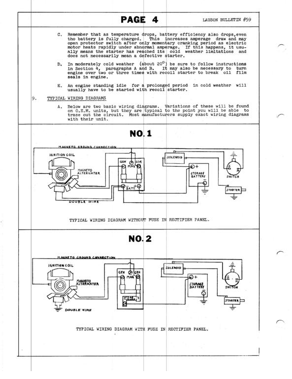

Gregor 4,847 #32 Posted November 25, 2020 Can someone explain this apparatus to me? I assume it is some sort of voltage regulator. I have watched some HH60 videos, and haven't seen anything like it. Nor can I find any reference to it any parts diagram, but then again, I have not been able to find my particular motor listed in any parts diagrams. The wire in the middle on the bottom goes directly to the points. I think it's suppose to be a kill wire, but not sure.The other 2 wires on the bottom go to the generator..As you can see there is a fuse across the top. It has continuity. The wire on the top exits the cover, and goes...I don't know where. It was not connected to anything, but maybe it goes to the battery for charging. On either side of the little card are fuse type cartridges, but they are not fuses. When removed from the card, the one on the left reads 369 ohms, regardless of how you apply the leads. For this reason, I don't believe they are capacitors. I am thinking diodes. The one on the right shows open. I would like to remove the coil and generator assembly for cleaning purposes, but I'm not just sure how I would reset the coil gap. Any help with all this would be greatly appreciated. Footnote: If this is a voltage regulator, could any 12 volt regulator be substituted? Thanks Greg 1 Share this post Link to post Share on other sites
WHNJ701 4,167 #33 Posted November 25, 2020 @formariz can you help this guy out with his question? Share this post Link to post Share on other sites

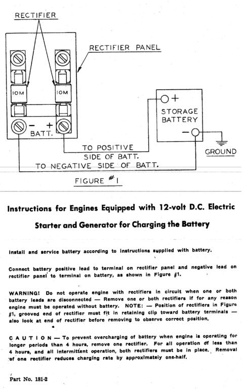

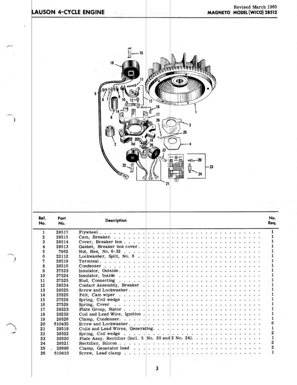

formariz 12,352 #34 Posted November 25, 2020 What you have there is the rectifier panel for a 3 AMP DC Alternator system and yes there is one fuse and two diodes. I suggest that you get familiar with the system and specifically learn what not to do. Those parts are very hard to find. Also before you take magneto out and change anything learn about it. Those engines are extremely finicky as to timing as most familiar with them can tell you. Never put power from switch into that rectifier. Look through the literature provided here . 3 Share this post Link to post Share on other sites
Howie 900 #35 Posted November 25, 2020 If you are going to take that off scribe a line on the mounting lug and the mag unit before removing. This is your timing, coil gap you can do nothing about. If not marked head has to be off to reset timing correctly. I think Tecumseh used to sell a dial indicator with offset tip to do this but probably next to unobtainable now. I think the internals are most likely the same as any other engine close to that type number. Have put some of these together and not even had all the numbers and got my parts. Share this post Link to post Share on other sites
Gregor 4,847 #36 Posted November 25, 2020 Thank You so much. I bookmarked the page and also saved each pic to a folder Share this post Link to post Share on other sites

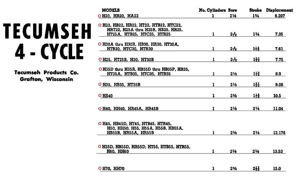

Gregor 4,847 #42 Posted November 26, 2020 Finally, I got a parts list, minus the engine, but it's a parts list. All this time I have been trying to download the wrong file. I'm not great when it comes to computers. I was just coming back to my computer to see if I could find engine specs on an HH60 when I saw your post. My piston and cylinder measure 2.750" Now I guess I have to figure out if it's a 6 hp that's been bored, or if it's a 7 hp. If had had it assembled I guess I could measure stroke, and see what that is. 1/32 might be hard to measure though. May do that tomorrow. Is there another way? I know I ask a lot of questions. Sorry. Share this post Link to post Share on other sites
Gregor 4,847 #43 Posted November 26, 2020 I found this. According to these specs, If I am reading it right, I have a 7hp motor. My piston diameter is 2.750 and the crank journal for the rod bearing is 1.18 Tecumseh Specs Share this post Link to post Share on other sites

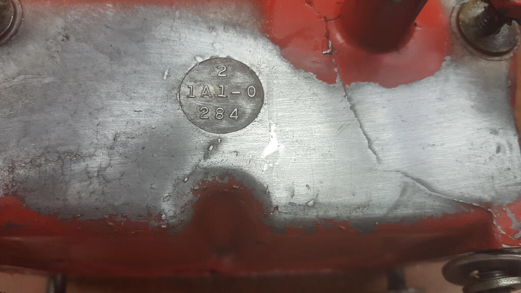

Gregor 4,847 #44 Posted November 26, 2020 After all this, it may mean nothing. I was cleaning up the block and sump cover, and found this. Both are cracked. 3 Share this post Link to post Share on other sites
953 nut 62,790 #46 Posted November 26, 2020 I would be hesitant to put any faith in a block that is cracked like that. 1 Share this post Link to post Share on other sites
Gregor 4,847 #47 Posted November 26, 2020 I have seen where guys have used JB Weld and other compounds to seal up such cracks. I'm not a fan of that at all. The block and cover are available on ebay, and it seems regardless of whether this is a 6 hp, or a 7 hp motor, they are the same. At least that's how I interpret he parts diagrams. I ordered them. If they are wrong when they get here, I will go motor shopping I guess. This was a real let down. This is the first time I have attempted to rebuild a single cylinder 4 cycle. It's been a challenge to say the least. Share this post Link to post Share on other sites

Pullstart 68,416 #50 Posted November 26, 2020 PC7 epoxy is amazing stuff! 805RoadKind on YouTube uses it like crazy while welding numerous Briggs engines together to fill in the gaps. It is fully machinable like steel when hardened. I’d grind that crack to a bevel and fill it if that’s the only option! Share this post Link to post Share on other sites
