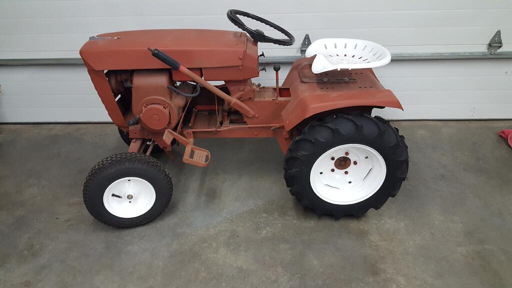

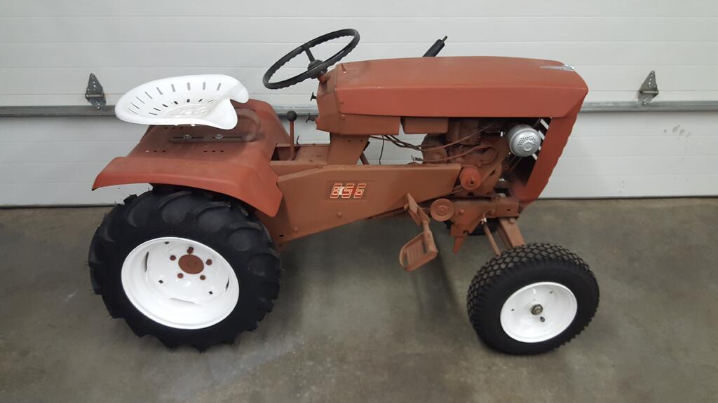

Gregor 4,848 #1 Posted November 20, 2020 I am still waiting on a new fuel pump for my C 141. After it's installed, it will go to storage for the winter. BUT..... Today I went on a road trip and picked up another project for next spring. A 656. It has a 6 hp. Tecumseh on it that is currently stuck. I don't know anymore about it than that. If the motor is beyond saving, this might turn into my "custom fun" tractor. I usually like to restore things back to original, but sometimes that simply isn't practical. I may re-power this with anything I can find, and simply turn the tractor into a LEAN MEAN RUNNING MACHINE. It has no deck, but I did get a Wheel Horse dump cart with it. It seems to be a very simple tractor, and could be a lot of fun. It has new tires and wheels all the way around, and it has been sanded and primed. It will go to storage for now, and I will hunt for parts over the winter. 6 3 Share this post Link to post Share on other sites
953 nut 70,227 #2 Posted November 20, 2020 6 minutes ago, Gregor said: I may re-power this with anything I can find, and simply turn the tractor into a LEAN MEAN RUNNING MACHINE. We love FUN projects! 1 Share this post Link to post Share on other sites
Pollack Pete 2,273 #3 Posted November 20, 2020 VERY nice tractor.Nice wheels and tires.A 656 is what started this Wheel Horse lunacy for me a little over 10 yrs ago.I still have it in one of my sea boxes.Have fun with your new toy. Share this post Link to post Share on other sites
cschannuth 3,821 #4 Posted November 20, 2020 I bid on that a couple times but it was a little trip so I didn’t get too serious. Glad someone on here got it. That would make a great repowered fun tractor. 1 Share this post Link to post Share on other sites
Gregor 4,848 #5 Posted November 20, 2020 7 hour round trip for me, but I have nothing else to do. 1 1 5 Share this post Link to post Share on other sites

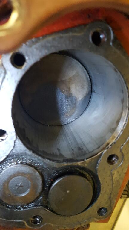

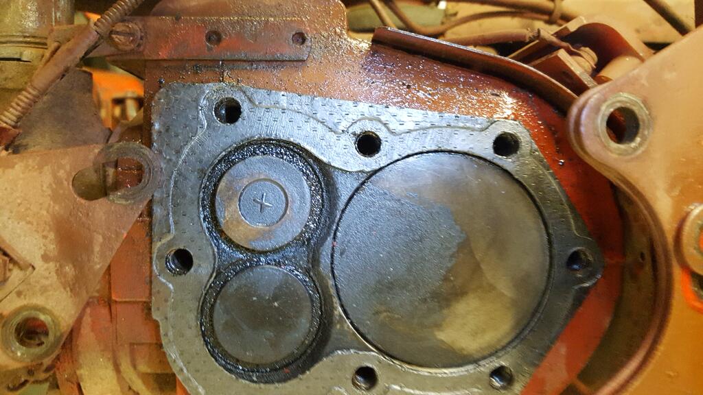

Gregor 4,848 #6 Posted November 21, 2020 Curiosity got the better of me. It always does. I put my 20" pipe wrench on the PTO pulley, and it turns out this motor is not near as stuck as one might think. I pulled the head. Piston moved up and down freely, but the valves simply stayed open. I put my drill on the flywheel nut, and spun it over. A little PB Blaster in the valves, a little coaxing, and now they too move up and down freely. This motor might be saved. I have never tore into a single cylinder 4 stroke in my life. (rebuilt a couple of small block chevys about 100 years ago) How much tougher can this be? Some carbon build up, some slight scratching in the cylinder walls, I believe will hone out. It just might go again. 1 3 Share this post Link to post Share on other sites
Gregor 4,848 #7 Posted November 21, 2020 I forgot to add. According to my spark tester, it even has spark. 4 Share this post Link to post Share on other sites
WheelhorseBob 1,550 #8 Posted November 21, 2020 I restored a 1956 Economy that spun over with zero compression. Stuck exhaust valve. Freed it up with penetrating oil and put a rod, piston and rings in it. Runs perfect! Good luck, looks like a fine specimen! 1 Share this post Link to post Share on other sites
ebinmaine 81,082 #9 Posted November 21, 2020 28 minutes ago, Gregor said: (rebuilt a couple of small block chevys about 100 years ago) How much tougher can this be? Roughly 1/8 the difficulty. 27 minutes ago, Gregor said: , it even has spark. That's a primary concern with the small techies. If the carb isn't happy you can graft a Kohler carb on. @pullstart has had success with it. 3 1 Share this post Link to post Share on other sites
WHNJ701 4,173 #10 Posted November 21, 2020 1 hour ago, WheelhorseBob said: I restored a 1956 Economy that spun over with zero compression. Stuck exhaust valve. Freed it up with penetrating oil and put a rod, piston and rings in it. Runs perfect! Good luck, looks like a fine specimen! My one 854 had a stuck exhaust valve when I got it, I freed it up with pb and never touched the engine since. Great running kohler 1 Share this post Link to post Share on other sites
oliver2-44 11,808 #11 Posted November 21, 2020 (edited) Before you pull it down to hone and rings, try getting it running as is. While you have the head off, soak the top of the piston with carb cleaner, let set, soak again, wiggle the engine pulley just enough to wiggle the rings in their grooves, soak again and repeat. The idea is to free up the rings a little from years of varnish etc. Before you rotate engine enough to move the piston and distance, wipe some oil on the cylinder walls since the carb clearer will have washed it off. For just a trial run you can get by reusing the head gasket. I don't know if this really helps (but it can't hurt) sometimes for just a trial run I will do what and old farmer showed me. He would clean the head gasket, then soak it in water a few hours then freeze it. Let it thaw and reuse it. His theory was it would soak a little water inside and freezing it would expand the two layers so they had some "crush" back in them. But I would be sure and replace it if it runs and your going to keep running it. Edited November 21, 2020 by oliver2-44 4 3 2 Share this post Link to post Share on other sites

953 nut 70,227 #13 Posted November 21, 2020 6 hours ago, oliver2-44 said: soak the top of the piston with carb cleaner, let set, soak again, wiggle the engine pulley just enough to wiggle the rings in their grooves, soak again and repeat. The idea is to free up the rings a little from years of varnish etc. I have done the same with MMO, works great. 2 Share this post Link to post Share on other sites
Gregor 4,848 #14 Posted November 21, 2020 My dad was an airplane mechanic in the war. He thought MMO was worth it's weght in gold. I have it soaking now with a mixture of MMO and acetone. 3 1 Share this post Link to post Share on other sites
