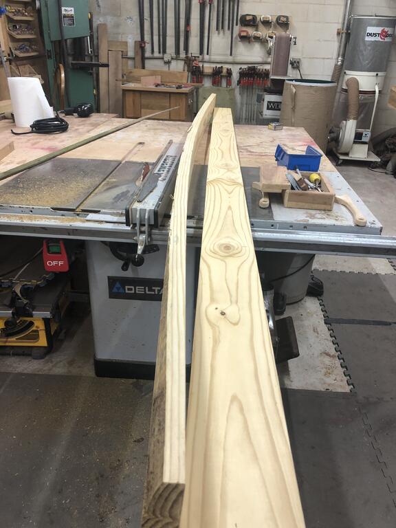

The Tuul Crib 7,354 #1 Posted November 13, 2020 Been having issues with the local lumberyard on this back porch build. The first batch and order they sent out had three or four bad boards it took a month and a half to get them to bring me out replacements. Now only a week later after they brought me the replacements this is what happened to one of them! They were perfect when they delivered them! Sad 5 Share this post Link to post Share on other sites
Stormin 9,987 #2 Posted November 13, 2020 That supposed to be a seasoned board? Share this post Link to post Share on other sites
The Tuul Crib 7,354 #3 Posted November 13, 2020 Yeah at a premium price as well in one weeks time this is what happened! They didn't send it through the dryer long enough! Share this post Link to post Share on other sites
Kenneth R Cluley 661 #5 Posted November 14, 2020 I replaced a 4 x 4 pressure treated porch post and came back about a week later, it had turned almost 90degrees! Needless to say it definitely came from the pictured tree. Share this post Link to post Share on other sites
Achto 31,652 #6 Posted November 14, 2020 I see this quite often with treated wood in my area. Treated lumber is insanely expensive right now also, that is if you can get it. On a lighter note: That board should be perfectly suitable for a Dr. Suess building. 1 1 Share this post Link to post Share on other sites
Pullstart 69,862 #7 Posted November 14, 2020 Just give it about 34 relief cuts, it’ll flatten right out! Or, being that it is hunting season, just string it and shoot you a deer! 1 Share this post Link to post Share on other sites
formariz 12,359 #8 Posted November 14, 2020 In a Sunny day wet really well a big area of lawn and place board concave side down on it . Keep an eye on it for a few hours. When it is straight pick it up. It should stay relatively straight. The twist you will have to live with if you can. Share this post Link to post Share on other sites
JAinVA 4,638 #9 Posted November 14, 2020 (edited) Just look at the growth rings.That is some shitt# looking wood.That log should have been turned into landscape timbers.I saw my own lumber for non coded use and would burn a tree that had rings that coarse. Edited November 14, 2020 by JAinVA 1 Share this post Link to post Share on other sites
