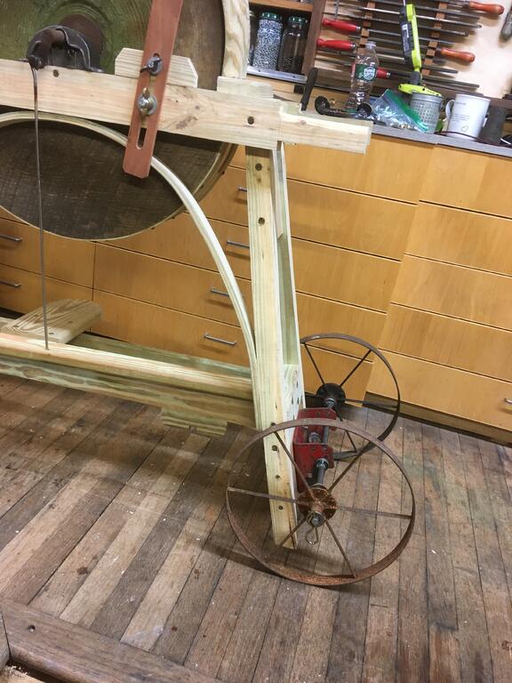

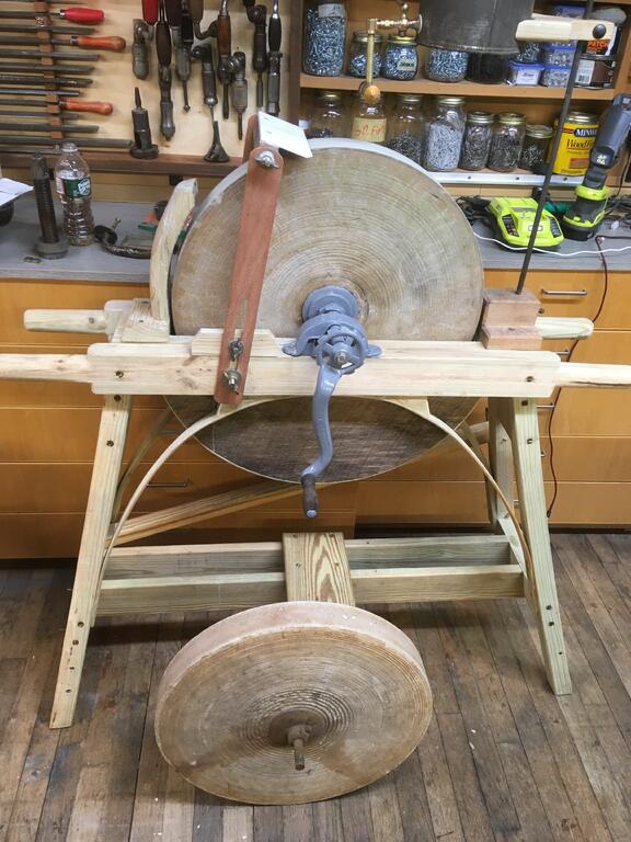

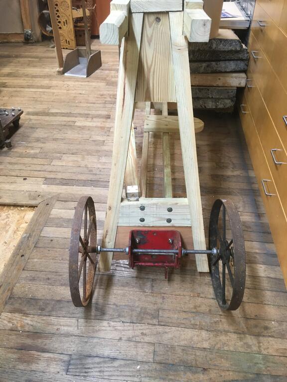

formariz 12,381 #54 Posted November 24, 2020 So the idea here is to use what I have in stock. Since there will be a tractor seat on it anyway why not another tractor part. When not moving it I can just remove wheels. 2 3 Share this post Link to post Share on other sites
tom2p 2,396 #55 Posted November 24, 2020 great idea ! Share this post Link to post Share on other sites
DennisThornton 4,773 #56 Posted November 24, 2020 I took a quick look at the first picture and I was trying to figure out what tractor part? Remove the wheels? What's he mean? Then I saw the second picture! Was that planned all along? Or did you just now work that in to make it more appropriate for this forum! Share this post Link to post Share on other sites
formariz 12,381 #57 Posted November 24, 2020 2 minutes ago, DennisThornton said: Was that planned all along? Or did you just now work that in to make it more appropriate for this forum! Of course not! No planning just improvisation as I go along .I just wanted wheels removable and able to be reinstalled relatively easily without having a large contraption to achieve it. Unit is heavy so i have to use both hands to lift it enough to put wheels in and out . This way I can just push axle right into position with my foot while lifting. Perfect position and location for that. Just happened to have an extra atachmatic . 3 Share this post Link to post Share on other sites
tom2p 2,396 #58 Posted November 25, 2020 21 hours ago, formariz said: Of course not! No planning just improvisation as I go along .I just wanted wheels removable and able to be reinstalled relatively easily without having a large contraption to achieve it. Unit is heavy so i have to use both hands to lift it enough to put wheels in and out . This way I can just push axle right into position with my foot while lifting. Perfect position and location for that. Just happened to have an extra atachmatic . I think it was planned you strung us along - and then boom ! got us ! or - you were checking to see if we were paying attention ! lol 1 Share this post Link to post Share on other sites

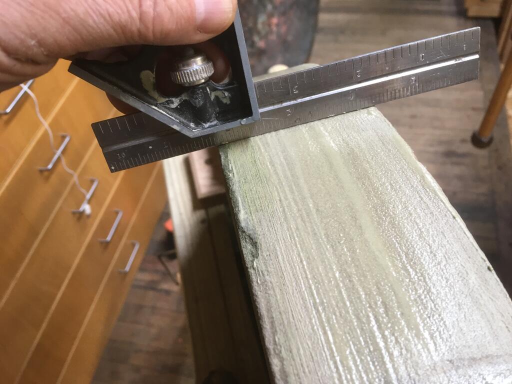

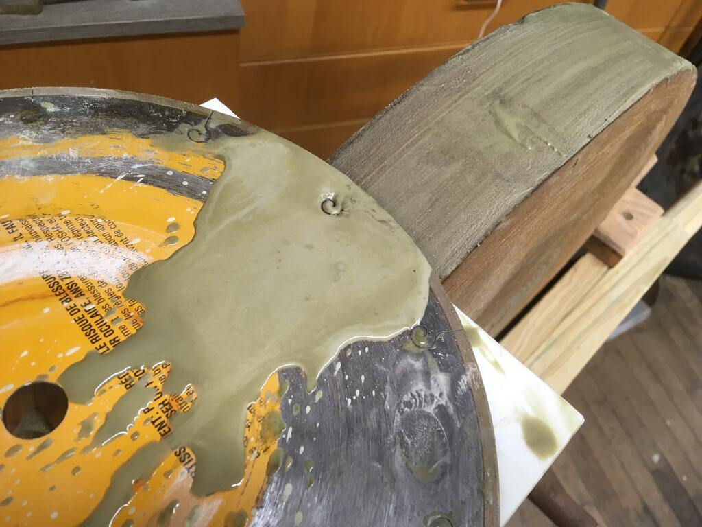

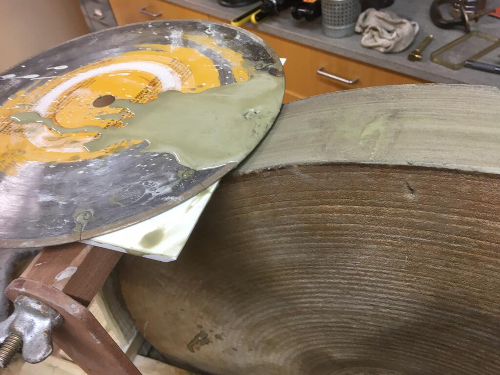

formariz 12,381 #59 Posted November 25, 2020 (edited) So it is all finally done. Now it’s the tuning part. Cleaning and flattening (dressing)stone’s business end. For it I always use an old diamond coated masonry blade. It cuts stone real fast and it’s easy to control progress. Stone was already not too bad so about after one hour sitting at it it’s perfectly flat and round. Not all stones I have come across cut well but this one cuts really aggressively. Slurry created by dressing it will already stay on it permanently. When it gets wet again it will speed grinding process already. Edited November 25, 2020 by formariz 2 1 Share this post Link to post Share on other sites

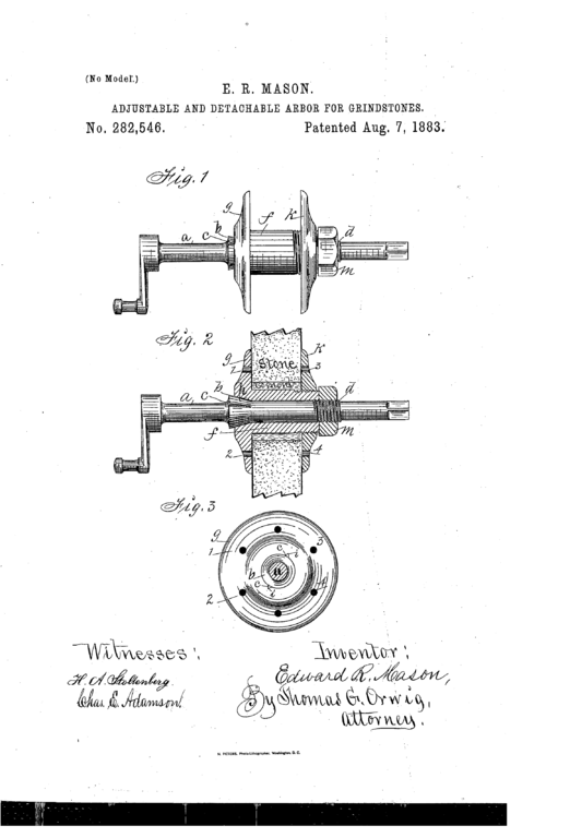

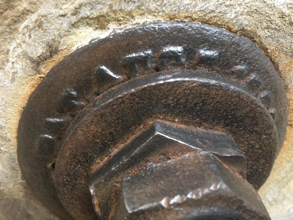

formariz 12,381 #60 Posted November 25, 2020 A little surprise while cleaning some of the metal on wheel. Patent date on big “washer” August 7 18??. I think patent may be for the actual wheel“axle”? Got to do a little research. Don’t want to actually remove it from wheel since it may create problems due to how long it has been there. Share this post Link to post Share on other sites
formariz 12,381 #61 Posted November 25, 2020 (edited) Found it. Its August 7,1883. @oliver2-44 I believe that this puts some light on your earlier question. Although I cannot ascertain for sure yet, but most likely all of these grindstones have a square hole. As per the patent on this device this allows one to mount shaft into the square hole of wheel and adjust it prior to truing wheels edge. I can see through a couple of the holes on this device on my wheel and I can see that there is a big void in there justifying a square hole. US282546.pdf Edited November 25, 2020 by formariz 1 1 Share this post Link to post Share on other sites

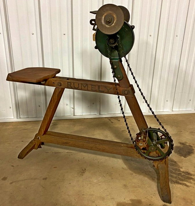

DennisThornton 4,773 #63 Posted November 29, 2020 (edited) Found this online today. Not treadle but peddle, not large but still neat! Lots of old bikes around! Edited November 29, 2020 by DennisThornton added "online" 1 1 Share this post Link to post Share on other sites

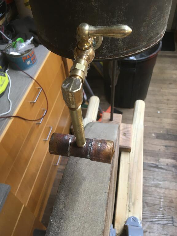

formariz 12,381 #65 Posted December 1, 2020 Gave it a good try out today. Made an improvement on the water distribution on wheel. Wheel cuts really nice and fast. I think I am also going to fit a removable motor on it for the long grinding sessions. 3 Share this post Link to post Share on other sites

formariz 12,381 #67 Posted December 5, 2020 She was just too lonely. Got a “little” sister. 2 1 Share this post Link to post Share on other sites
DennisThornton 4,773 #68 Posted December 6, 2020 On 12/1/2020 at 4:39 PM, formariz said: Gave it a good try out today. Made an improvement on the water distribution on wheel. Wheel cuts really nice and fast. I think I am also going to fit a removable motor on it for the long grinding sessions. Nice to have that wide of a stone! And what a wonderful hollow grind! Be easy to finish and touch up! Share this post Link to post Share on other sites
SylvanLakeWH 32,563 #69 Posted December 6, 2020 1 hour ago, formariz said: She was just too lonely. Got a “little” sister. Same plan? Share this post Link to post Share on other sites

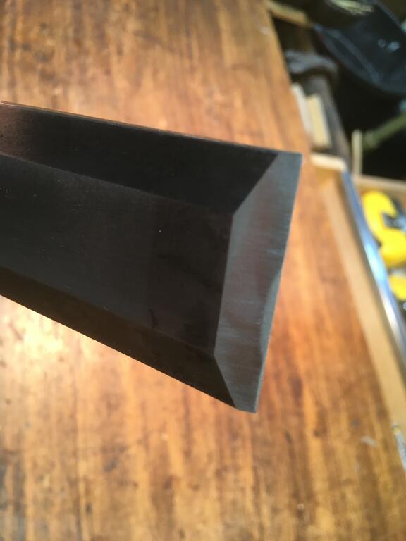

formariz 12,381 #70 Posted December 6, 2020 (edited) 1 hour ago, DennisThornton said: Nice to have that wide of a stone! And what a wonderful hollow grind! Be easy to finish and touch up! With a regular bench grinder having a six inch stone or even up to a 10" stone such as I have on my bench wet grinder, hollow grind produced is in fact "too hollow". The edge from those wheels is generally too fragile. The harder the tool the worse it is. Edge just does not have enough support behind it to withstand heavy use. On my mortise chisels I actually don't use a hollow ground edge. Edge would just crumble quickly from the heavy pounding. This size stone is actually the best compromise for that problem. It is still hollow ground but it is minimal due to the large circumference of wheel. It leaves an edge with enough support behind it, and still have a minimal hollow just enough to make honing easier and quick. Edited December 6, 2020 by formariz Share this post Link to post Share on other sites
formariz 12,381 #71 Posted December 6, 2020 1 hour ago, SylvanLakeWH said: Same plan? This one actually came with a metal stand that one mounts like a bicycle. Stand is in rough shape and it is missing a couple of parts such as one of pedals and the seat. Idea on it is just to refurbish stand ,getting the missing parts and just leave it original. I have no need for it but it was so close and at $50.00 I could not pass it up. Surprisingly there are quite a few nice ones close to me but none of them at that price or even close to it. I have offered it to someone that may be looking for one so it will be here if they so wish. Soon it will be fully usable. It will be here in the museum of how things used to be in the old days fully appreciated every day. 1 Share this post Link to post Share on other sites
DennisThornton 4,773 #72 Posted December 6, 2020 2 hours ago, formariz said: With a regular bench grinder having a six inch stone or even up to a 10" stone such as I have on my bench wet grinder, hollow grind produced is in fact "too hollow". The edge from those wheels is generally too fragile. The harder the tool the worse it is. Edge just does not have enough support behind it to withstand heavy use. On my mortise chisels I actually don't use a hollow ground edge. Edge would just crumble quickly from the heavy pounding. This size stone is actually the best compromise for that problem. It is still hollow ground but it is minimal due to the large circumference of wheel. It leaves an edge with enough support behind it, and still have a minimal hollow just enough to make honing easier and quick. I understand! Especially with mortise chisels. Share this post Link to post Share on other sites

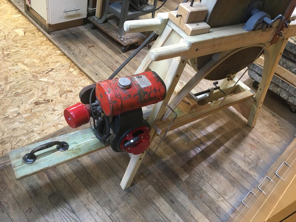

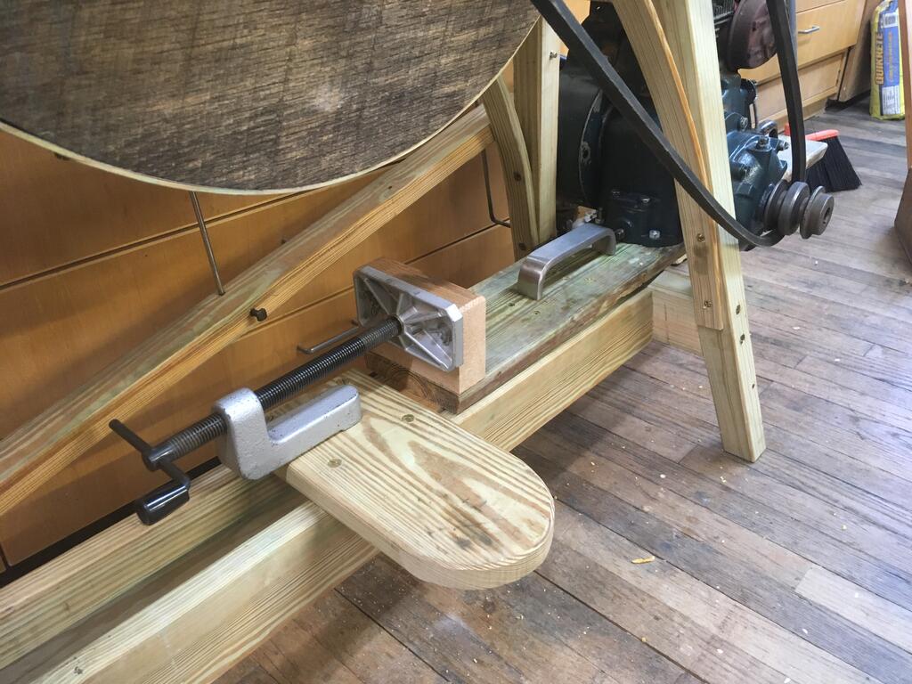

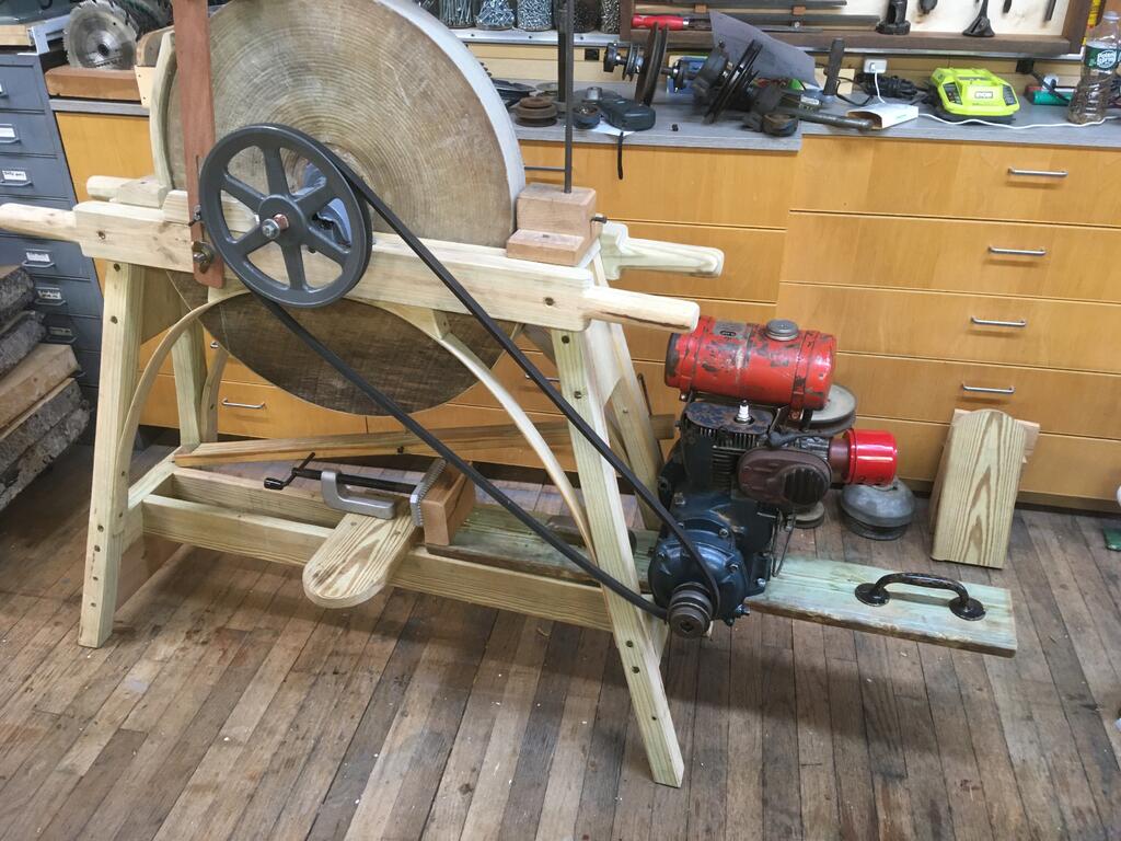

formariz 12,381 #74 Posted December 13, 2020 (edited) So here is the gasoline version of the grindstone. Motor is easily removed and replaced. Belt tension is fully adjustable to allow motor to be started and then tensioned just enough to turn wheel without putting undue strain on wheel bearings. Although not physically attached to stand motor is fully secure in it and fully adjustable. Need to just take it outside to start it and give it a trial run. Vibration from motor is my only concern but if it is an issue I already thought of a couple of solutions or it. Most likely will have to also move wheels to the motor side for transportation. Unit will have a permanent place outside so the gasoline version may be the one to stay with. Motor works really nicely just needed a few parts from the vast stock here such as a tank, recoil start, carburetor and air filter. Edited December 13, 2020 by formariz 1 3 Share this post Link to post Share on other sites
DennisThornton 4,773 #75 Posted December 13, 2020 Pretty fancy tensioner! Drops into a bench dog hole? Can't remember seeing one but I really like it! Share this post Link to post Share on other sites
