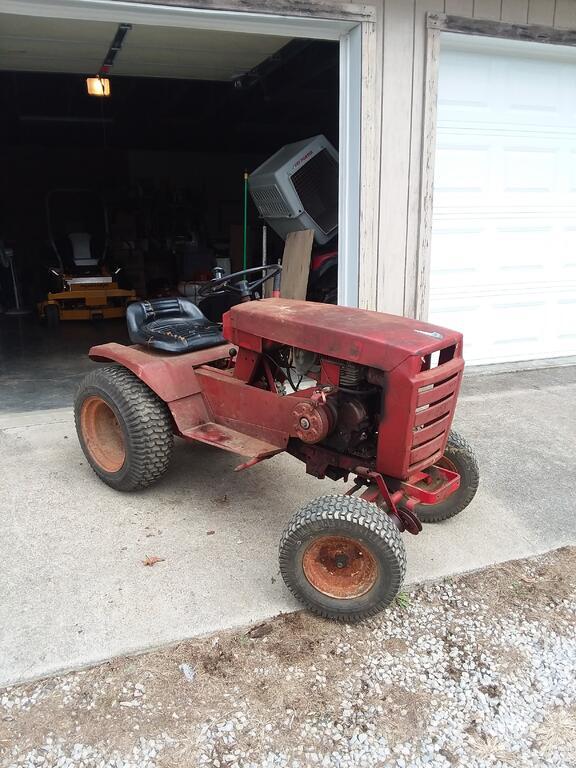

@ebinmaine here’s TJ’s tractor, from another post...

Best thing I could tell you would me to put the donor tractor side by each with that one and take some measurements.
Looks like the sheet metal and steps and everything like that are all very familiar and maybe identical.

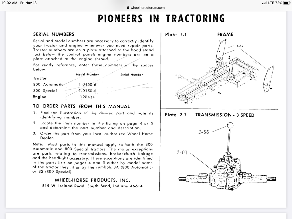

It appears these use completely different frames, as well as transmission mounting points.
We need to keep in mind, there is nothing wrong with TJ’s tractor, just that he is looking for a hitch.

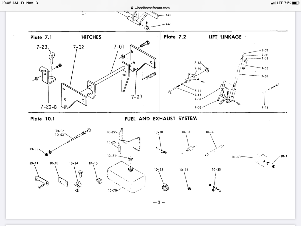

In the Illustrated parts list, it shows these two hitches.  I imagine one is the front attachamatic, the other bolts to the back of the transmission.
TJ, the hitch 7-20-B appears to be a bent piece of metal.  I large section of angle iron just might do the trick if you have access to any.  Drill a couple holes as needed and you have yourself a hitch.
