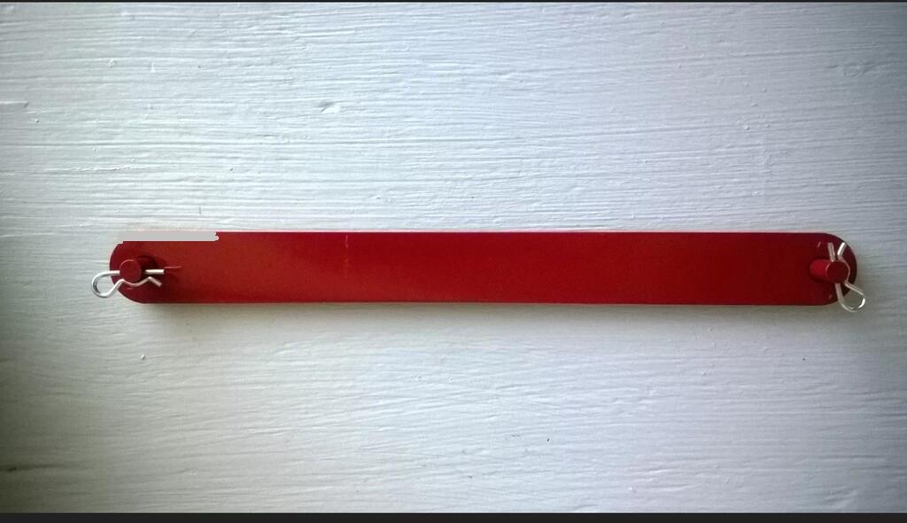

skippy1969 135 #1 Posted November 10, 2020 Hi guys. I have a question about installing the down pressure link on my 520H. I bought a new link from Wheelhorsepartsandmore on EBay. I asked him specifically if his link would work on my 1995 520H and I was told yes. So yesterday I went to install the link on my tractor and I’ll be darned I can’t seem to get it to work. When I put it in the end hole on the rock shaft it hits the steering gear and when I put it in the hole next to it then it binds up on the mower lift trunnion. I don’t know what I’m doing wrong. I searched around on this site and Googled it but really haven’t found any solid information 520H specific. Everything seems to be for the older tractors. The rock shaft on the 520H looks different. I included a photo of the link I bought. Any help would be appreciated very much! Thanks! 1 Share this post Link to post Share on other sites

Achto 31,869 #10 Posted November 12, 2020 (edited) I crawled under my 520 tonight. I did come up with a solution if you wish to use the end hole on the rock shaft. If you would grind about a 1/4" off from the edge of the lift bar it would then clear the fan gear. To use the next hole up it would be easiest to remove the trunnion for the deck. Edited November 12, 2020 by Achto 1 Share this post Link to post Share on other sites
skippy1969 135 #11 Posted November 12, 2020 52 minutes ago, Achto said: I crawled under my 520 tonight. I did come up with a solution if you wish to use the end hole on the rock shaft. If you would grind about a 1/4" off from the edge of the lift bar it would then clear the fan gear. To use the next hole up it would be easiest to remove the trunnion for the deck. That’s what I was thinking too. I wish I could just remove the mower deck trunnion, but I can’t figure out how to remove it. On my 520 It’s not like a regular trunnion where you can just remove a pin and slide it out. Mine goes though a long arm and a short arm. When you pull the pin on the end to remove it, you can’t just slice the trunnion out of a hole. I’ll try and get a picture so you can see it. Maybe I’m just dumb,lol! Thanks Dan. Share this post Link to post Share on other sites
