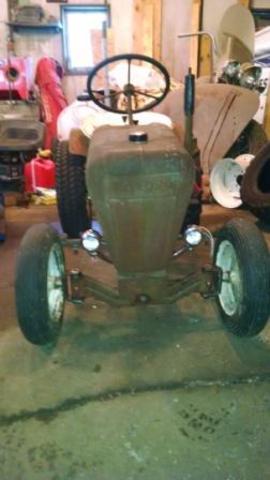

Achto 30,992 #7 Posted November 9, 2020 I made different spindles for one of my customs. 4 Share this post Link to post Share on other sites
953 nut 64,108 #8 Posted November 9, 2020 I was looking for a picture of his spindles while Dan posted this. 3 1 Share this post Link to post Share on other sites

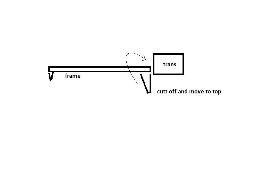

wallfish 19,285 #11 Posted November 9, 2020 A 702 has an axle like a suburban but used upside down to a suburban so flipping it over, so the arms angle up will drop the front. IMO better than flipping the frame is to bolt the frame to the trans using the original top holes in the frame to bolt into the lower holes in the trans. Cut the piece off which would now hang below the trans and weld it on the top of the frame to bolt into the top 2 holes in the trans. Or make a completely new support for the top rear to bolt to the trans. Dan's @Achto way of doing drop spindles is the best way if you still need or want lower 4 2 Share this post Link to post Share on other sites
