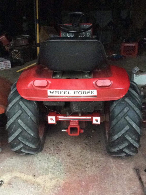

Lee1977 7,809 #6 Posted November 4, 2020 Beside Lowell's at Wheel Horse Parts And More you could build your own. Here's mine haven't got the braces down to the original hitch but will add some before it's finished. 2 Share this post Link to post Share on other sites
