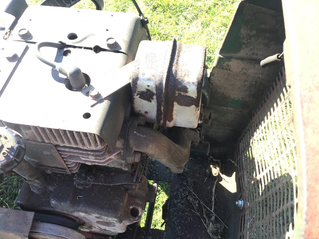

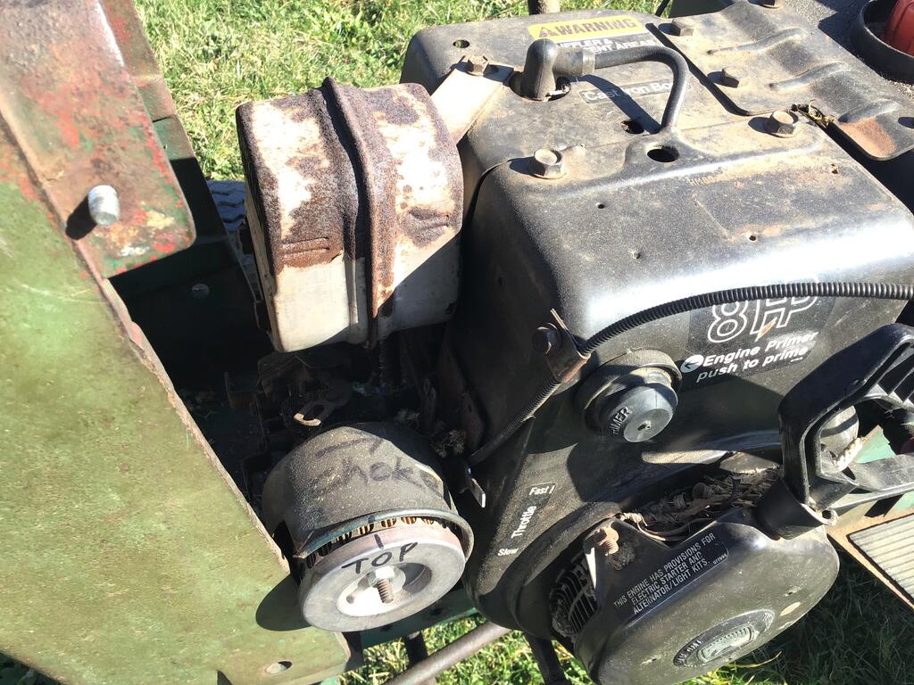

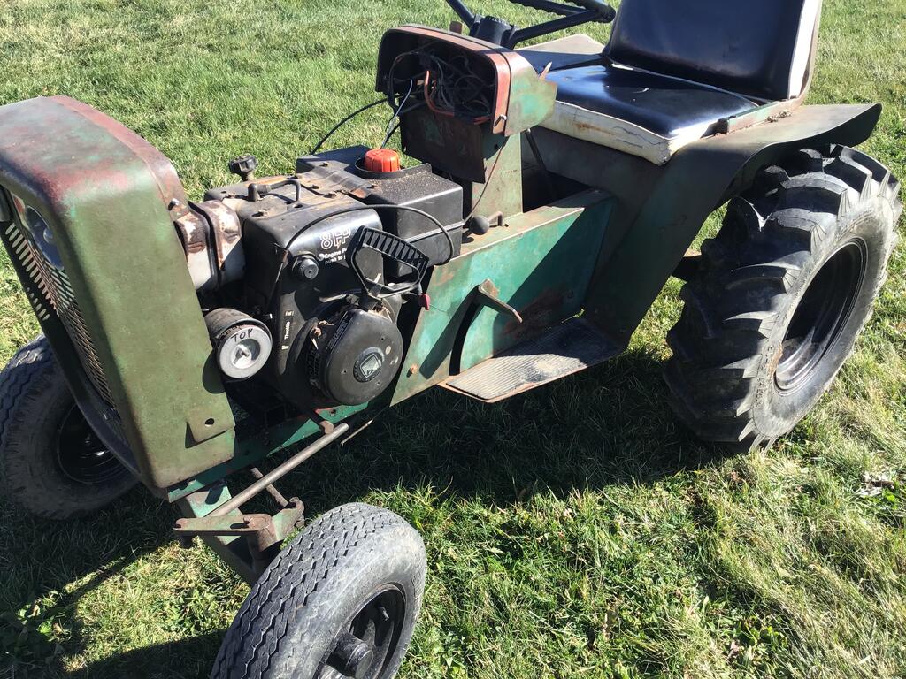

Joe Skeeterbomb 18 #1 Posted November 4, 2020 I have a 552 that has had an engine swap at some point. The Tecumseh engine used needs a carb but there’s no markings on it to Figure which one. what Kohler models would fit? Did Kohler have an engine with electric start? Share this post Link to post Share on other sites

pfrederi 21,145 #5 Posted November 4, 2020 Interesting engine on there now. Any ID?? The exhaust and intake are reversed from any Techy I have... Share this post Link to post Share on other sites
Joe Skeeterbomb 18 #6 Posted November 4, 2020 12 minutes ago, pfrederi said: Interesting engine on there now. Any ID?? The exhaust and intake are reversed from any Techy I have... No ID...none that I have found. Was told it was original and felt bad for the guy...bought it without questioning the motor. 2 Share this post Link to post Share on other sites
Pullstart 71,211 #7 Posted November 4, 2020 1 hour ago, Joe Skeeterbomb said: I have a 552 that has had an engine swap at some point. The Tecumseh engine used needs a carb but there’s no markings on it to Figure which one. what Kohler models would fit? Did Kohler have an engine with electric start? That intake and exhaust configuration looks like the Tecky snowblower engine on “Joe” the 1054! 3 Share this post Link to post Share on other sites

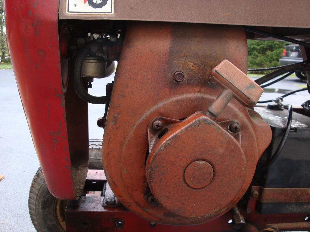

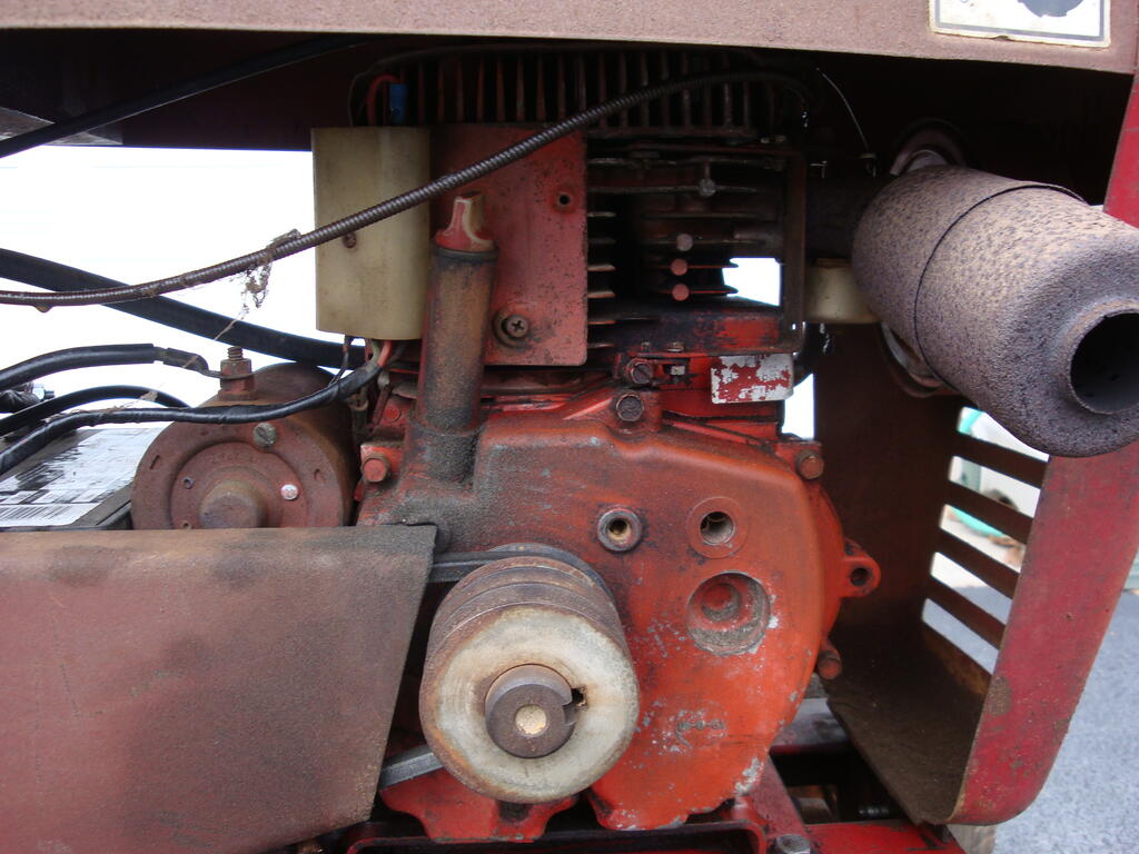

wallfish 20,576 #8 Posted November 4, 2020 1 hour ago, Joe Skeeterbomb said: Was it available in an electric start ? An older syle Kohler with a starter/generator is a better fit for those old tractors. You can use a newer style gear starter engine but the starter blocks the battery tray. Share this post Link to post Share on other sites

oliver2-44 11,734 #10 Posted November 5, 2020 8 hours ago, Joe Skeeterbomb said: @Joe Skeeterbomb Check the engine tin shown in this picture. Some had model number and other information stamped in the top or side of them. It could be almost covered with that 2nd layer of red paint over the white paint. 1 Share this post Link to post Share on other sites
Zeek 2,299 #11 Posted November 6, 2020 (edited) That is not the original Tecumseh for that tractor that I'm aware of. I have a 552 that looks like this unless I'm mistaken. It should have a tag between the crankcase and cooling fins that is stamped with HT55C like mine. Edited November 6, 2020 by Zeek 1 Share this post Link to post Share on other sites
