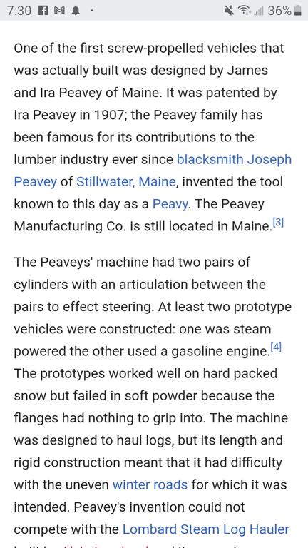

Under further investigation there seems to be 2 or 3 configurations of the screw drives. Maybe differant amounts of blades and differant amounts of twists. I also found this snippet

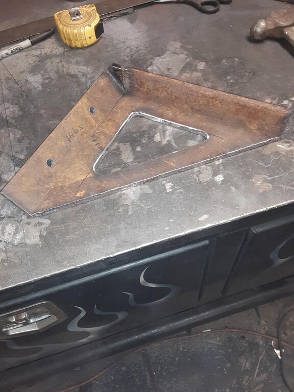

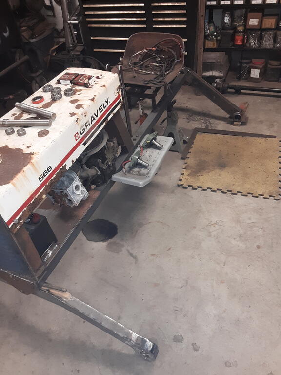

Getting back on track. Making a bit of progress today. Starting on the back screw drive supports
Oldskool
And 1 of 2 supports for the back screw drive support
DennisThornton
That somewhat addresses what I was going to enter:
I watched a similar but not as long video many years ago and I've seen adds from long ago.  But why did they just disappear?  Seems like an awesome idea but something must have been wrong?  Besides some safety issues that could be addressed.  I've seen snow falls that covered all but the windshield up on my truck!  Maybe there will be a kit available soon for my WHs!

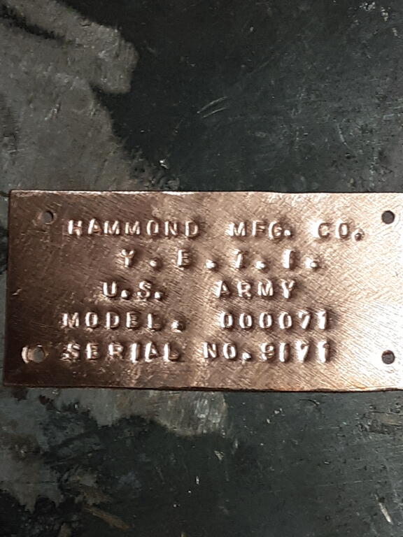

      Can anyone ID this?
