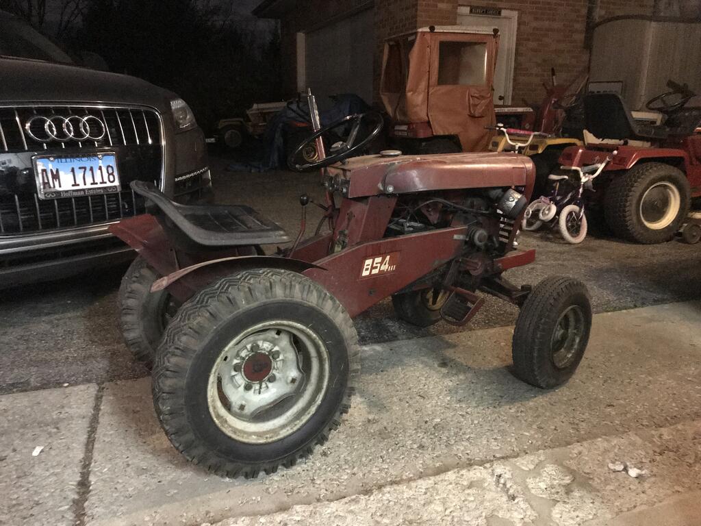

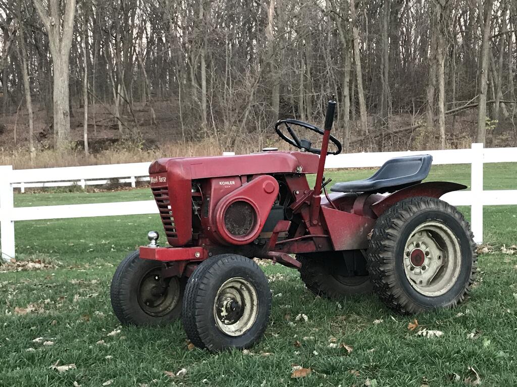

Howsahemi 7 #11 Posted November 10, 2020 I actually bought the tractor. Unbeknownst to me at the beginning, but it was a good friend of mines dad who was selling the tractor. I fixed the trans last night thanks to some posts on here. Got it running. The stupid gas tank is leaking tho. Hate those things. 😡 3 Share this post Link to post Share on other sites

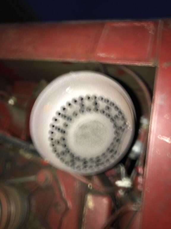

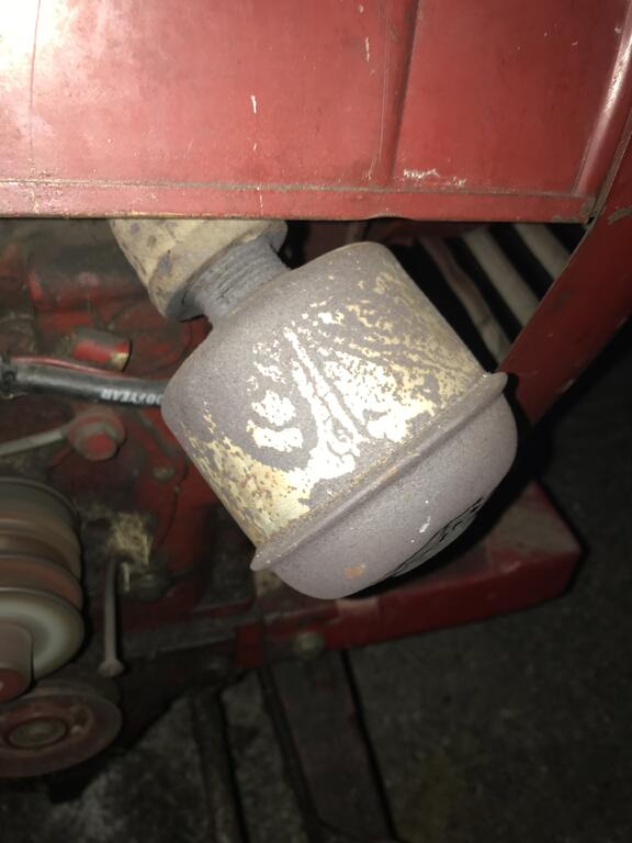

AMC RULES 37,259 #12 Posted November 10, 2020 Easy enough to fix once you have it out of the tractor. Can we see a close up pict of that muffler please? Share this post Link to post Share on other sites
71_Bronco 1,072 #13 Posted November 10, 2020 Looks like a solid little tractor. You're in the right place if you need any help. Share this post Link to post Share on other sites

AMC RULES 37,259 #17 Posted November 10, 2020 Yep, thought it looked special, front face is definitely a shower cap. Have never seen one of them before! @Lane Ranger 1 Share this post Link to post Share on other sites

Lane Ranger 12,092 #19 Posted November 11, 2020 1 hour ago, AMC RULES said: Yep, thought it looked special, front face is definitely a shower cap. Have never seen one of them before! @Lane Ranger maybe someone put a showerhead front on a pepper pot back??? Maybe! Share this post Link to post Share on other sites
WHNJ701 4,173 #20 Posted November 11, 2020 (edited) Found 2 of those mufflers online for under 30 bucks, They look exactly same as the photo. Edited November 11, 2020 by jabelman Share this post Link to post Share on other sites
