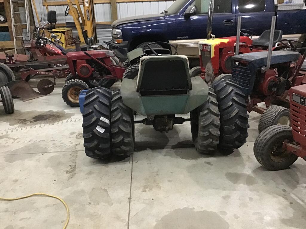

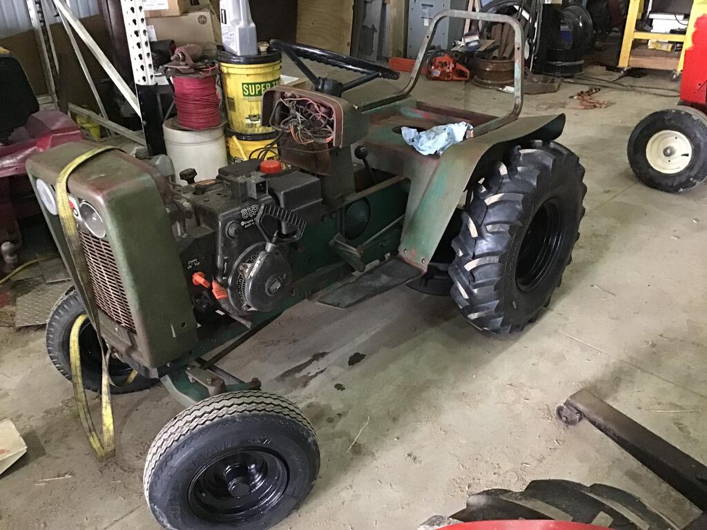

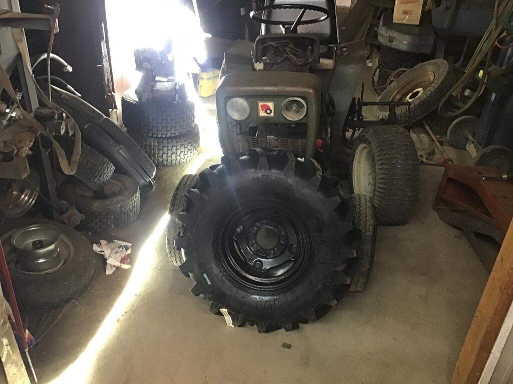

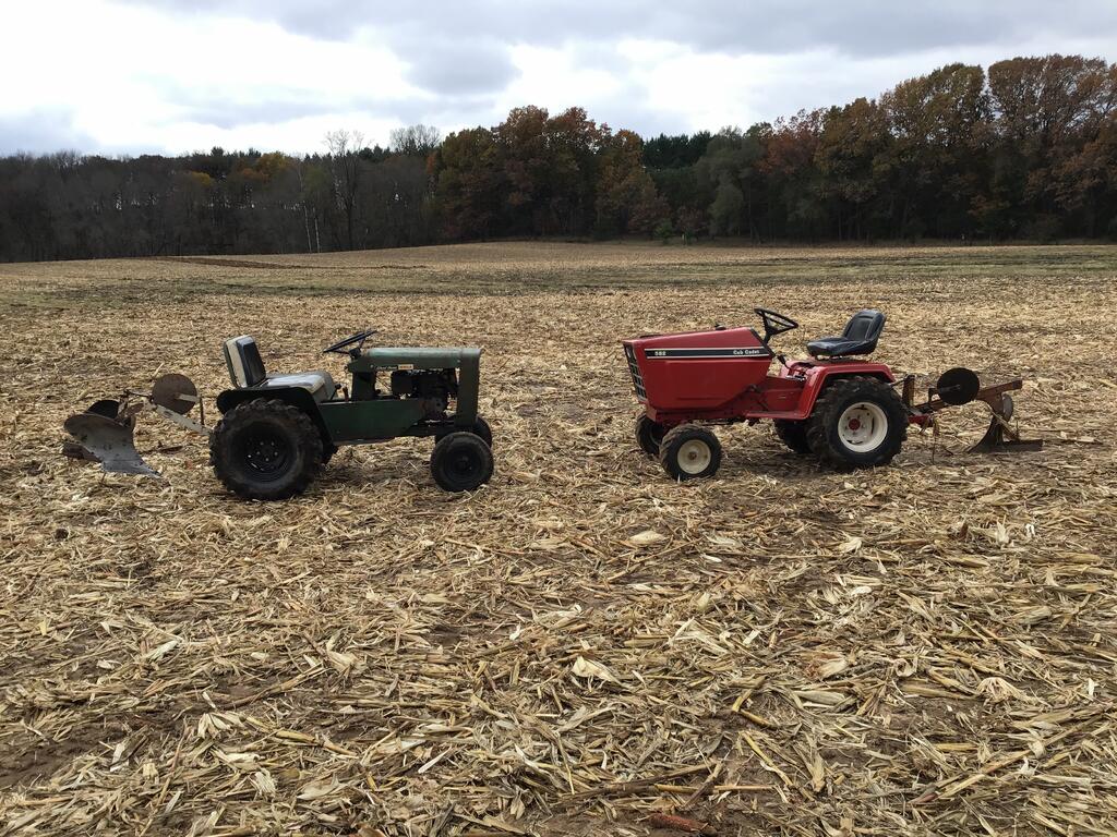

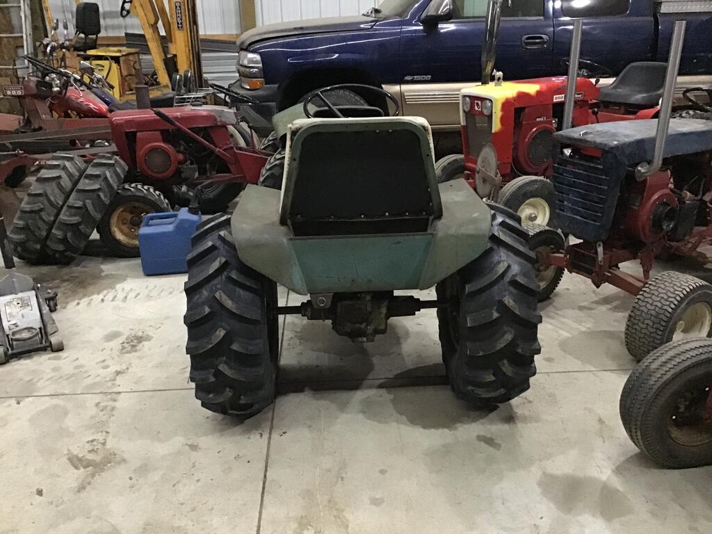

Pullstart 70,705 #1 Posted October 28, 2020 So, @PeacemakerJack and I took a chance on these 27x7.50-12’s last weekend and they performed like monsters! I just ordered another set of them, but in the 10” wide fashion. I tubed and filled mine and haven’t weighed them, but have extreme traction. For my 7.5’s, I used a set of wheels (5” wide?) off an original 6-12 setup. I’ll likely use 7” wheels on the 10’s and fluid fill them the same. As for what to put them on? The 1054 “Joe” that I brought to plow day just needed a set of 1-1/8” hubs swapped from a 12” wheel tractor and we were in business! The best part about these tires is the price! Well other than the traction they offer, of course. I found a few deals on eBay for a little over $220 for the pair shipped. 5 6 Share this post Link to post Share on other sites

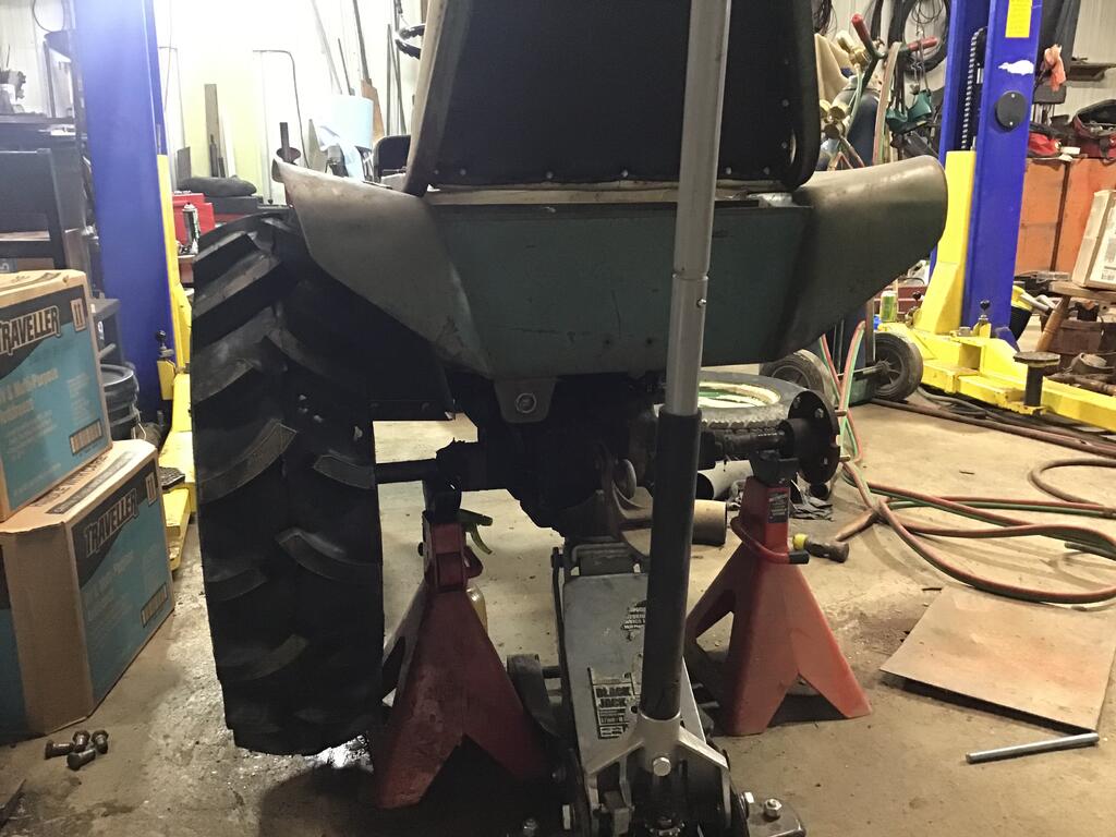

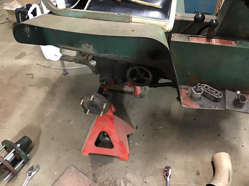

Pullstart 70,705 #2 Posted October 28, 2020 I imagine if need be, a set of 12” weights can also be added. I’m not sure how necessary they are, but more weight is always better! These also seem to stick out more with the 5 lug hubs and the 12” wheels, I am considering a 6 speed swap with shorter axles to bring them inboard a tickle. 7 2 Share this post Link to post Share on other sites
Pullstart 70,705 #3 Posted October 28, 2020 For anyone unsure of the Interco name, think mud trucks. These are designed by side by side UTV’s, but I imagine the quality in the name is just the same. 1 Share this post Link to post Share on other sites

Lee1977 7,709 #11 Posted October 30, 2020 On 10/28/2020 at 9:23 AM, pullstart said: I imagine if need be, a set of 12” weights can also be added. I’m not sure how necessary they are, but more weight is always better! These also seem to stick out more with the 5 lug hubs and the 12” wheels, I am considering a 6 speed swap with shorter axles to bring them inboard a tickle. Just modify you plow hitch to line up with the existing width. Share this post Link to post Share on other sites
Pullstart 70,705 #12 Posted October 30, 2020 11 hours ago, Lee1977 said: Just modify you plow hitch to line up with the existing width. I did that for the time being, but would like the rears to track closer to the fronts either way. Share this post Link to post Share on other sites
Lee1977 7,709 #13 Posted October 30, 2020 11 minutes ago, pullstart said: I did that for the time being, but would like the rears to track closer to the fronts either way. Did you try switching sides or would that put them too close. Share this post Link to post Share on other sites

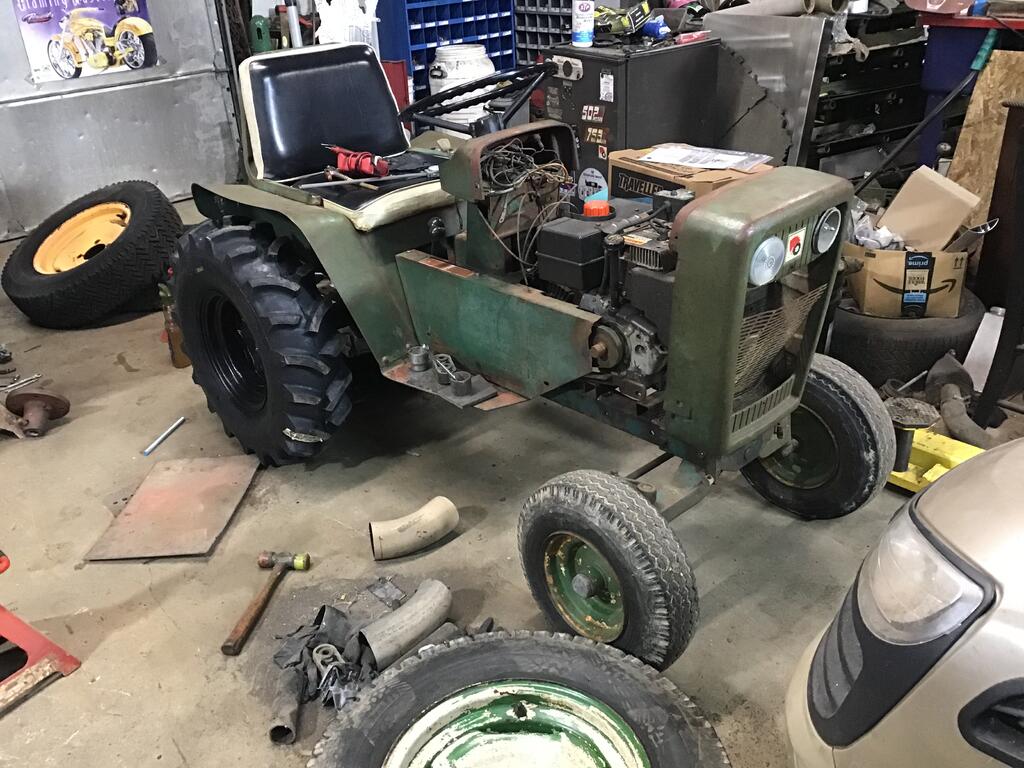

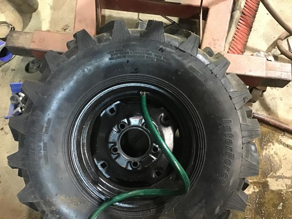

Pullstart 70,705 #14 Posted November 1, 2020 The 10” tires showed up! For reference, the 7” tires have a 7” wide tread pattern while on the 4 or 5” wide rim. The 10” tires have a 9-1/4” tread width not on wheels. There is zero air pressure in the 7” set, just fluid filled and pressurized as much as my 1/4” drill pump could do and me attempting minimal loss core swapping. Share this post Link to post Share on other sites

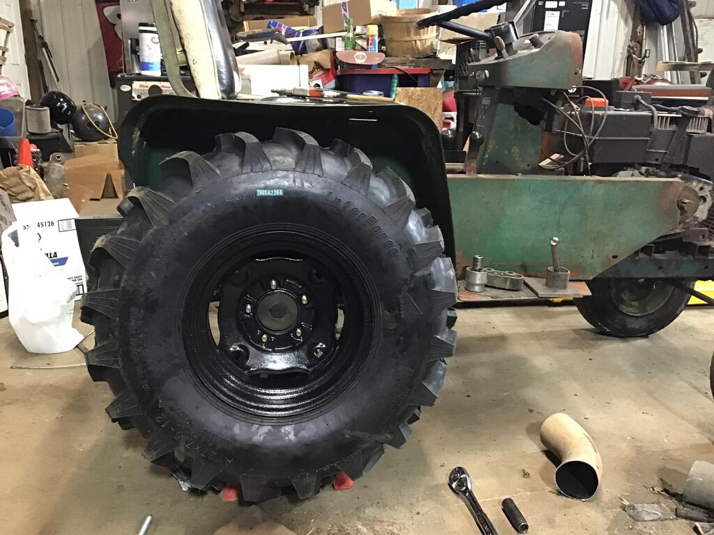

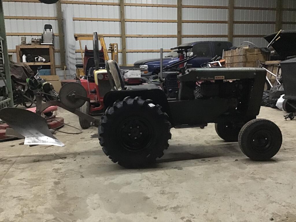

Pullstart 70,705 #18 Posted November 6, 2020 I mounted up the 27x10-12 tires last night, they are significantly larger than the 27x7.50-12’s! I think once fluid filled, I’ll be plenty butt heavy! As far as height goes, keep in mind the skinnies have only fluid pressure from a 1/4” transfer pump inside, zero air pressure. 4 Share this post Link to post Share on other sites
ebinmaine 79,689 #19 Posted November 6, 2020 1 hour ago, pullstart said: I mounted up the 27x10-12 tires last night, they are significantly larger than the 27x7.50-12’s! I think once fluid filled, I’ll be plenty butt heavy! As far as height goes, keep in mind the skinnies have only fluid pressure from a 1/4” transfer pump inside, zero air pressure. That's somewhere in the neighborhood or rugged looking Kev 1 1 Share this post Link to post Share on other sites
