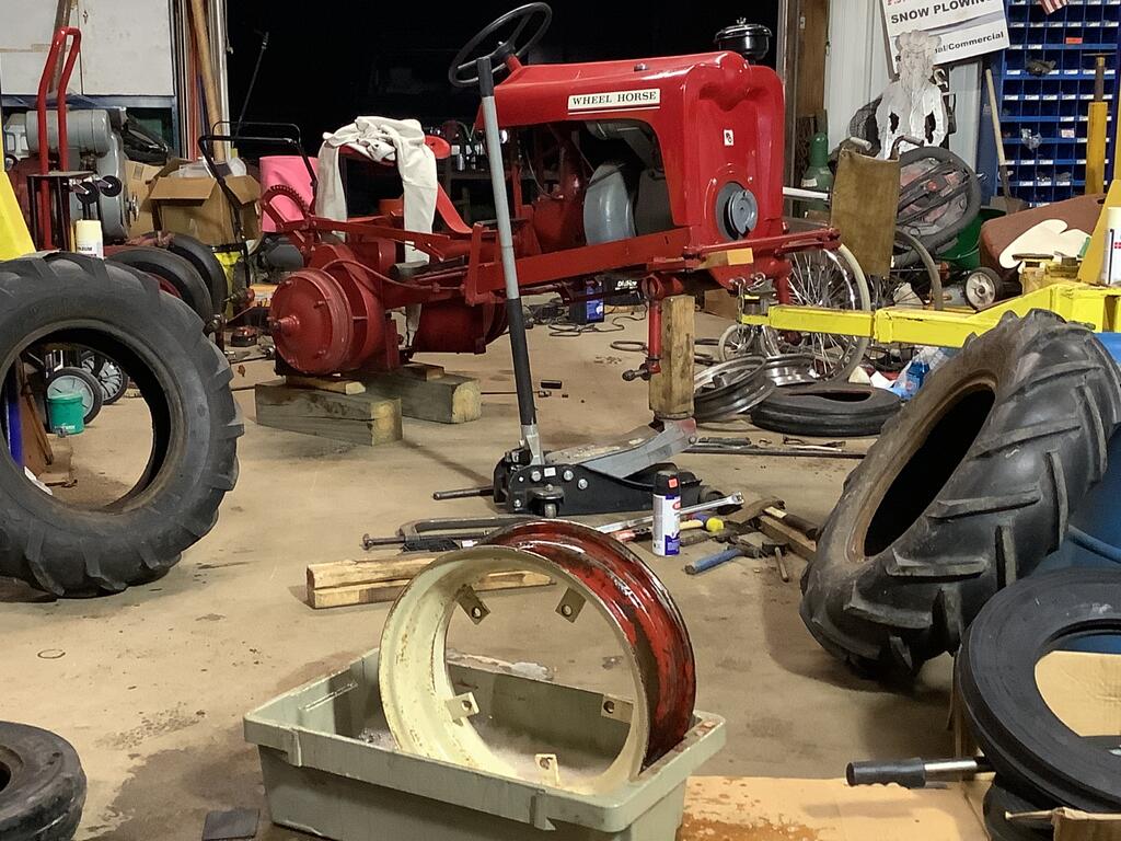

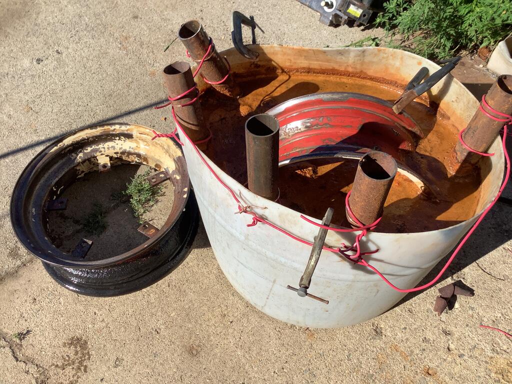

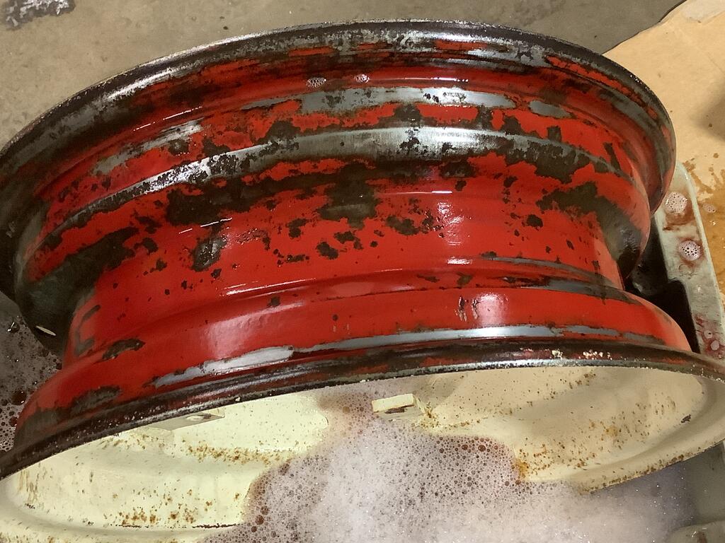

Pullstart 71,564 #153 Posted August 9, 2022 Organized chaos. Momma’s out of town so I don’t sleep much anyway. I’m playing man vs. machine. I gave the machine the super bad wheel. This second one wasn’t terrible. I’m starting to get quite a bit of shiny steel on the inside of the wheel. I checked the e-tank a few minutes ago and I can already flake the beige paint off with the SKIN of my finger. Unreal. 3 1 Share this post Link to post Share on other sites

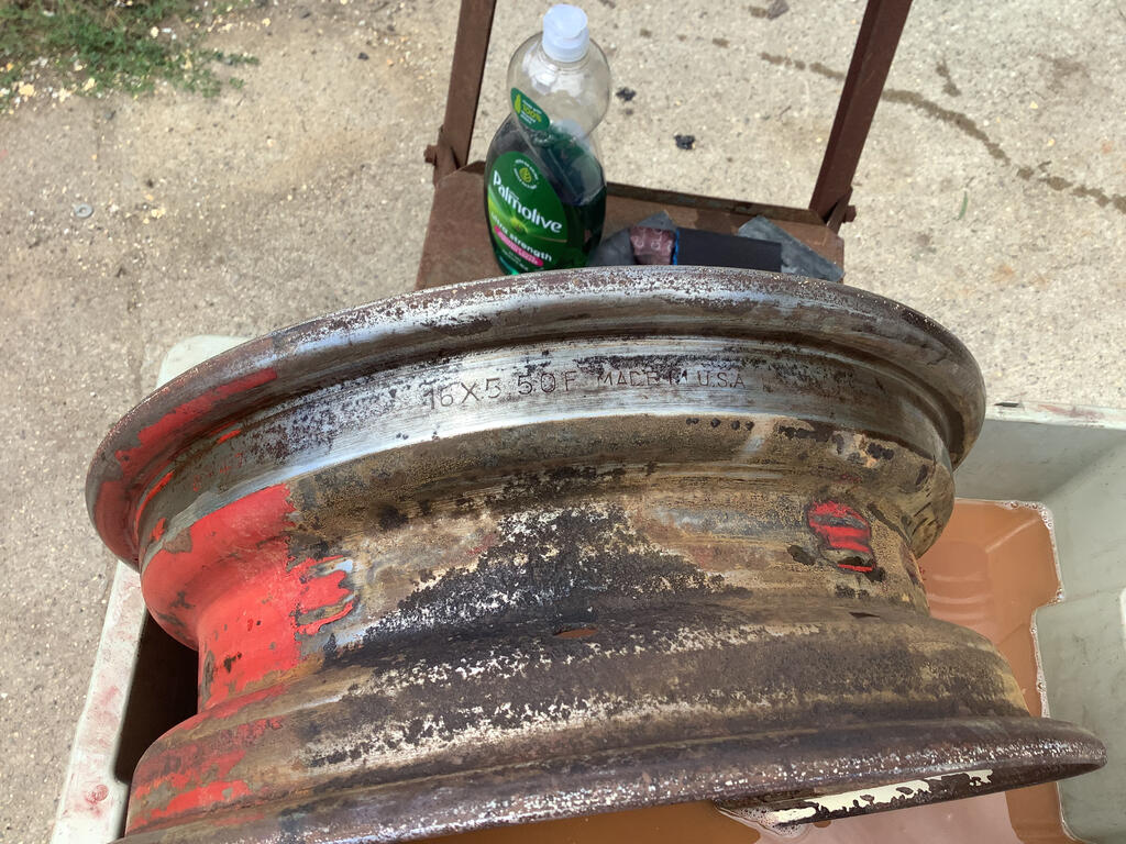

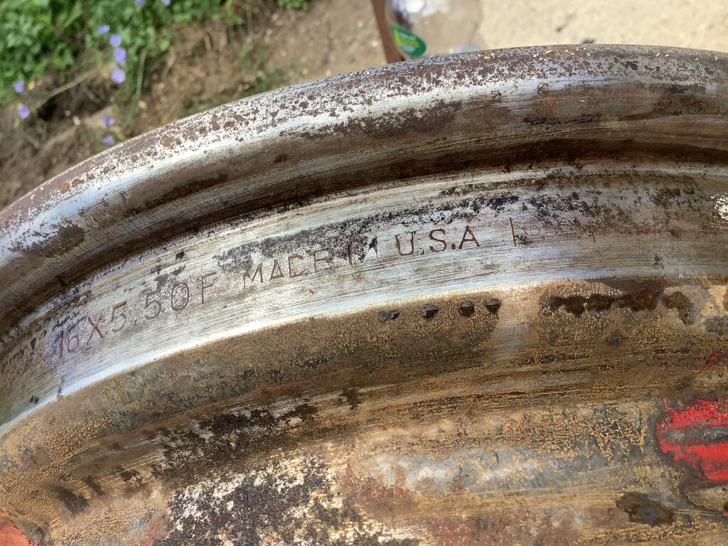

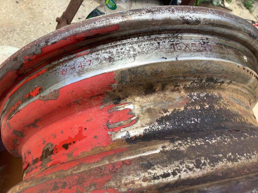

8ntruck 9,420 #154 Posted August 9, 2022 I'll agree that the 8 and 53 stamps probably mean August 1953. Ought to be another two digit stamp on there somewhere to indicate the day of the month. That other odd stamp looks like it might be a trade mark. I've used Bondo to fill rust pits in beadseats before painting with pretty good results. 1 Share this post Link to post Share on other sites
oliver2-44 11,849 #155 Posted August 9, 2022 2 hours ago, Pullstart said: #2 done. I figured out that the wheels would fit in the lathe. I was thinking of chucking them up and spinning them with some 80 grit to get some inside pitting smoothed more. I also thought maybe not. I also thought to prime and paint ‘em the way they are, then smear a light coat of bead sealer on the inside of the wheels and let it dry before mounting them. thoughts? I used JB weld on pitting on Suburban rims. Sanded them in a lathe with sand paper wrapped around a board. 1 1 1 Share this post Link to post Share on other sites

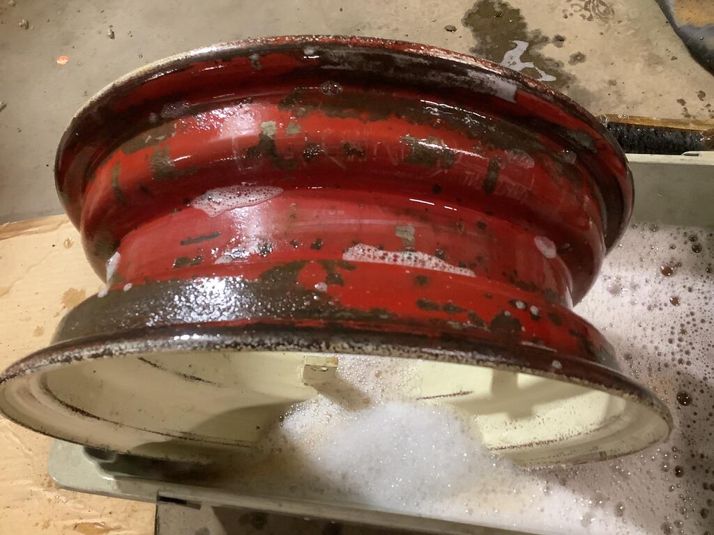

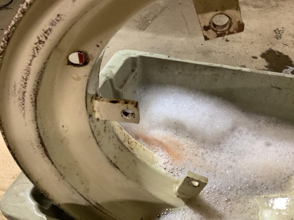

Pullstart 71,564 #156 Posted August 9, 2022 The real bad wheel got pretty far last night. I swapped them out to do a little clean out and check my progress. In man vs. machine, it’s good that I can sleep and it keeps working! 3 1 Share this post Link to post Share on other sites

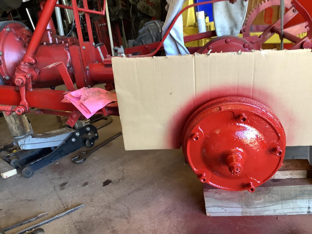

Pullstart 71,564 #157 Posted August 9, 2022 Ok, here’s a good question. Regal red is very close to this paint color. I’m shining up the wheels. Should I paint the drums and lug nuts too? Make the whole rolling stock look great? 1 Share this post Link to post Share on other sites
SylvanLakeWH 32,921 #158 Posted August 9, 2022 Yes 3 1 Share this post Link to post Share on other sites

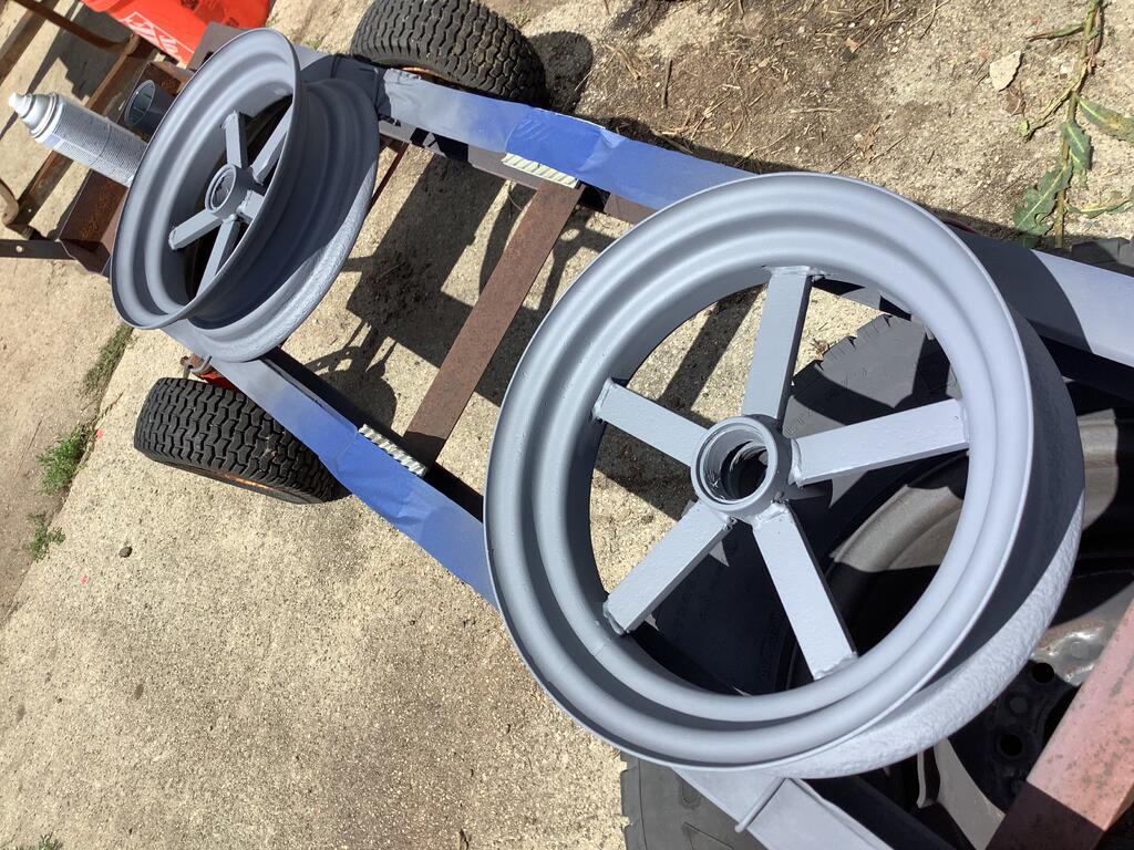

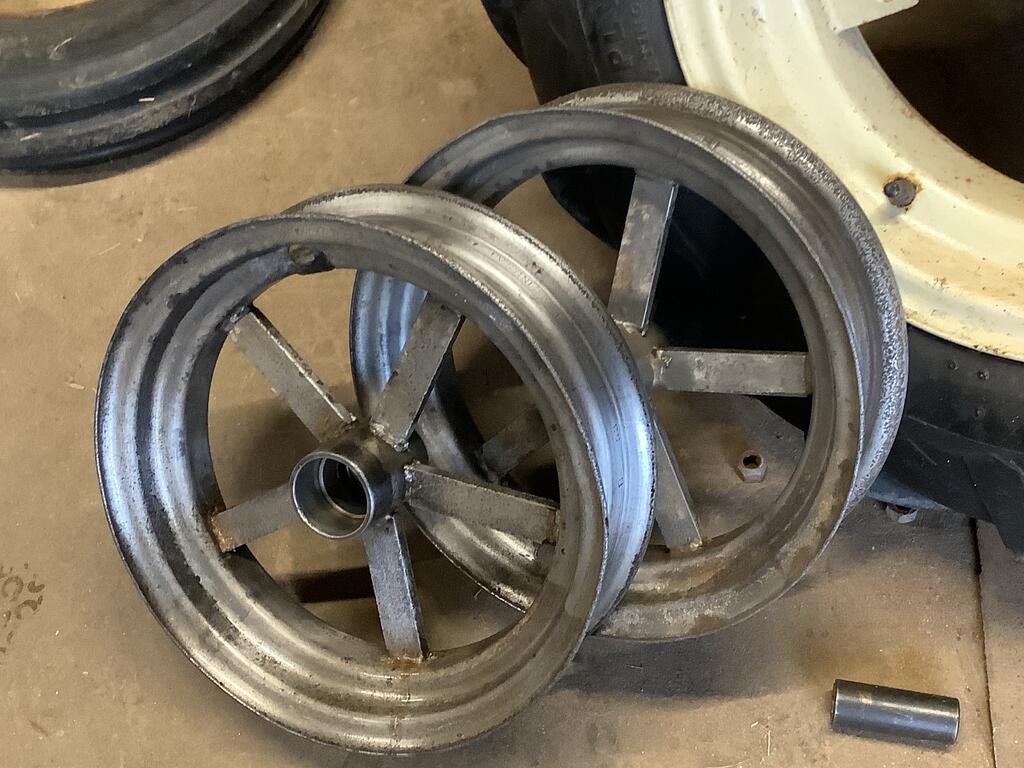

Pullstart 71,564 #159 Posted August 9, 2022 Pictures, videos, workings… get a little jumbled. Now, I’m priming the fronts, stripping the rears and heading to my wife’s grandpa’s to pull start his truck 1 1 Share this post Link to post Share on other sites

Pullstart 71,564 #162 Posted August 9, 2022 @Achto I’m using your grease trick. No masking. 3 Share this post Link to post Share on other sites
Pullstart 71,564 #163 Posted August 9, 2022 16 hours ago, WheelHorse79 said: I wonder if the "8" and "53" stamps mean August of 1953? Might also help date the tractor's time of manufacture. I don’t doubt you or @8ntruck a bit. Look at the rear wheel! 6-47! New Old Stock in the mid 50’s maybe? 2 Share this post Link to post Share on other sites
8ntruck 9,420 #164 Posted August 9, 2022 Year 6, day of year 47 maybe? Share this post Link to post Share on other sites

Pullstart 71,564 #167 Posted August 10, 2022 23 hours ago, Pullstart said: Should I paint the drums and lug nuts too? Make the whole rolling stock look great? 23 hours ago, SylvanLakeWH said: Yes I’m not sold on Regal Red… looks too bright. Share this post Link to post Share on other sites
Handy Don 17,735 #168 Posted August 10, 2022 10 minutes ago, Pullstart said: I’m not sold on Regal Red… looks too bright. On this tractor, I agree. In that era colors were more muted. Share this post Link to post Share on other sites
SylvanLakeWH 32,921 #169 Posted August 10, 2022 I’m guessing with the white wheels on you won’t notice. But it’s your baby, do what you see fit!!! It’s all good!!! Share this post Link to post Share on other sites
ebinmaine 81,283 #170 Posted August 10, 2022 1 hour ago, Pullstart said: I’m not sold on Regal Red… looks too bright. Is there a version of IHC Implement Red that's closer? 1 Share this post Link to post Share on other sites
Pullstart 71,564 #171 Posted August 10, 2022 20 minutes ago, ebinmaine said: Is there a version of IHC Implement Red that's closer? I am using more primer than planned, so a trip to the ACE is in order. There’s also a farmer’s elevator in town I might check out. 2 Share this post Link to post Share on other sites
ebinmaine 81,283 #172 Posted August 10, 2022 1 minute ago, Pullstart said: I am using more primer than planned, so a trip to the ACE is in order. There’s also a farmer’s elevator in town I might check out. If you buy the Ace Brand Paint be aware that it sprays okay but it covers VERY poorly so expect to use a lot more than normal 1 Share this post Link to post Share on other sites
Pullstart 71,564 #173 Posted August 10, 2022 6 minutes ago, ebinmaine said: If you buy the Ace Brand Paint be aware that it sprays okay but it covers VERY poorly so expect to use a lot more than normal Yeah, I try to stick to Rustoleum for the most part. I did 5 coats of grey in the front wheels yesterday with about 1.5 cans. I dusted some ACE red on those two wheels and almost ran the can out! 1 1 Share this post Link to post Share on other sites
