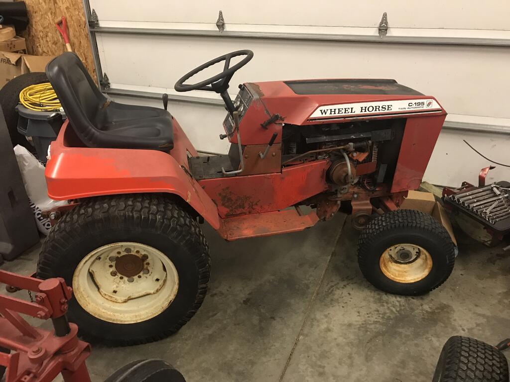

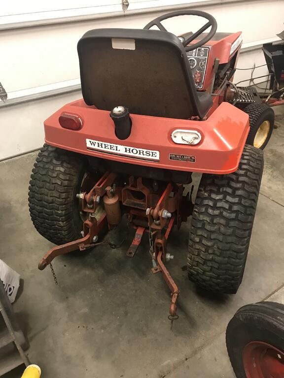

WHX?? 58,388 #27 Posted October 27, 2020 (edited) Does the 195 have a 3 PT hitch? If not I saw one for sale local to you guys. Did you mention the other tractors the seller had in his harem Kev? Edited October 27, 2020 by WHX24 1 Share this post Link to post Share on other sites
scWHhauler 96 #28 Posted October 27, 2020 well done 1 Share this post Link to post Share on other sites
ebinmaine 81,283 #29 Posted October 28, 2020 SUPER AWESOME 1 Share this post Link to post Share on other sites
Pullstart 71,564 #30 Posted October 28, 2020 35 minutes ago, WHX24 said: Does the 195 have a 3 PT hitch? If not I saw one for sale local to you guys. Did you mention the other tractors the seller had in his harem Kev? The 195 did have the 3 pt, but I’m sure tht’s not for sale either. As for the rest of the collection, it would be easier to list what he doesn’t have. Here’s that list: 1) room for much more. 1 1 Share this post Link to post Share on other sites
WHX?? 58,388 #31 Posted October 28, 2020 10 minutes ago, pullstart said: The 195 did have the 3 pt, but I’m sure tht’s not for sale either. Lost me ther Kev the 3 pt did not come with the tractor? Heavens no not for sale if it came with it.... hens teeth ther. @Bow_Extreme you need to start a thread on that tractor for us Super C fans! 1 Share this post Link to post Share on other sites
Bow_Extreme 584 #32 Posted October 28, 2020 (edited) 19 minutes ago, WHX24 said: Lost me ther Kev the 3 pt did not come with the tractor? Heavens no not for sale if it came with it.... hens teeth ther. @Bow_Extreme you need to start a thread on that tractor for us Super C fans! I have a 3-Point kit for sale. Yes, there was a 3-Point on that tractor. I also have a PTO kit but it’s not for sale. I do have another C-195 for sale as well. When I get some time, I will start a thread. Edited October 28, 2020 by Bow_Extreme 4 1 Share this post Link to post Share on other sites
bds1984 1,519 #33 Posted October 28, 2020 (edited) 16 hours ago, Bow_Extreme said: not for sale...lol. It’s an 84’ I don't blame you. I had a very, very nice 84 C195 that I regret selling; I've never seen an original plastic fender pan with no cracks in it and this one had it. Had I known the buyer only wanted the 60" deck, I would have been more than happy to sell just that to him. But as many of us know, life gets in the way sometimes. Edited October 28, 2020 by bds1984 photo 2 2 Share this post Link to post Share on other sites
WHX?? 58,388 #34 Posted October 28, 2020 14 hours ago, Bow_Extreme said: also have a PTO kit but it’s not for sale. Hen's teeth ther too I been told. 1 Share this post Link to post Share on other sites

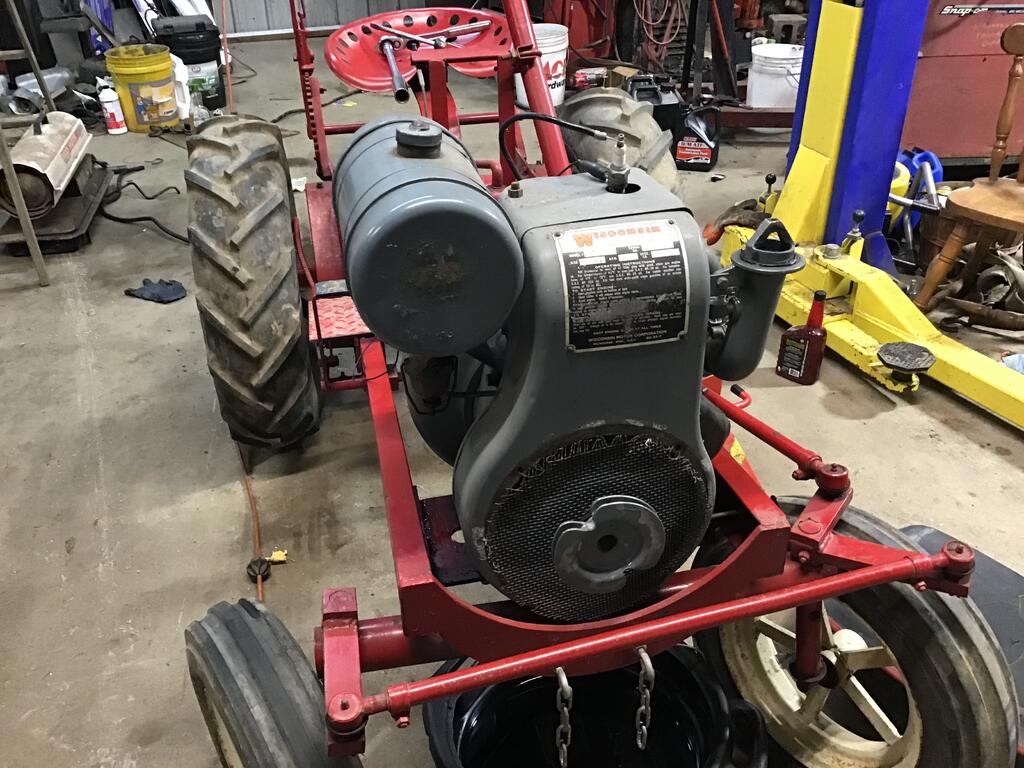

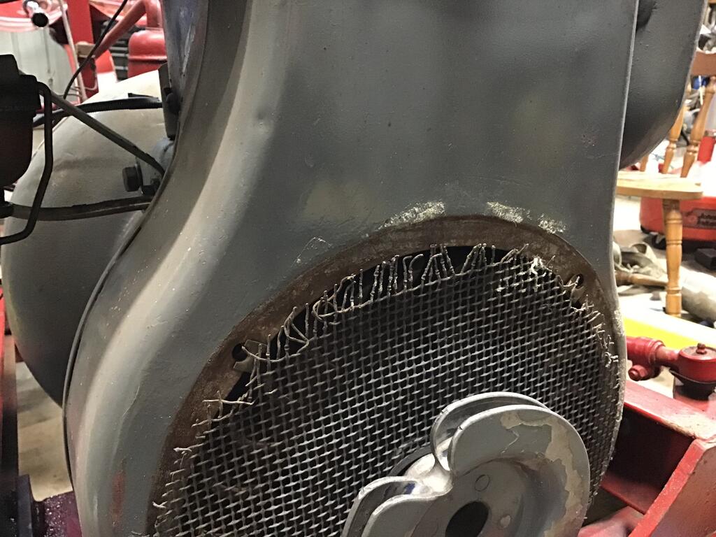

Pullstart 71,564 #35 Posted November 2, 2020 Getting some shop time with the Senior tonight... FRESH oil, cleaning the fuel system, etc. 2 5 Share this post Link to post Share on other sites

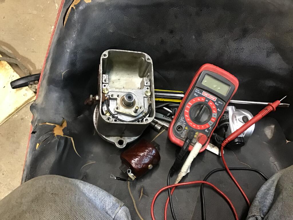

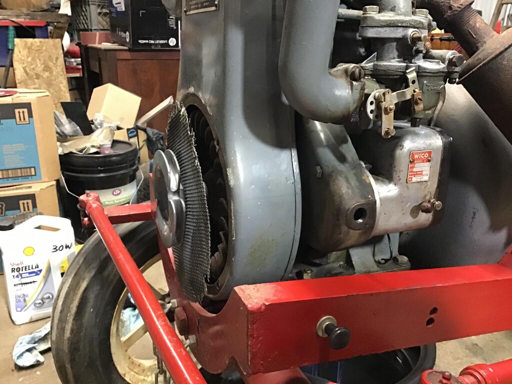

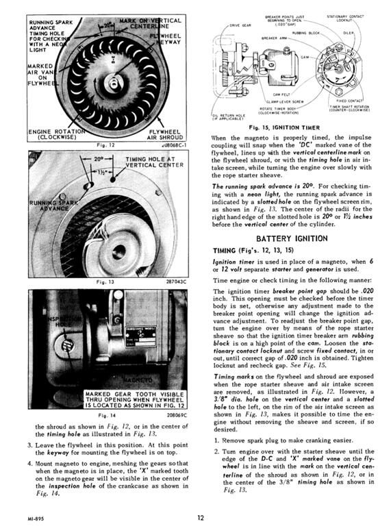

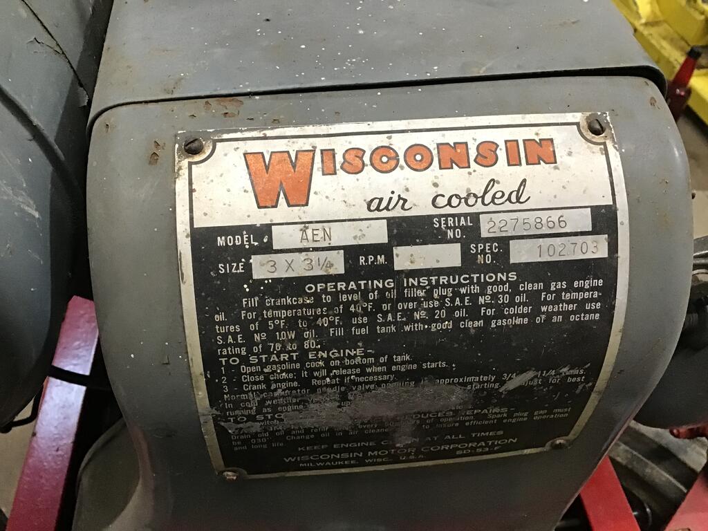

Pullstart 71,564 #38 Posted November 2, 2020 Last night, I started working on this old man! I don’t yet have spark on a consistent basis, it was there a couple times at the points but now I don’t have anything. I also mistakenly pulled the magneto off, so I am not sure if the timing is right. Doh! 2 Share this post Link to post Share on other sites

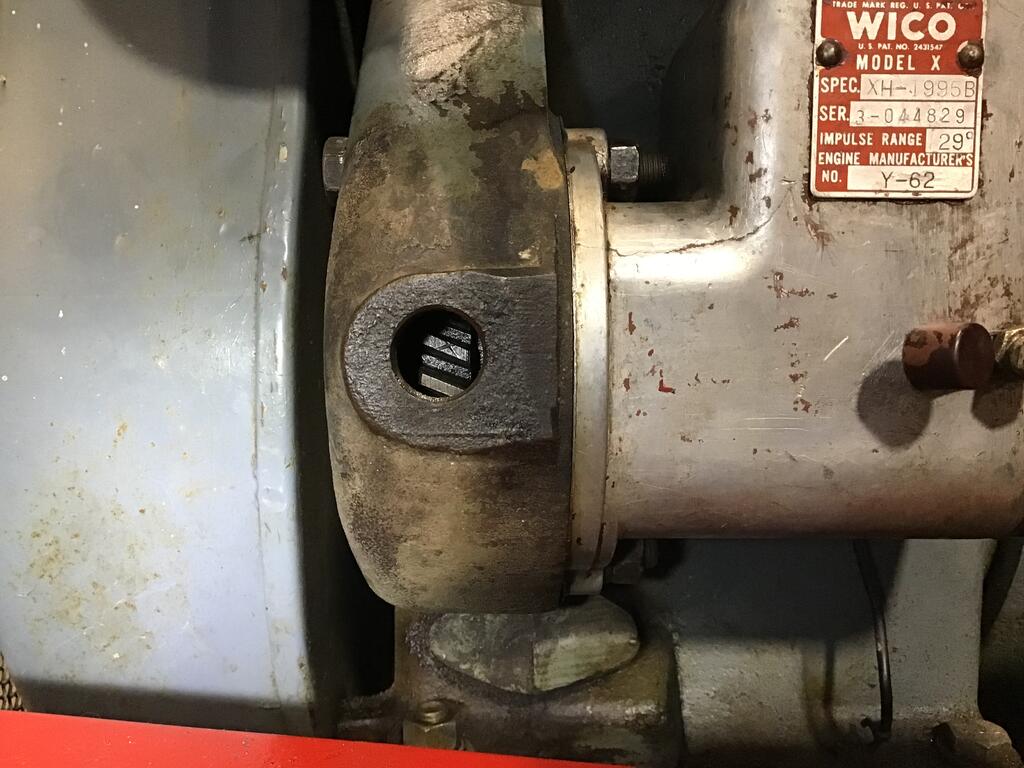

Pullstart 71,564 #39 Posted November 2, 2020 Well, it seems the Wisconsin engine has timing holes in the flywheel shroud, but they are beneath the hood. Speaking with Ron Greco, he’d like to record the engine serial number, if there is a possibility. Sounds like I’ll be pulling the hood... as soon as I get back to the shop! Share this post Link to post Share on other sites
stevebo-(Moderator) 8,744 #40 Posted November 2, 2020 That is so awesome!!!! Tell mama I cannot wait to ride with her at the next big show! Congrats👍 2 1 Share this post Link to post Share on other sites
stevebo-(Moderator) 8,744 #41 Posted November 2, 2020 You have the newer style carb on that and imo find the right carb. You should not have a choke cable either. The correct carb you flip lever up to choke and when it starts it goes off via spring load. Give me a call if you have any questions. 1 1 Share this post Link to post Share on other sites
wh500special 2,474 #42 Posted November 2, 2020 Block the tires or jack the tractor up before you start it. Even in neutral, some Seniors will drive away on you when the transmission is cold. Steve 2 1 Share this post Link to post Share on other sites

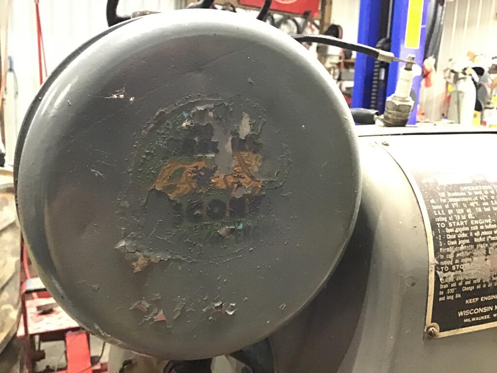

Pullstart 71,564 #43 Posted November 2, 2020 Well the hood came off quite easily! The timing marks aren’t exactly how the manual shows, but I found what I needed. The gas tank decal is cool, does anyone know what it used to look like in it’s entirety? @Vinylguy? 7 Share this post Link to post Share on other sites
Vinylguy 4,812 #44 Posted November 2, 2020 This is the only one I have other than hood decals 4 Share this post Link to post Share on other sites
Pullstart 71,564 #45 Posted November 2, 2020 3 minutes ago, Vinylguy said: This is the only one I have other than hood decals gotcha. Share this post Link to post Share on other sites
Pullstart 71,564 #46 Posted November 2, 2020 Now that I know how to time the magneto, I’m not concerned with the removal of it. Troubleshooting the no spark issue, I believe the coil has a bad field and needs replacements. I have an order in to Steiner Tractor parts for the coil, condenser and points. 1 Share this post Link to post Share on other sites

AMC RULES 37,261 #48 Posted November 2, 2020 @Vinylguy 4 Share this post Link to post Share on other sites
Pullstart 71,564 #49 Posted November 2, 2020 Wow Craig, those are cool! 2 Share this post Link to post Share on other sites
AMC RULES 37,261 #50 Posted November 2, 2020 Either one of them match your tank decal? Share this post Link to post Share on other sites
