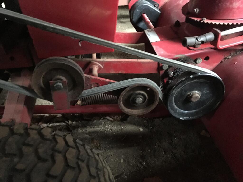

wallfish 20,002 #4 Posted October 21, 2020 If everything is connected correctly, remove washers if there are any or the tube may need to be shortened. Also your belt tension pulleys are on wrong. The belt goes through the pulleys on the bottom side of the loop only. The top of the belt loop is the drive side and should go directly to the driven pulley of the blower 1 1 Share this post Link to post Share on other sites
Ed Kennell 46,135 #5 Posted October 21, 2020 (edited) 36 minutes ago, wallfish said: If everything is connected correctly, remove washers if there are any or the tube may need to be shortened. Also your belt tension pulleys are on wrong. The belt goes through the pulleys on the bottom side of the loop only. The top of the belt loop is the drive side and should go directly to the driven pulley of the blower Good catch John. I should have been able to see that with these brand new eyeballs. I do see the chute rotator crank is missing. Edited October 21, 2020 by Ed Kennell 2 Share this post Link to post Share on other sites
peter lena 9,893 #6 Posted October 21, 2020 agree with above on the belt routing detail, another thing in the same area that is often neglected is lubrication on the 2 pulleys that drive off a spring loaded solid axel , lubrication lets the pulleys and shaft follow the spring tension , making for a stronger/easier running unit, also chain lube the #40 auger chain drive and adjust as needed. if you run the blower , and go over it with lubricant at every rust /movement point , it will move easier. jmoe , pete 1 Share this post Link to post Share on other sites

TonyToro 1,166 #9 Posted October 22, 2020 14 hours ago, wallfish said: If everything is connected correctly, remove washers if there are any or the tube may need to be shortened. Also your belt tension pulleys are on wrong. The belt goes through the pulleys on the bottom side of the loop only. The top of the belt loop is the drive side and should go directly to the driven pulley of the blower Ok Thanks. I will see if the pulleys can be repositioned. The way it is now is how I got it. I just threaded the belt through it to my engine pulley and seemed to work fine as is? Share this post Link to post Share on other sites

wallfish 20,002 #12 Posted October 22, 2020 In that configuration of the belt it will hit the front axle when the axle tilts up. Looks like it's almost touching it now For the lift, you also want it to drop lower than the front tires as well so it can float with the terrain as you drive. 1 Share this post Link to post Share on other sites
pfrederi 20,613 #13 Posted October 22, 2020 Should look like this. 1 2 Share this post Link to post Share on other sites

TonyToro 1,166 #15 Posted October 24, 2020 Fixed the belt on the C-145 and heading to get rid to make a chute crank. Thank you for all the expert advise. 1 Share this post Link to post Share on other sites

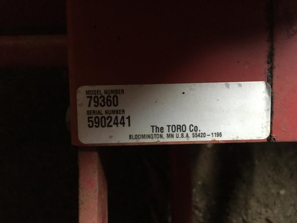

TonyToro 1,166 #23 Posted October 28, 2020 Here is the model of the snow blower Share this post Link to post Share on other sites
gwest_ca-(File Mod) 12,259 #24 Posted October 28, 2020 7 hours ago, TonyToro said: I was wondering if anyone knows the belt size on this blower? The belt I am planning on taking is beat up and stretched. From the research I did I found it to be a 69” belt? Long frame tractors use drive belt 9750 (5L x 69" or 5/8" x 69") Garry 1 Share this post Link to post Share on other sites
