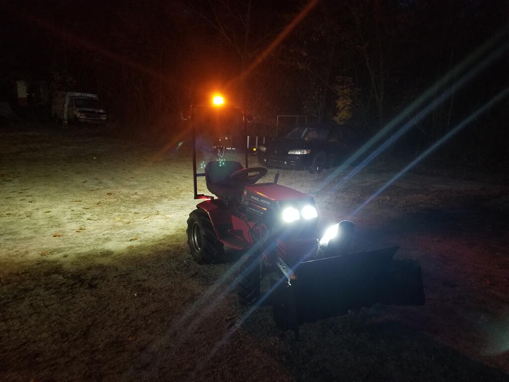

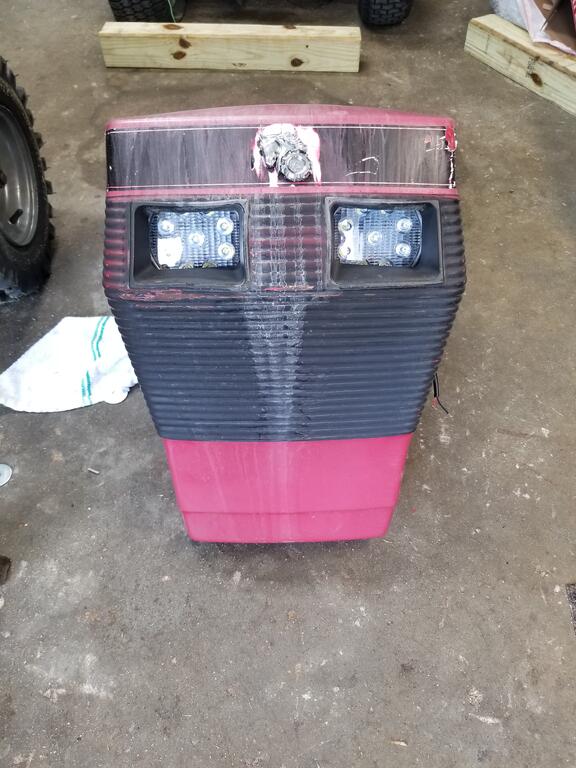

OLDWORKHORSE, like your headlight set up, can you give us some detail info on them?  brand, price, where you got them ?  thanks , pete

I'm cheap when it comes to headlights. I just went on ama-zon pick up a decent set of 4 inch round leds with a switch and relay with a fuse set up and wired them straight to the battery. Brite as all be and fit perfect. I got sum threaded rod with a nut to put back in old bolt holes and then got a piece of bar steel and cut to length used sum washers and wing nuts and just used it to hold them in nice and snug.

They are a very easy and only owning my wheelhorse a short time I must say a massive improvement over stock. Not flickering in the lights or anything. And no modification to the hood so OG bulbs can b put back in if wanted to. I tucked old wiring away and just bypassed it with new stuff but all still there for original. (Hood to 314 b4 the restore)

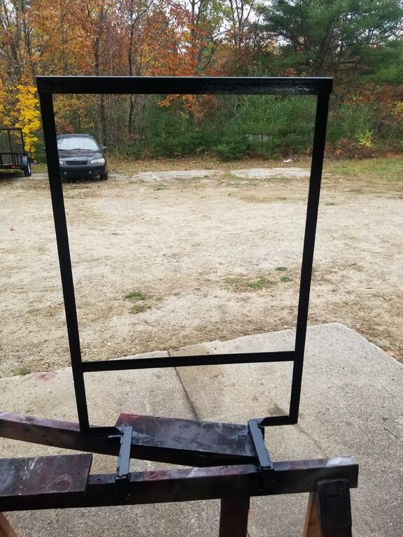

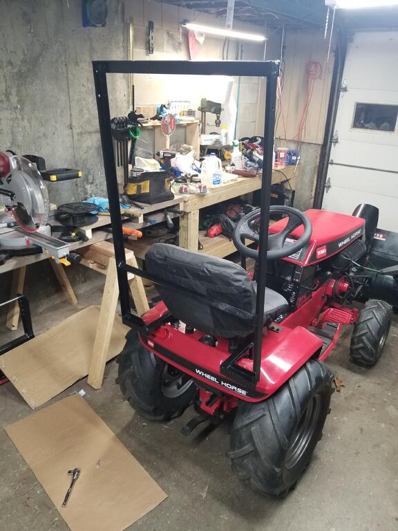

She ain't pretty but shes solid. :icecream:
  • Like 1
  • Excellent 2
ebinmaine
Looks good from here

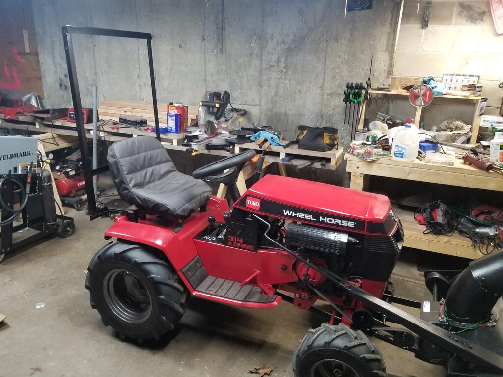

All painted and mounted up. Hopfuly works like I see it in my head :eusa-think:. Just need the lights now.
  • Like 1
  • Thanks 1

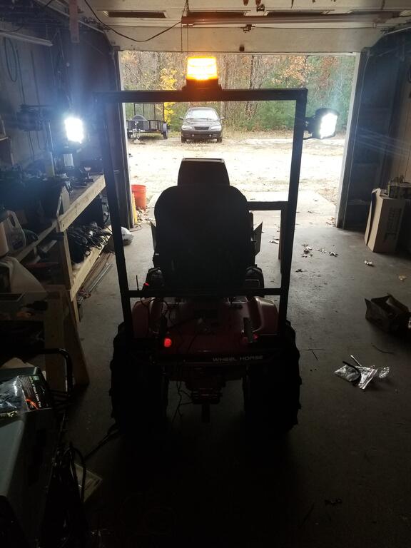

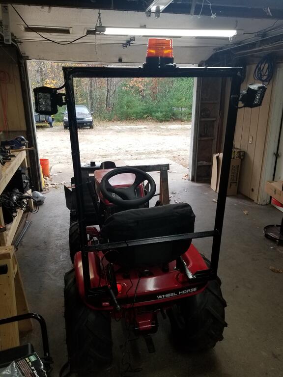

So far its working. Lights kinda mounted need be adjusted. Wires are all run. Just need to make a mini switch box to mount the plug in and switches and the mount it to the bar. :happy-smileyinthebox:
  • Like 3
OldWorkHorse

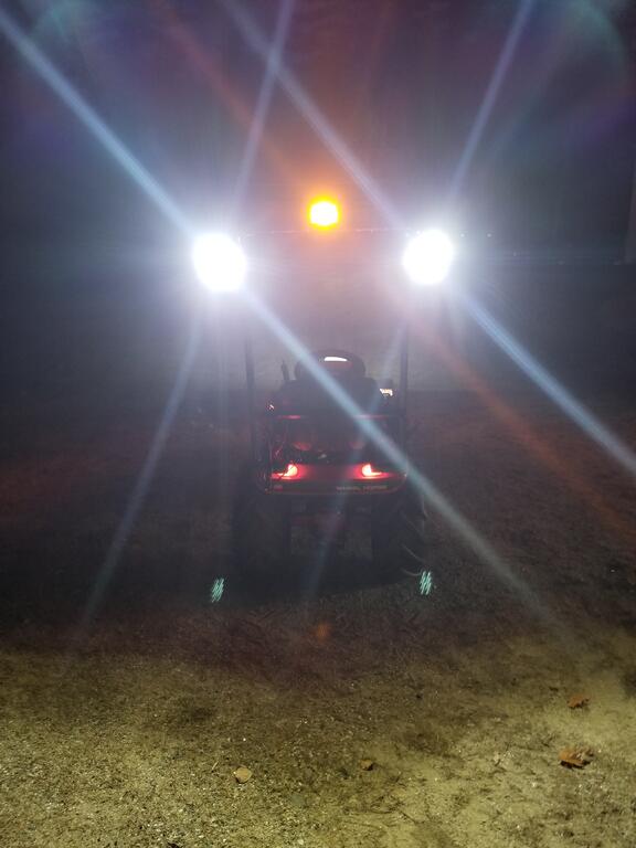

This should work. Turn lights around in the summer mow all night, I dont think the neighbors would mind ha. :techie-idea:B)
  • Like 1
  • Excellent 2
ebinmaine
Bring that down to the meet and greet and you can be the night guide for a woods ride.
VERY nice!!!
  • Haha 1

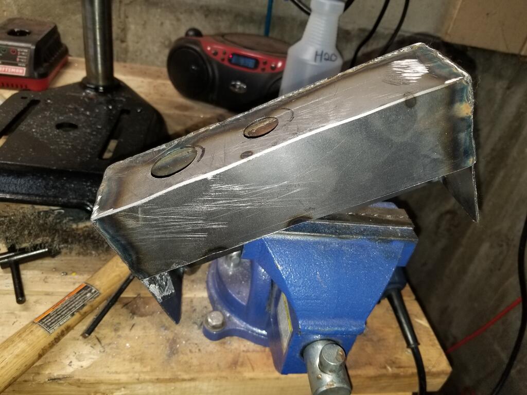

OldWorkHorse

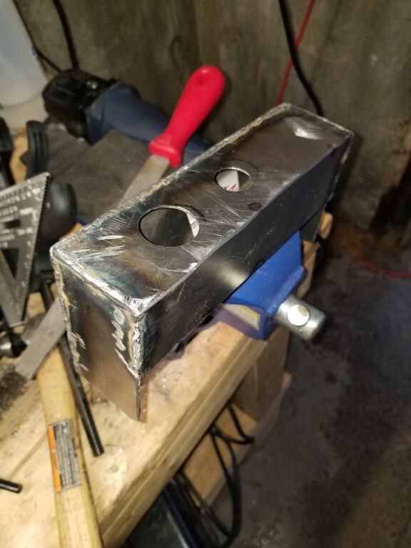

Putting together switch box for light bar.
  • Like 2
  • Excellent 1
