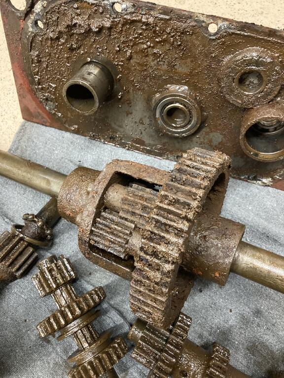

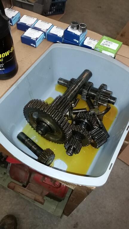

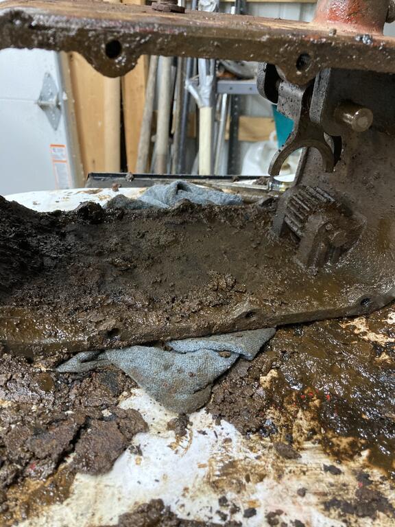

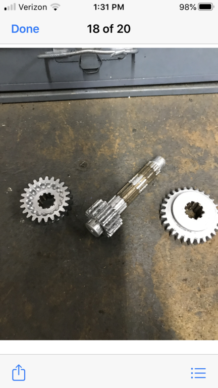

Lane Ranger 10,495 #101 Posted October 27, 2020 21 minutes ago, Frankenstein 58 said: Nothing could help this poor trans. Got it apart. All gears look good. Now good cleaning is in order Much better than most 1958 transmissions for sure! 1 1 Share this post Link to post Share on other sites
WHX?? 46,807 #102 Posted October 27, 2020 (edited) Just for some motivation Franky I saved this one... a bit noisy but she moves the tractor! Edited October 27, 2020 by WHX24 3 Share this post Link to post Share on other sites

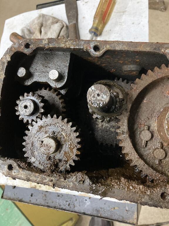

Frankenstein 58 213 #103 Posted October 28, 2020 Thanks for the motivation. My gears are pitted but it’s a 3.6 hp tractor should be fine. I’ll put better gear lube in the case. Roller bearing is out now also. 1 2 Share this post Link to post Share on other sites

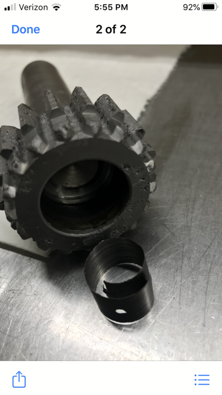

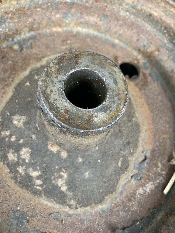

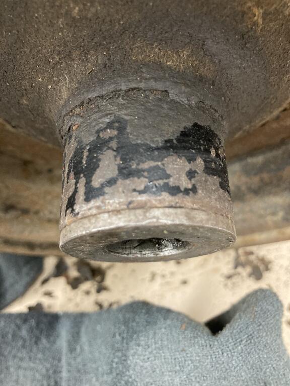

Frankenstein 58 213 #106 Posted October 29, 2020 Every day is a new adventure. Looks like a bearing less sleeve was pressed into my wheel. It’s the Wheel that was on my bad spindle. Never know what’s around the corner with these old tractors. Share this post Link to post Share on other sites
WHX?? 46,807 #107 Posted October 29, 2020 That's how the older ones were Franky. You need any I got boatloads. 1 hour ago, Frankenstein 58 said: now what’s around the corner with these old tractors. Ain't that the truth.... I look one over good pre buy and once I get it home lots of surprises! Share this post Link to post Share on other sites

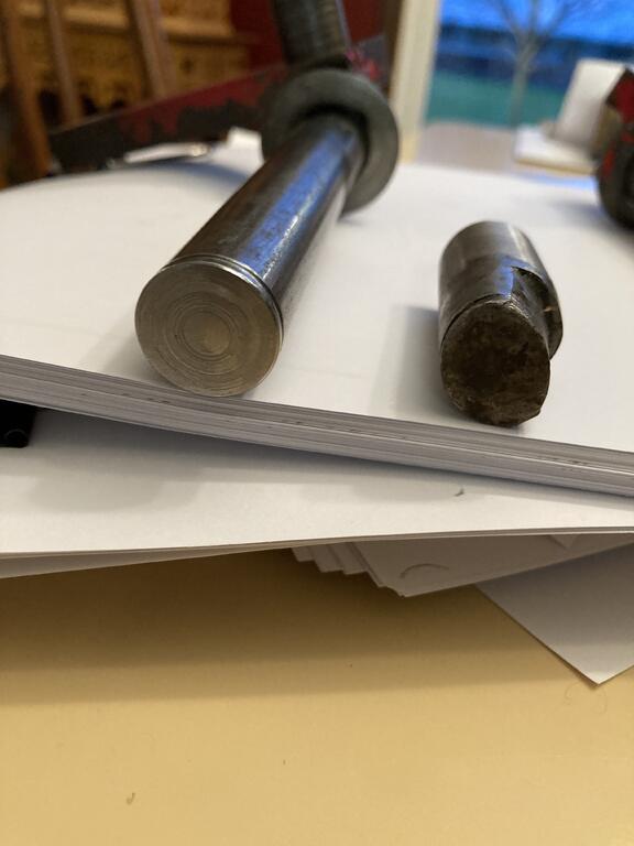

Frankenstein 58 213 #108 Posted October 29, 2020 I believe that’s a 57 wheel from what I’m told. I’m going to look into It further this weekend but if you have one or a spindle give me a yell. Thank you. My nephew started playing with the spindle. He made a new shaft. I will see how it turns out. 1 Share this post Link to post Share on other sites

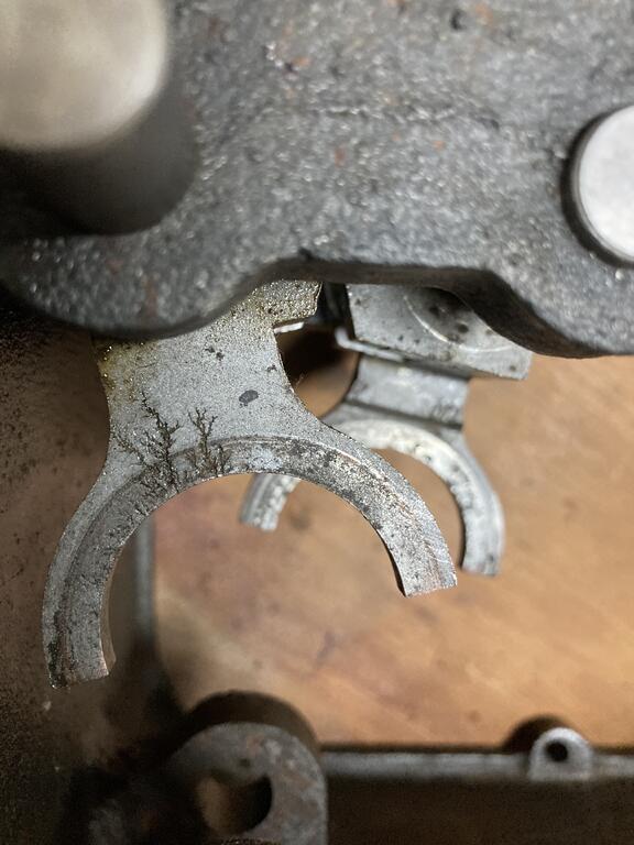

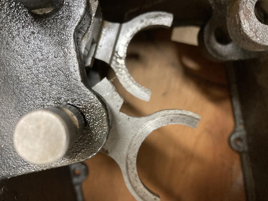

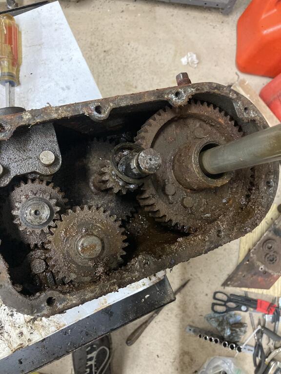

Frankenstein 58 213 #109 Posted October 31, 2020 Any thoughts.?? Shifter fork has a lot of stress cracks. It’s just the one closest to the front of the case. 1 2 Share this post Link to post Share on other sites

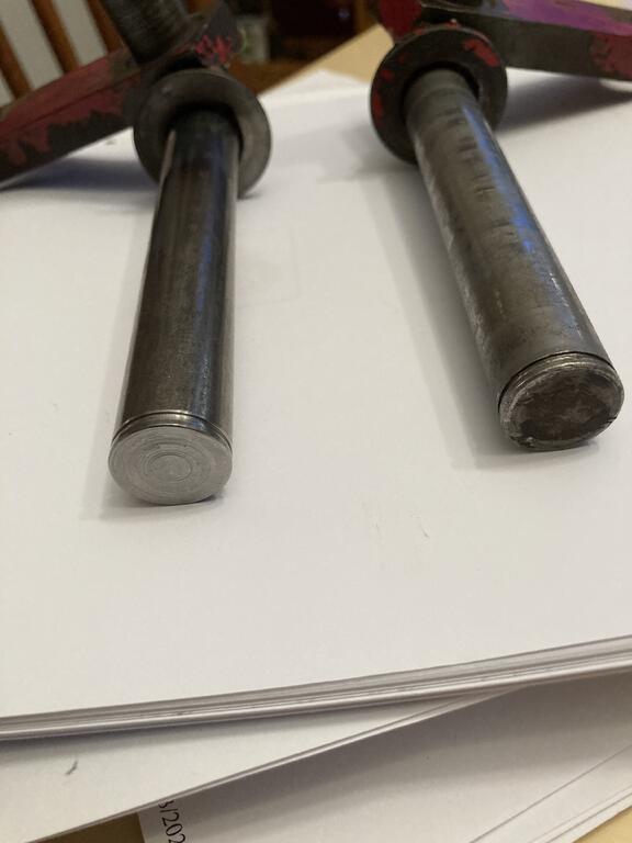

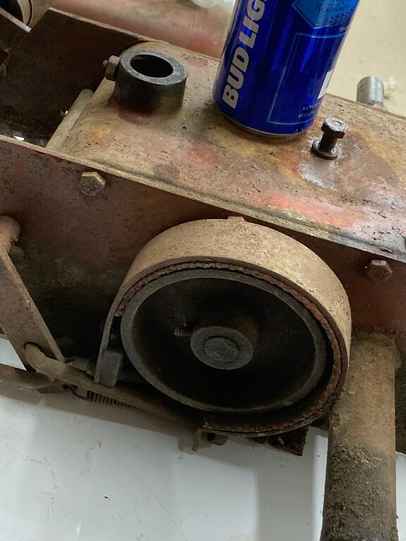

Frankenstein 58 213 #110 Posted November 26, 2020 Well getting those bearings out of trans case was fun. But they are out. Don’t ask 1 3 Share this post Link to post Share on other sites

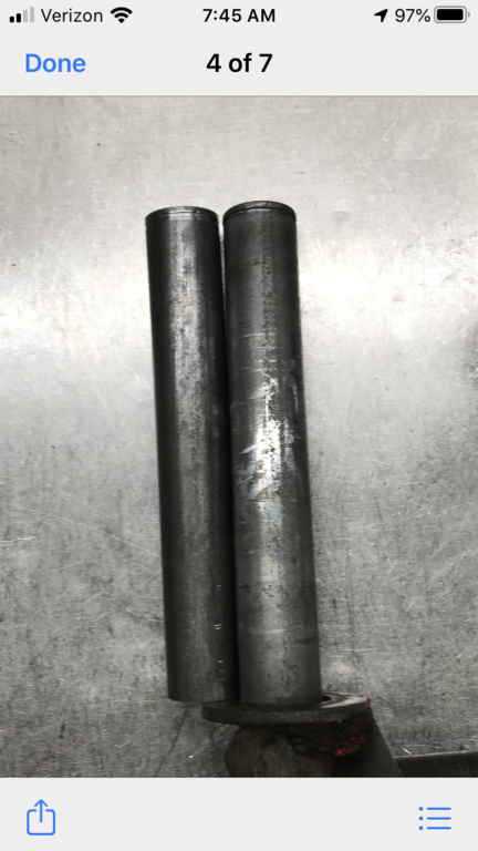

Frankenstein 58 213 #111 Posted November 26, 2020 On a good note the spindle repair turned out great 1 5 Share this post Link to post Share on other sites
AMC RULES 36,945 #112 Posted November 26, 2020 Repair or replaced? 1 Share this post Link to post Share on other sites
ebinmaine 63,177 #113 Posted November 26, 2020 17 minutes ago, Frankenstein 58 said: Well getting those bearings out of trans case was fun. But they are out. Don’t ask You used red paint to disassemble? 3 Share this post Link to post Share on other sites
Frankenstein 58 213 #114 Posted November 26, 2020 Sometimes you need to make a sacrifice in red to get things done 1 1 2 Share this post Link to post Share on other sites

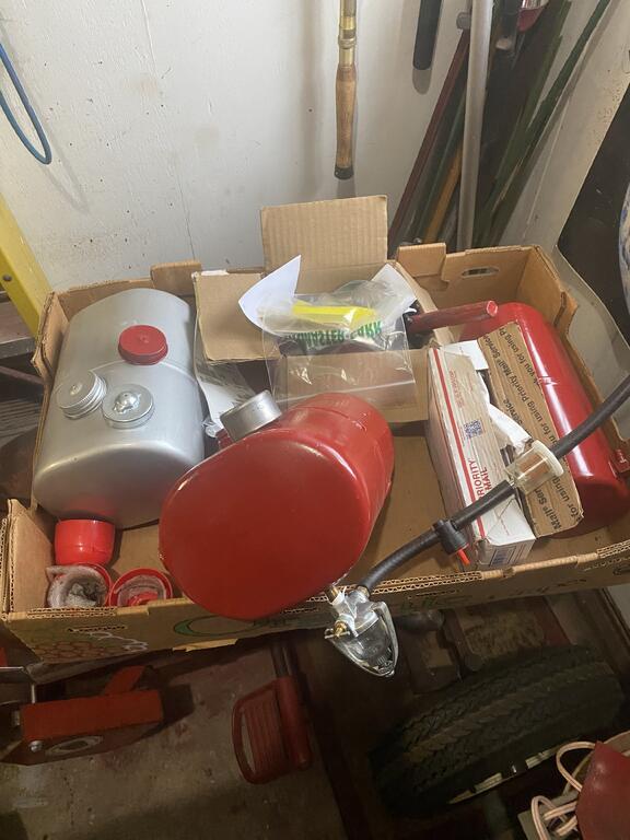

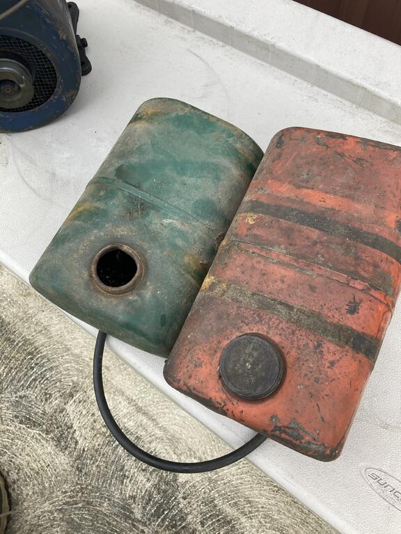

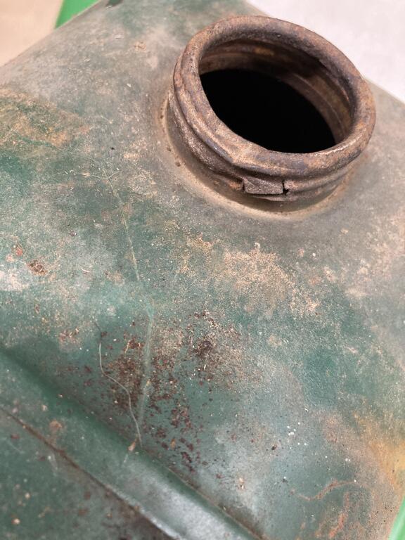

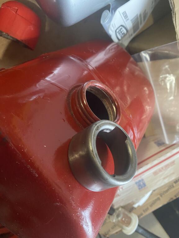

Frankenstein 58 213 #116 Posted November 26, 2020 Lastly. Does anyone know where I can get another threaded filler neck and cap so I can fix this. I have another Clinton tank but the neck is to small. Thanks. 1 Share this post Link to post Share on other sites
Frankenstein 58 213 #117 Posted November 26, 2020 4 minutes ago, AMC RULES said: Blood, sweat & beers! Whatever it takes! Had the beers 2 1 Share this post Link to post Share on other sites
WHX?? 46,807 #118 Posted November 26, 2020 @Lane Ranger has a source for weld on replacement bungs. Share this post Link to post Share on other sites
Frankenstein 58 213 #119 Posted November 26, 2020 37 minutes ago, AMC RULES said: Repair or replaced? Repaired 1 Share this post Link to post Share on other sites
Lane Ranger 10,495 #120 Posted November 26, 2020 (edited) 30 minutes ago, Frankenstein 58 said: Lastly. Does anyone know where I can get another threaded filler neck and cap so I can fix this. I have another Clinton tank but the neck is to small. Thanks. The filler necks can be changed . You can have the same height or you can add a half inch so you can more easily get the cap off to refill. I buy mine from fillernecksupply.com The ones I buy are not screw on but have the two wings that lock in. Edited November 26, 2020 by Lane Ranger 3 Share this post Link to post Share on other sites
Frankenstein 58 213 #121 Posted November 26, 2020 Ok thank you. My first choice is original but nice to have a back up plan. You can ignore my PM. Share this post Link to post Share on other sites

Frankenstein 58 213 #124 Posted November 26, 2020 Ouch I just read all that. Well I was using an inside slide hammer bearing puller. Was having no luck so I had a friend heat the bearing and me being so smart. I put a 5 pound weight on the slide hammer. My finger got in between shaft and the weight. Top of finger is still numb but the bearing are out 1 3 Share this post Link to post Share on other sites

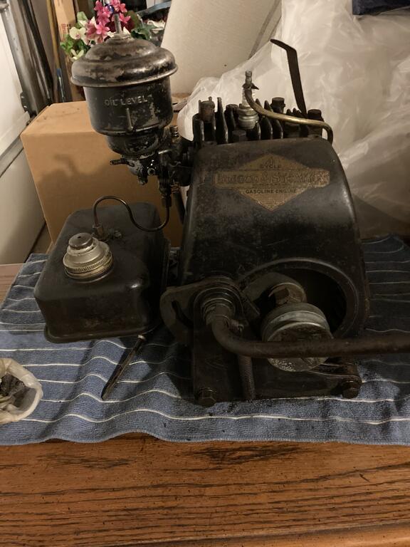

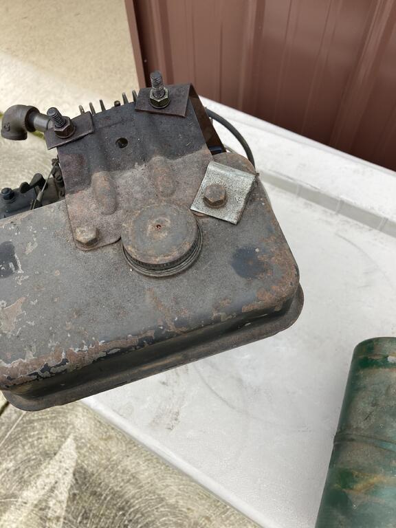

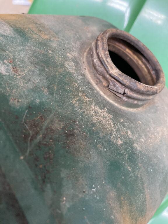

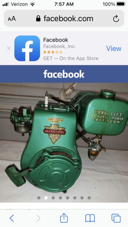

Frankenstein 58 213 #125 Posted November 28, 2020 The day after Thanksgiving turned out well. Picked up a two donor gas tanks to fix the filler neck on my original and this cool little washing machine engine from a very nice gentleman. Thought the orange one would fit but it’s to long and hits the steering shaft. Now to get the varnish out of the original one. 4 1 Share this post Link to post Share on other sites
