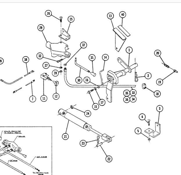

The Tuul Crib 7,354 #1 Posted October 18, 2020 I want to add the lift valve and the piston for the deck and the blade. But I want to make sure I get the correct one for this. I have a couple of sources for parts here but before I make the decision I want to make sure it is correct.was it an option or did they not put it on the charger? Share this post Link to post Share on other sites
pfrederi 21,225 #2 Posted October 18, 2020 Hydro lifts were standard on Electro's and optional on chargers. Same unit. 8-4111 Share this post Link to post Share on other sites
The Tuul Crib 7,354 #3 Posted October 18, 2020 Is this the part number of the valve? Share this post Link to post Share on other sites
pfrederi 21,225 #4 Posted October 18, 2020 The whole package. if you want part numbers of the various components look at a manual for Electro's 1 2 Share this post Link to post Share on other sites
ebinmaine 80,961 #5 Posted October 18, 2020 @pfrederi Paul what's the purpose of #14? Something to be adjusted? Share this post Link to post Share on other sites
gwest_ca-(File Mod) 12,511 #6 Posted October 18, 2020 #13 is a bracket to hold decal/scale #40. #14 is a pointer to show the position of the lift on the decal. Garry 3 1 Share this post Link to post Share on other sites
ebinmaine 80,961 #7 Posted October 19, 2020 32 minutes ago, gwest_ca said: #13 is a bracket to hold decal/scale #40. #14 is a pointer to show the position of the lift on the decal. Garry So is #14 used on a 1970 model year Charger considering it has an indicator on the top of the console? Share this post Link to post Share on other sites
gwest_ca-(File Mod) 12,511 #8 Posted October 19, 2020 item 14 is part number 6649. Shows up on many 1966-1977 models but not on the Charger until 1972. I don't know what you have. Garry 1 Share this post Link to post Share on other sites

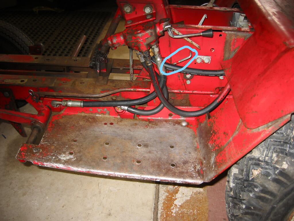

pfrederi 21,225 #9 Posted October 19, 2020 Eric: All 5 of my Charger Electros have this set up. Decal is visible just above#14 indicator Where is your indicator??? Share this post Link to post Share on other sites
ebinmaine 80,961 #10 Posted October 19, 2020 1 hour ago, pfrederi said: Eric: All 5 of my Charger Electros have this set up. Decal is visible just above#14 indicator Where is your indicator??? I'm not at home so I can't take pictures of it. The valve assembly and the bracket for the indicator was all removed and switched over to what I assume is a generic log splitter type valve. The indicator on this particular tractor is just a hand-drawn little note on the top cover plate. Share this post Link to post Share on other sites
