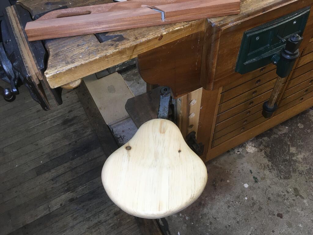

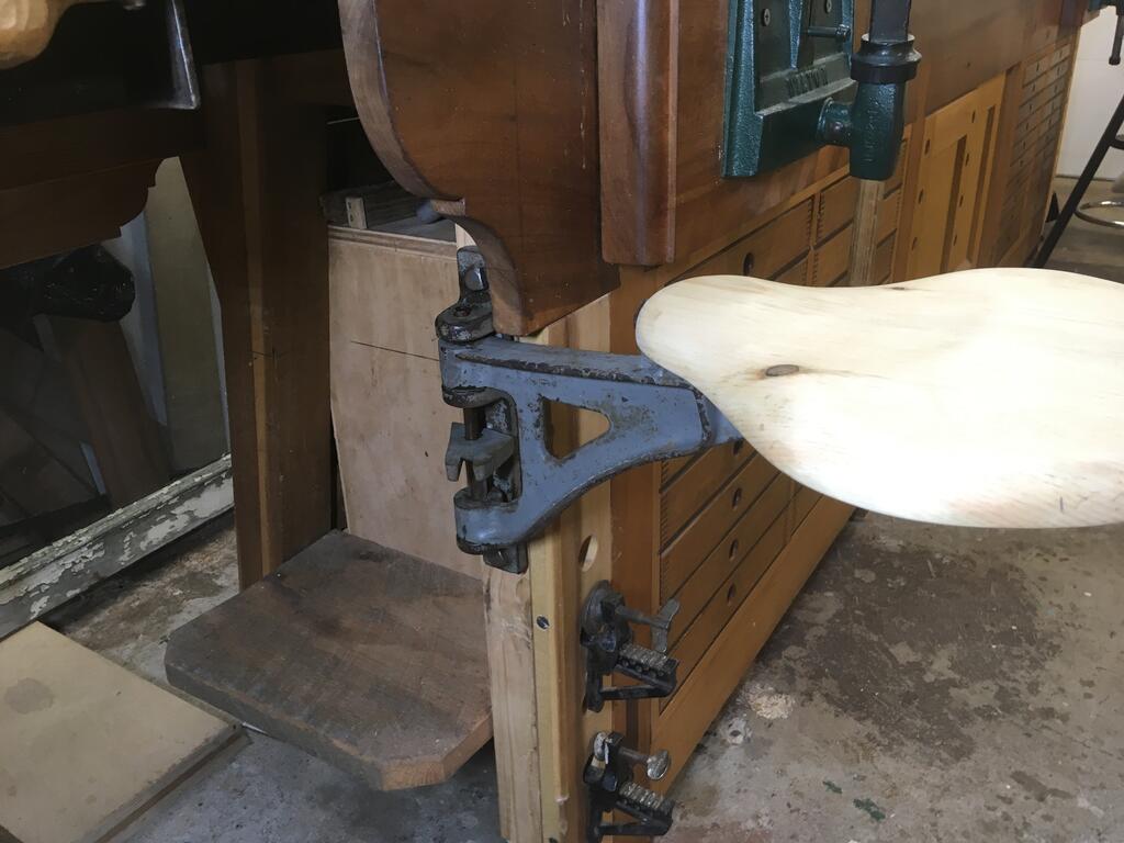

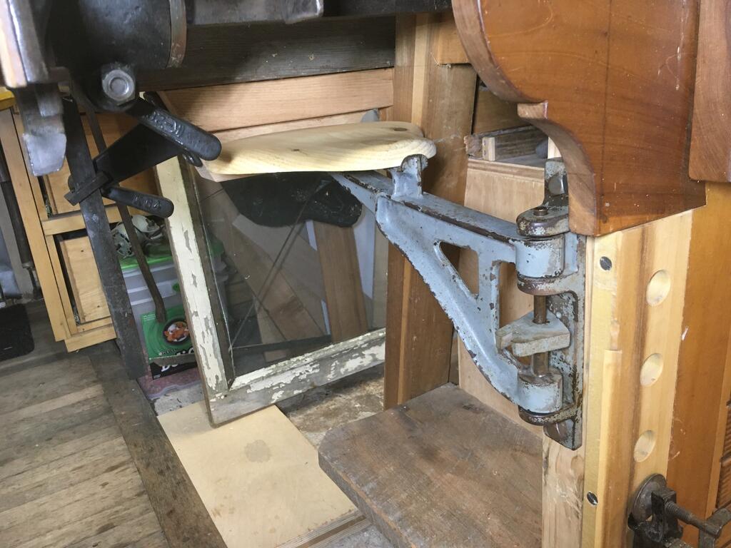

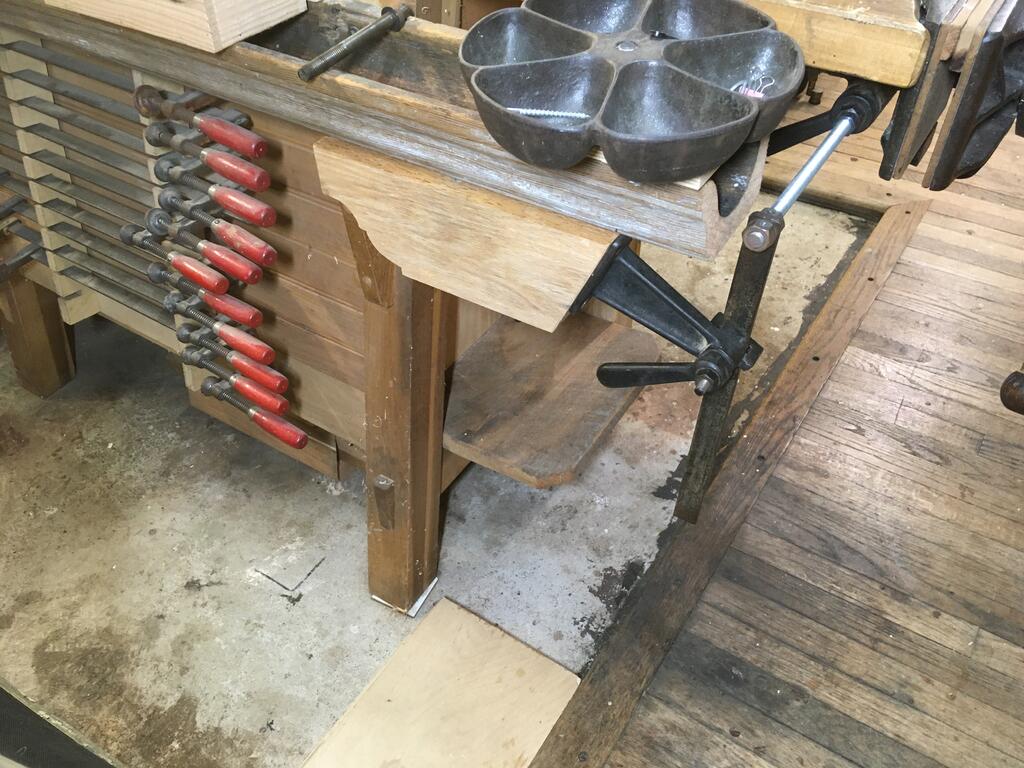

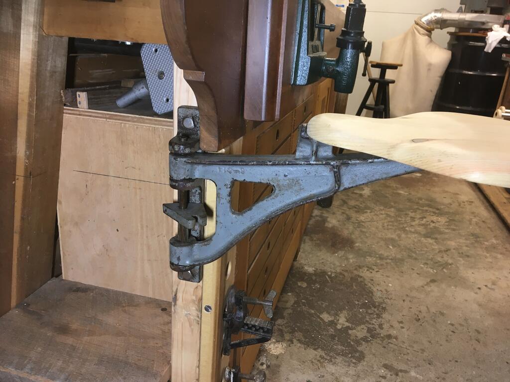

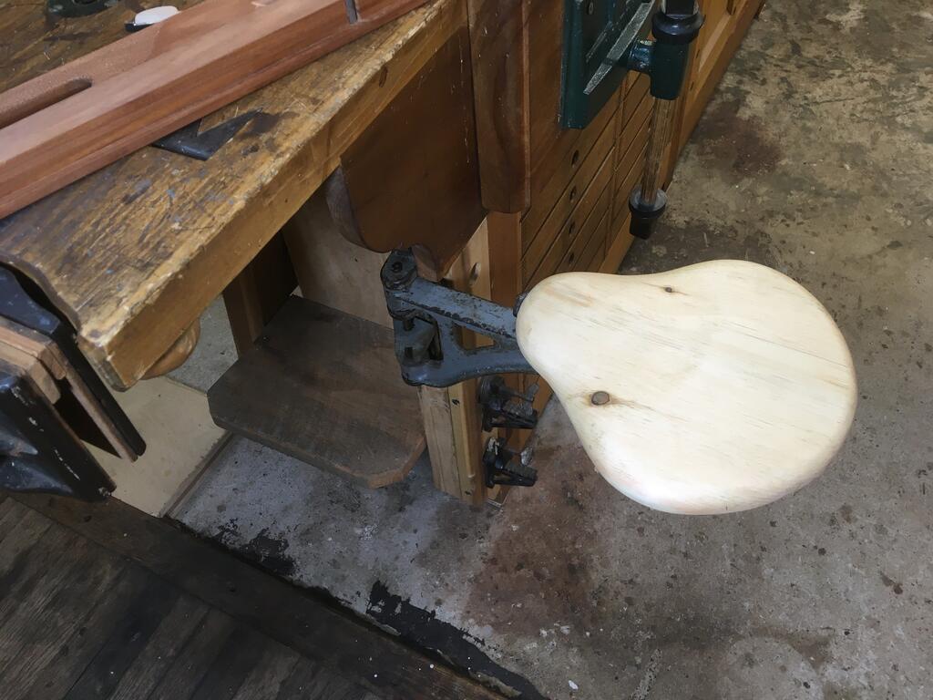

formariz 12,381 #1 Posted October 17, 2020 (edited) My bench is the most important tool I have. Much of work I do involves long hours of tedious detailed work on it constantly in one spot such as when carving. That work requires that I have my upper body pretty much close and above work for leverage and control over the tools being used. Standing causes me to bend my back inevitably which is tough on it. Many times I merely lean my left hip on bench side at an angle in order to achieve the right position but that is also tough on the body. The best thing for those times is to sit, but for that I need at least one leg to be underneath bench so I can have my body directly above work. That is only possible in two areas of bench at the ends, specifically the left side since I am right handed.So I have for a long time been looking for an industrial swing out stool bracket. Not only they are rare, but also come at a premium. Finally scored one that did not cause me to put a mortgage on the house. It now makes my life so much easier, mounted on the perfect spot even allowing me to swing my body substantially over the work for better angles. Did have to be creative relocating the Emmert's tilt mechanism to allow bench to swing totally out of way, and machining a new stiffer rod for it will have to be done eventually. Finally also made a custom seat for my ever expanding behind. Edited October 17, 2020 by formariz 3 8 1 Share this post Link to post Share on other sites

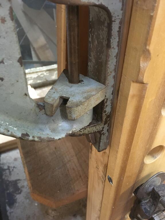

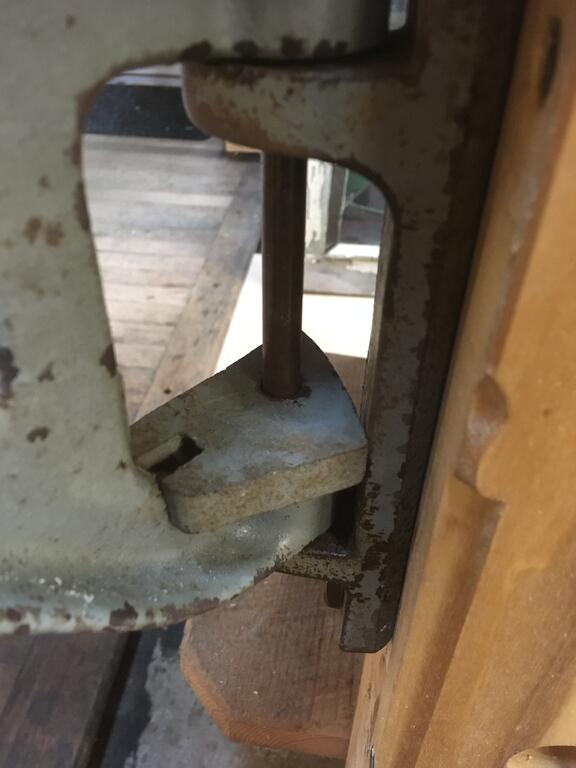

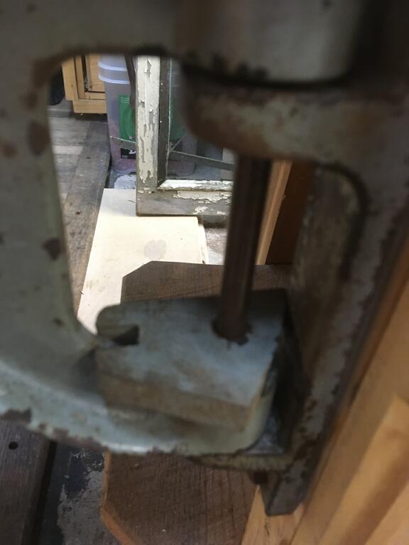

oliver2-44 11,663 #2 Posted October 17, 2020 Isn't it amazing how many old ideas were so utilitarian, but so clever and useful forever. @formariz is the small metal piece on the vertical hinge pin some sort of position lock. How does it work? rod also I noticed your bench sits on concrete. But you have a wood floor around the bench. Is the wood floor there to help ease your feet for long days on them. Share this post Link to post Share on other sites
formariz 12,381 #3 Posted October 17, 2020 (edited) 1 hour ago, oliver2-44 said: is the small metal piece on the vertical hinge pin some sort of position lock. How does it work? rod Yes it is a stop. I keep it up so it will not work and seat swings 180 degrees. When down it stops bracket from swinging past certain points. It has like three different options as where it will stop it. Odd looking but pretty clever. 1 hour ago, oliver2-44 said: also I noticed your bench sits on concrete. But you have a wood floor around the bench. Is the wood floor there to help ease your feet for long days on them. Shop is a two car garage part of house. When I first moved here in 1983 I had to compromise with wife since she insisted that she had to put her car in garage. So with the exception of that area for one car the entire garage has oak flooring. I don't think car actually made it into garage more than six times that specific year. She got tired of it, so gradually I took the whole thing over. At the time I used another bench that I made here much smaller. A Scandinavian type cabinet makers bench which I quickly outgrew. When this bench was made this is the only area it fits in since its 13 feet long. Never did have time to complete flooring that is why it is sitting on concrete.It won't be for long now. I already got the modular floor squares with the plastic insulation underneath for it. I will have to jack up the bench one side each time and place flooring underneath Edited October 17, 2020 by formariz 2 Share this post Link to post Share on other sites
SylvanLakeWH 32,023 #4 Posted October 17, 2020 Perfect application! Wonder why so rare? Seems like it would be an optional feature on work benches all over, or at least an add on... Share this post Link to post Share on other sites
formariz 12,381 #5 Posted October 17, 2020 5 hours ago, SylvanLakeWH said: Perfect application! Wonder why so rare? Seems like it would be an optional feature on work benches all over, or at least an add on... From my constant looking for them over the years it seems to me that even in their time they were not that common. One finds them sometimes attached to laboratory and drafting tables. Places where when not in use, a regular chair or stool would just be in the way. Any piece of furniture today found with one or more attached commands anywhere from one to several thousand dollars depending on how many they have. I am sure that at the time they were not that expensive to add on but today due to their scarcity and the fact that they are labeled as " vintage industrial" their pricing is just ridiculous. Ordinarily this one with just the bracket and no seat would go on average anywhere from close to $200.00 to as much as $350.00. I found it by accident since it was really not listed 100% correctly. Asking price was $125.00 plus $30.00 shipping. Listing was within a few hours of ending with about 12 watchers. Made seller an offer of $90.00 just for the heck of it and almost immediately was excepted. Really lucked out on it. He even refunded me $3.75 for the shipping the following day. 1 1 Share this post Link to post Share on other sites

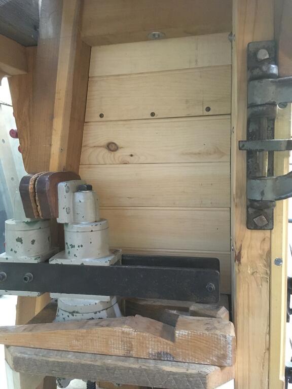

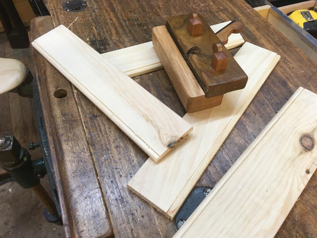

formariz 12,381 #7 Posted October 17, 2020 (edited) Felt bad looking at these photos realizing I never "dressed" underneath of bench at this end so quickly remedied it re sawing some thin boards , planing a few beads and finally hiding the uglies. Edited October 17, 2020 by formariz 1 Share this post Link to post Share on other sites
