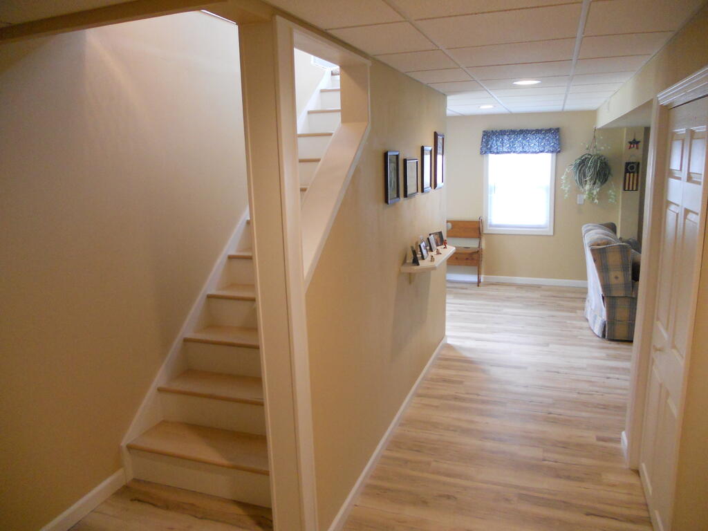

rmaynard 17,496 #13 Posted October 11, 2020 My experience is that the "consumer" based products like Minwax, Rustoleum, Valspar, and others are okay...but they are not nearly as good as commercial products. I finished my steps with a product from Van Technologies called Green Light Coatings. It is a waterborne urethane topcoat. Steps are areas of extreme wear. Walking in from the outside, unless you always remove your shoes, outside grit and dirt come in on the bottoms of your shoes and is very abrasive. More force is put on steps than on a floor. My steps have not shown any wear after more than five years, even on the front edges. Having said that, as always I recommend using appropriate breathing protection if spraying. Rolling or spreading with a pad produces less misting. Adequate ventilation is always advised. 2 Share this post Link to post Share on other sites

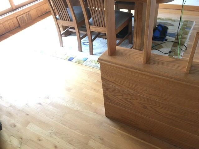

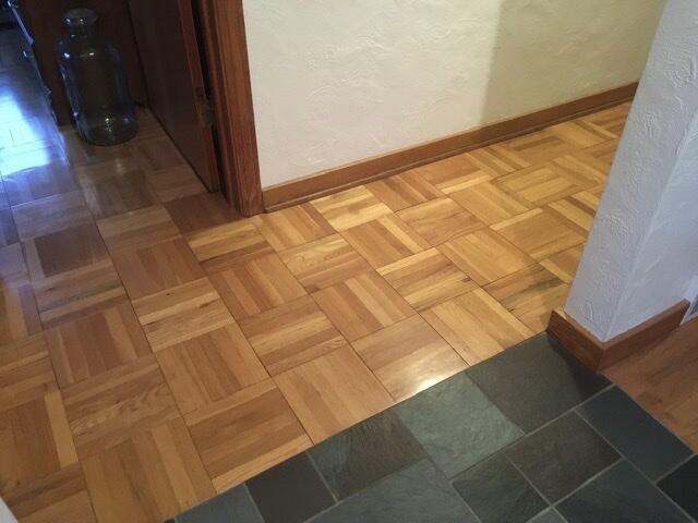

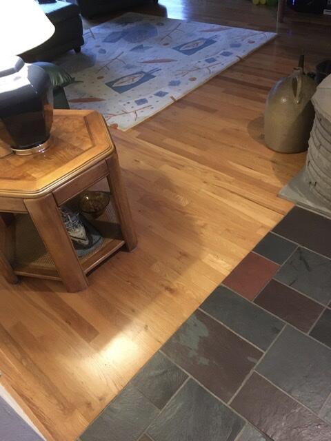

tom2p 2,396 #20 Posted October 11, 2020 (edited) 22 hours ago, The Tuul Crib said: Have you ever tried vera thane? not sure if that's the correct spelling of my experience with it is extremely durable. I would put it on my kitchen table. I helped my dad install and finish wood floors when I was a kid - and also refinished the wood floors in our house I used Varathane - recommended by a number of people in the business refinished strip floor in the living room, dining room, hall - parquet in the bedrooms ( also refinished oak on the walls ) three coats on the strip floor on the living room, dining room, and hall - five coats on the parquet floor on the hall and bedrooms turned out very well - but I don't think I would tackle this job again it's especially a hassle when applying multiple coats ; after screening (which can be amusing if you are not familiar with operating a floor buffer) - you gotta (again) vacuum thoroughly and tack before applying the next coat ... and can be a challenge to determine the coverage when applying the subsequent layers and of course gotta know what you are doing with a drum sander - or you can destroy the floor ( if they still use this stuff ) Edited October 11, 2020 by tom2p Share this post Link to post Share on other sites
