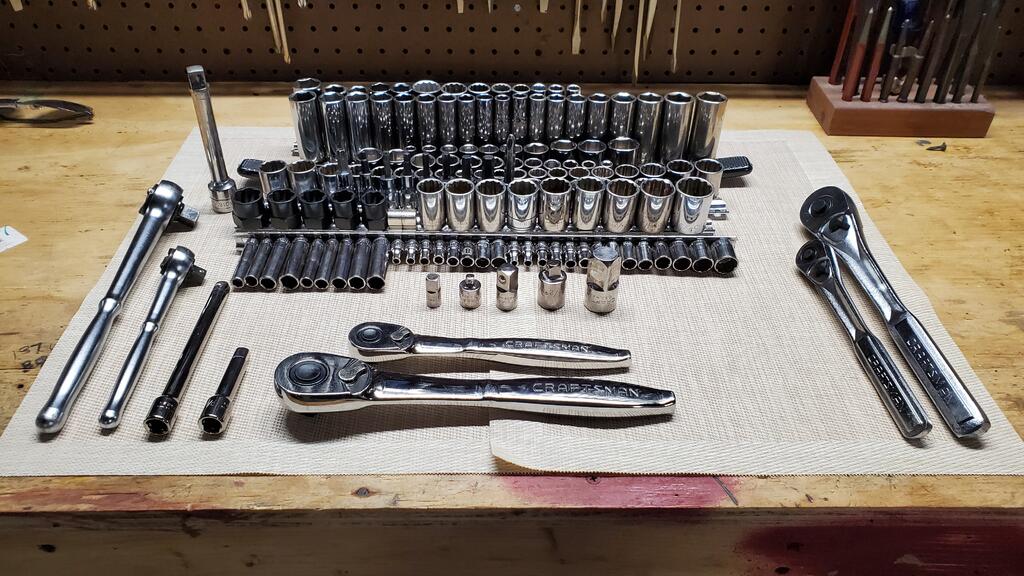

bds1984 1,516 #17 Posted October 14, 2020 Here is SOME of the tools in my set. All USA made except for the Gear Wrenches. I suppose it was a good thing that I was collecting tools since my early teenage years. The 6-point sockets and two ratchets in the center is what I added to my arsenal. I have a ton of extras that I'll be glad to part with! 1 2 Share this post Link to post Share on other sites
