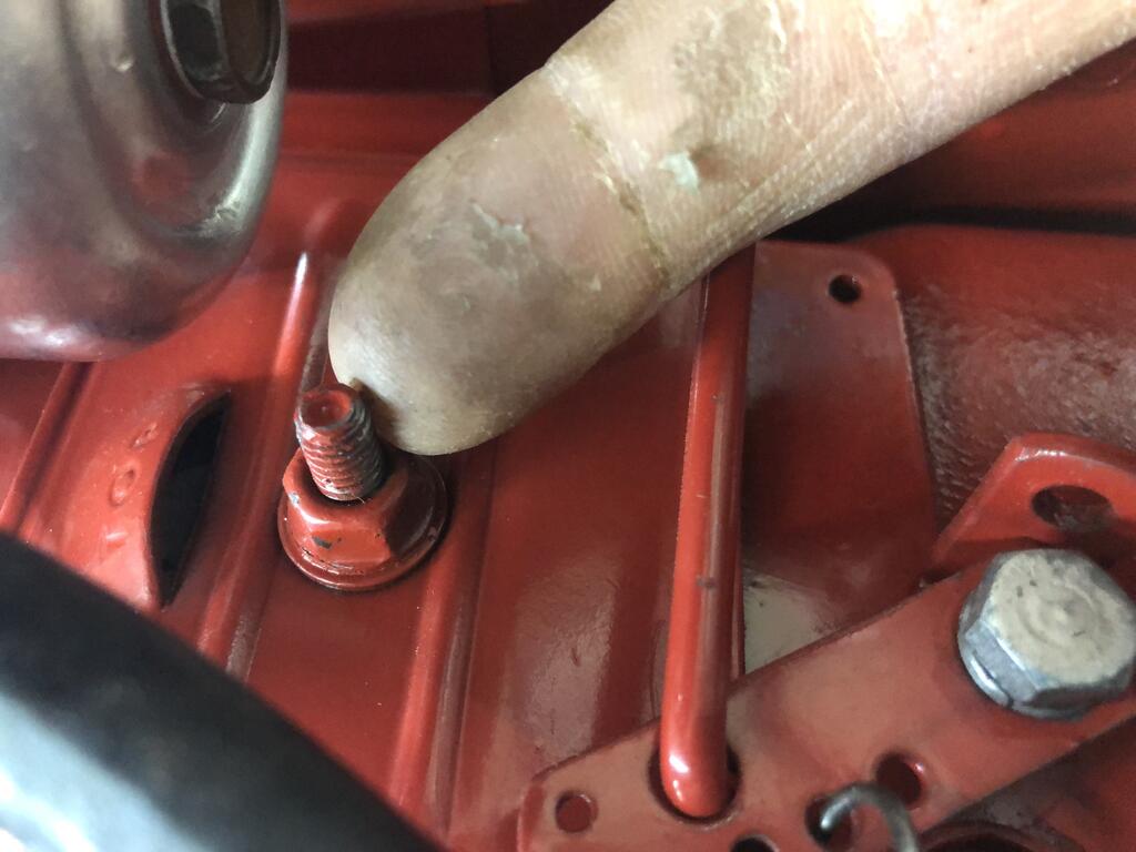

The Tuul Crib 7,354 #1 Posted October 7, 2020 Well I had to ask but I'm looking for the nut that goes on this boat for the throttle. Sorry for the ugly picture of the finger but it is politically correct. Anyway it's approximately five eights of an inch long with all thread on the inside. I don't know a part number unless somebody knows someone who has one. I thought I had one no go! Share this post Link to post Share on other sites
WHX?? 56,846 #2 Posted October 7, 2020 (edited) We workin on boats here now Cribs? Looks to me like the breather cover on a K series? If so maybe what you are looking for is a all thread coupler nut in 1/4-20. Any hardware store. It just extends the breather cover stud out to a female thread so the throttle cable hooby doo can be fastened to it. Be warned tho engine will never run laying on it's side like that! Edited October 7, 2020 by WHX24 3 Share this post Link to post Share on other sites
The Tuul Crib 7,354 #3 Posted October 7, 2020 56 minutes ago, WHX24 said: We workin on boats here now Cribs? Looks to me like the breather cover on a K series? If so maybe what you are looking for is a all thread coupler nut in 1/4-20. Any hardware store. It just extends the breather cover stud out to a female thread so the throttle cable hooby doo can be fastened to it. Be warned tho engine will never run laying on it's side like that! Keeps ya sharp cuz! 1 Share this post Link to post Share on other sites

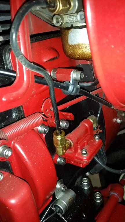

WHX?? 56,846 #5 Posted October 7, 2020 Here ya go Cribs ....don't say I never did nothin for ya! 6 1 Share this post Link to post Share on other sites

squonk 46,840 #8 Posted October 7, 2020 9 hours ago, WHX24 said: Here ya go Cribs ....don't say I never did nothin for ya! Gungey carb bowl! Share this post Link to post Share on other sites
WHX?? 56,846 #9 Posted October 7, 2020 1 hour ago, squonk said: Gungey carb bowl! She'a a worker! Share this post Link to post Share on other sites
peter lena 9,899 #10 Posted October 7, 2020 hardware store, HILMAN FASTNER CENTER , pete 1 Share this post Link to post Share on other sites
roadapples 6,987 #11 Posted October 7, 2020 4 hours ago, WHX24 said: She'a a worker! And all you need is an Allen wrench.... 1 Share this post Link to post Share on other sites
WHX?? 56,846 #12 Posted October 7, 2020 (edited) Was wondering when someone was going to chime in about that 'Apples! Figured it would be Skunk with a snide comment but yeah he's looking at the beachball too. It's only gungy on the outside Mike... I run a clean ship........sometimes! I ever mention my fetish for stainless AND allen heads! Guess we found the nut..... I had to run out at nite to the shed in my knickers to snap that pic.... how's that for a mental picture! Blame it on @Racinbob he taught me the bad habit of running out to the shed for a pic! Edited October 7, 2020 by WHX24 3 Share this post Link to post Share on other sites
