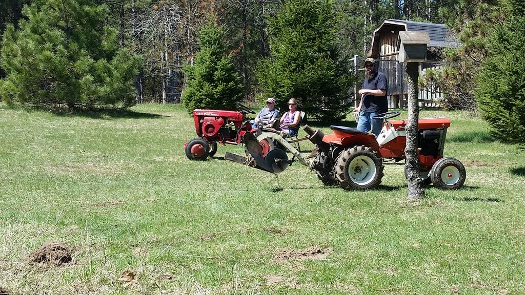

WHX?? 57,942 #9 Posted October 6, 2020 One of Dan and my buddies has one set up for plowing and it does well. 4 1 Share this post Link to post Share on other sites

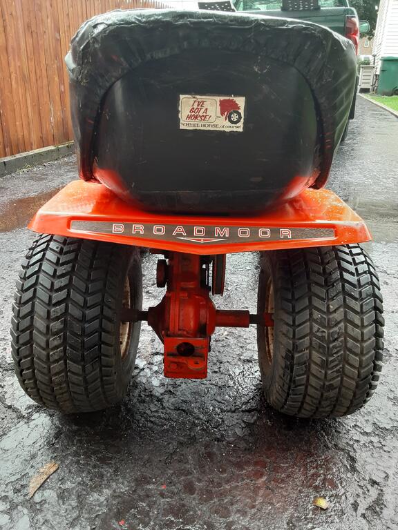

D_Mac 9,339 #12 Posted October 8, 2020 I put a Wheel Horse seat on my " ole Broad " . Didnt help, once you sit down on it you can tell it isnt a Wheel Horse ! 1 Share this post Link to post Share on other sites
