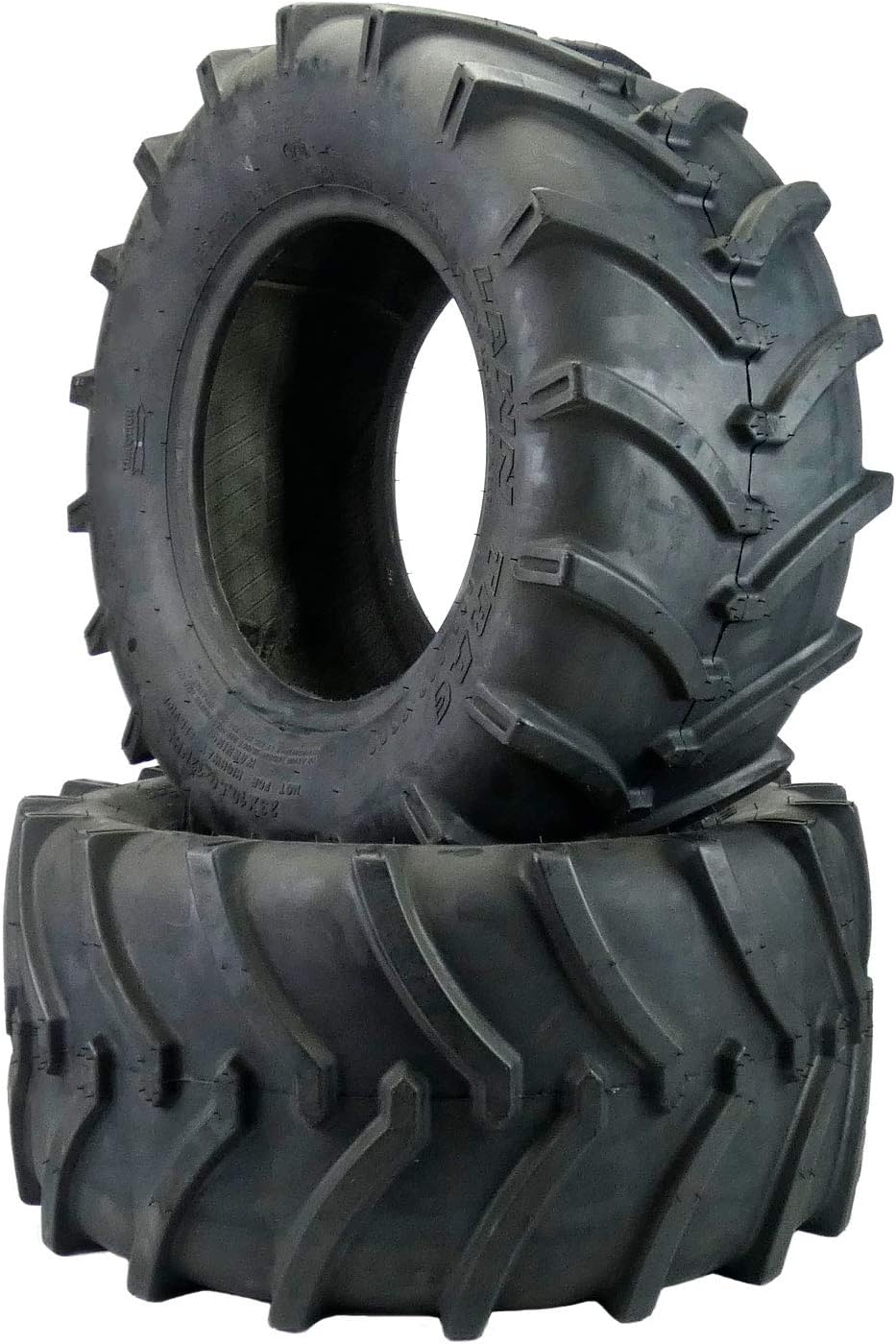

DennisThornton 4,773 #28 Posted December 8, 2020 This about as good as it gets for traction and price? https://www.amazon.com/23X10-50-12-23X1050-12-OTR-Tires-Rated/dp/B01MQJP3N0/ref=sr_1_25?dchild=1&keywords=OTR+HBR+Lawn+Trac+23+x+10.5-12&qid=1607454690&s=automotive&sr=1-25 1 Share this post Link to post Share on other sites
DennisThornton 4,773 #29 Posted December 8, 2020 Or: https://www.amazon.com/MaxAuto-23x10-50-12-Garden-Tractor-Riding/dp/B07FNBF662/ref=redir_mobile_desktop?ie=UTF8&aaxitk=tmwr4l2tE9O.rPLPdXFsjw&hsa_cr_id=6477673400801&ref_=sbx_be_s_sparkle_mcd_asin_0 1 Share this post Link to post Share on other sites
ebinmaine 79,059 #30 Posted December 8, 2020 @DennisThornton. @WVHillbilly520H Jeff has been using the first one, OTRs. I'll let him chime in but I get the impression he's been very impressed. I don't have personal experience with them but reading some about them there is a good indication that the difference in angle of the center tread helps traction. Share this post Link to post Share on other sites
DennisThornton 4,773 #31 Posted December 8, 2020 I searched the site and read through all of this thread and I gather Jeff is fond of the OTRs. Thought maybe I could revive this topic. If I'm really needing traction then the TC35 with it's industrial tires comes out and as a result I don't own any ag tires! I'm starting to see that as a character flaw that perhaps I could correct. Share this post Link to post Share on other sites

WVHillbilly520H 10,378 #34 Posted December 9, 2020 (edited) 6 hours ago, DennisThornton said: I searched the site and read through all of this thread and I gather Jeff is fond of the OTRs. Thought maybe I could revive this topic. If I'm really needing traction then the TC35 with it's industrial tires comes out and as a result I don't own any ag tires! I'm starting to see that as a character flaw that perhaps I could correct. Dennis here is a thread I stated long ago starting with Deestone style AGs and ending up on the OTR and yes for my money I am very impressed so far as @WHX24 for use on a "plow mule", myself on steep sloping grass , gardening in clay soil, and snow removal plow/blower liquid filled with iron weights here to report NO need of chains as of yet (ice may be the the only downfall to come) ... I'll let you be the judge from my experiences. Also let me say I do believe the Carlisle TruPower are an excellent choice as well but comes at a bit higher price, then there's the Firestone 23° but yet again pay a premium too. Edited December 9, 2020 by WVHillbilly520H 1 1 1 Share this post Link to post Share on other sites

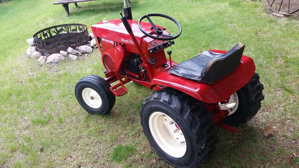

Horse Newbie 7,404 #43 Posted December 10, 2020 (edited) Don't know why this site repeated what I said farther up the thread when I tried to leave this comment, and I hate to be sliding (get it?) off topic , but I'm gonna paint my wheels like @cschannuth...white, then add my hub caps which I am also gonna have powder coated. See how much snow we get... I have to veer off topic to comment Edited December 10, 2020 by Horse Newbie 1 1 Share this post Link to post Share on other sites
