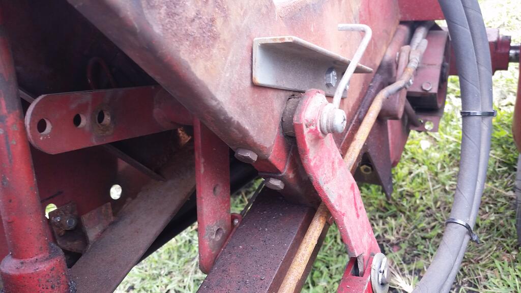

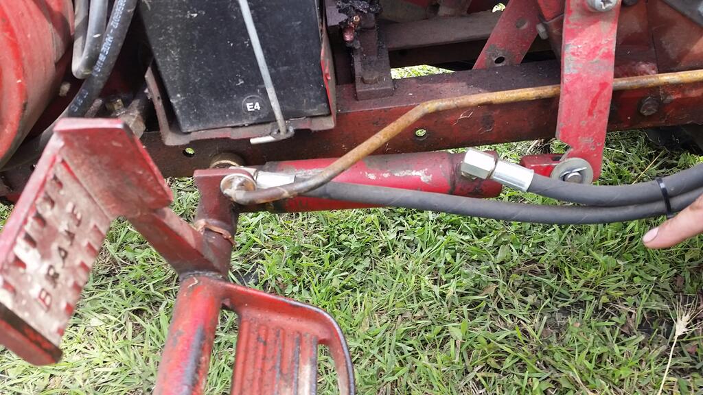

WHX?? 57,322 #27 Posted October 13, 2020 From pics of that tractor. I got that same rockshaft off Dan's parts C-160 I am going to fit on a Raider 12 for hydraulics. I was going to ditch the pointer or do you use it? Guessing you had to custom bend the clutch rod? I was thinking of going to the outside of the cylinder and arm. Share this post Link to post Share on other sites
prondzy 3,889 #28 Posted October 13, 2020 Yes custom clutch rod Jim, yes i keep the pointer is hard to judge plow depth with it in the dirt Share this post Link to post Share on other sites

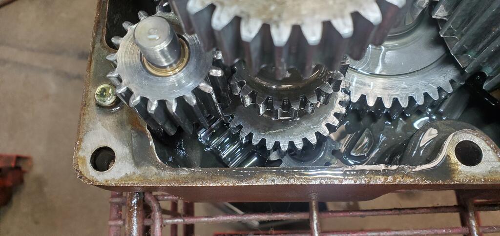

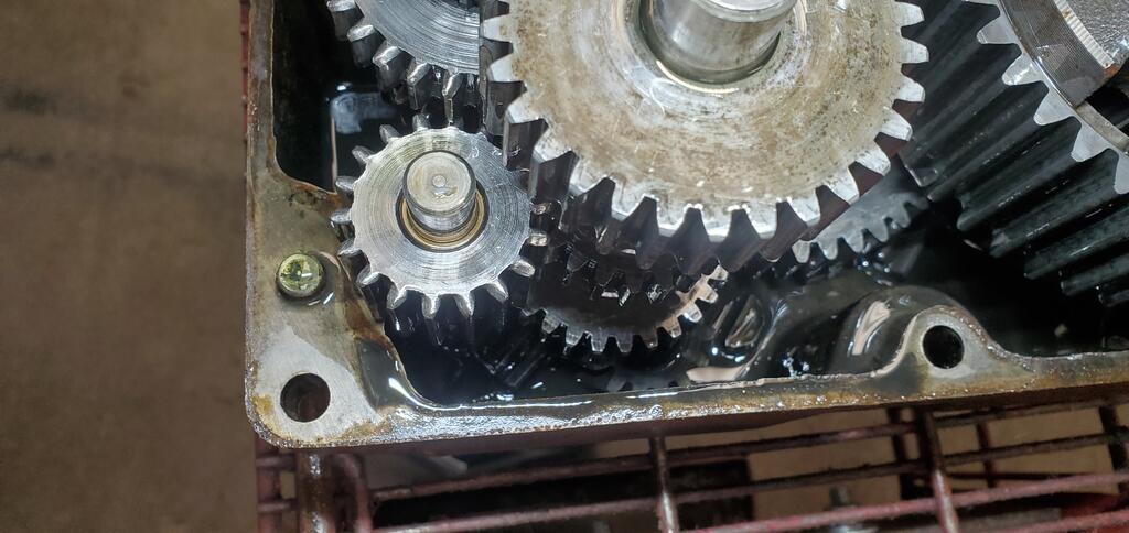

Shynon 7,604 #30 Posted October 6, 2021 (edited) Well finally pulled trans from the 1054 torn apart. Not a day too soon. And oh my broke the same gear as @prondzy, going back together good as new. Let's turn some dirt @pullstart @Achto @WHX?? Edited October 6, 2021 by Shynon 5 Share this post Link to post Share on other sites
Pullstart 70,513 #31 Posted October 6, 2021 Tom does that still have the bevel gear diff? Share this post Link to post Share on other sites
Shynon 7,604 #32 Posted October 6, 2021 6 minutes ago, pullstart said: Tom does that still have the bevel gear diff? Nope, I changed it out for an 8 pinion 1 Share this post Link to post Share on other sites
WHX?? 57,322 #33 Posted October 6, 2021 (edited) Rest of it looks good. Wonder why she went? I haven't researched it yet but ain't that the same gear as the other trannies? Never mind looked back and Dino says same gear used in all the trannies. Edited October 7, 2021 by WHX?? Share this post Link to post Share on other sites
Shynon 7,604 #34 Posted October 7, 2021 (edited) 17 hours ago, WHX?? said: Wonder why she went? I haven't researched it yet but ain't that the same gear as the other trannies? Same gear @prondzy broke, It broke right at the key way Edited October 7, 2021 by Shynon Share this post Link to post Share on other sites
