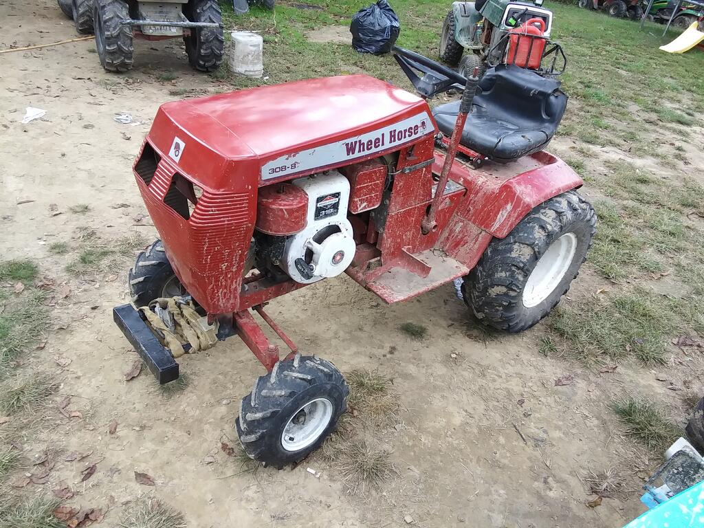

TractorChild97 158 #1 Posted October 3, 2020 I recently got the 308 up and running with some 80w 90 oil replacing the old nasty oil in the tranny. I have been using it around the prpperty for about a week now and I noticed the left axle has a slow drip. Overnight there was a small puddle under the axle. I found some seals on eBay but all they say is 1" Toro wheel horse axle seals and I'm not 100% sure if thats the right seal. Sorry for the ancient axle seal question. I dont intend to keep the forum repetitive. Thanks for any help guys. And the model number and id number was gone before I got the tractor so sorry I cant help there. Share this post Link to post Share on other sites

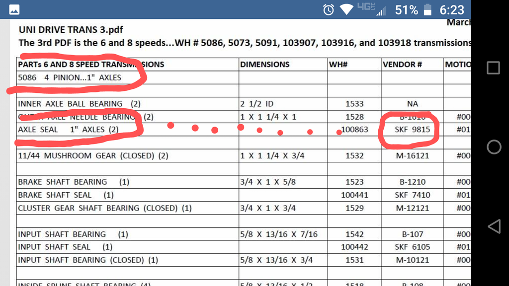

pfrederi 21,189 #2 Posted October 3, 2020 Check out the pinned topic top of this forum. Bearing and seal cross reference You want SKF 9815 2 1 Share this post Link to post Share on other sites
TractorChild97 158 #3 Posted October 3, 2020 I honestly dont understand how to use that chart to help me find the seals I need. Can I possibly get a link leading to the seals? Share this post Link to post Share on other sites

ebinmaine 80,772 #7 Posted October 3, 2020 1 hour ago, TractorChild97 said: I honestly dont understand how to use that chart to help me find the seals I need. Can I possibly get a link leading to the seals? There isn't really a link because the seals you need are right in the front page. You have a 308-8 of unknown model. But you DO know you have 1" axles. Easy to find the ones you need. Look at the pdf charts on the page. Scroll down to the 3rd chart which shows info for 6 and 8 speed transmissions. The top half of that chart is for 1" axles as seen in the text. 3 Share this post Link to post Share on other sites

TractorChild97 158 #10 Posted October 4, 2020 2 hours ago, ebinmaine said: There isn't really a link because the seals you need are right in the front page. You have a 308-8 of unknown model. But you DO know you have 1" axles. Easy to find the ones you need. Look at the pdf charts on the page. Scroll down to the 3rd chart which shows info for 6 and 8 speed transmissions. The top half of that chart is for 1" axles as seen in the text. Okay thanks! So I can search the vendor number to find the seals I need? Or just search for 1inch axle seals for my model wheel horse? I dont mean to annoy yall, I just have no idea how to find this. I am not even that familiar with the internet in general. 1 Share this post Link to post Share on other sites
TractorChild97 158 #11 Posted October 4, 2020 Guys I apologize. I didnt see the website link right in front of me. 1 Share this post Link to post Share on other sites
ebinmaine 80,772 #12 Posted October 4, 2020 10 hours ago, TractorChild97 said: Okay thanks! So I can search the vendor number to find the seals I need? Or just search for 1inch axle seals for my model wheel horse? I dont mean to annoy yall, I just have no idea how to find this. I am not even that familiar with the internet in general. Search by Skf 9815 and you'll find a bunch for sale. It's a very popular number for many applications. Fleabay has them as low as $7 something each, shipped. One thing to consider is that the hubs of your tractor can be a real @#$_&-+()/ to remove. Take out your set screws and start applying your favorite penetrating fluid. TODAY. Should be 2 screws on each axle hub. Do NOT use a 3 jaw puller. Best to use an old hub to set up a proper 5 bolt puller. There are threads on here that show pics. @953 nut might have a pic handy of one using a jack. Be patient with it !!! It took 35 years to freeze in place and it likely won't move in just a few minutes. Heat is your friend. It's an easy enough job. Just. Be. Patient. 1 Share this post Link to post Share on other sites

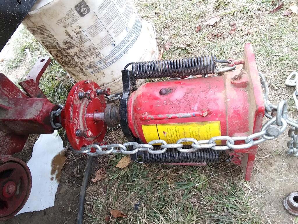

953 nut 69,571 #14 Posted October 4, 2020 11 hours ago, ebinmaine said: There are threads on here that show pics. @953 nut might have a pic handy of one using a jack. 1 1 1 Share this post Link to post Share on other sites
TractorChild97 158 #16 Posted October 4, 2020 I think I'm going to try to make something like 953 nut posted. I applied a small amount of pressure with my jack and added some oil on the hub. I just left it that way, I'm going to pick up some pb blaster and spray it down. I actually dont have a torch so I'm gonna have to wait it out I reckon. Share this post Link to post Share on other sites

ebinmaine 80,772 #18 Posted October 4, 2020 I respectfully disagree with the PB. I've not had good luck with it and stopped using it. Wd-40 company makes a decent penetrating oil. (NOT traditional wd-40). Good old Liquid Wrench old formula is also excellent. Kroil is very good but pricey. Search atf and acetone as a combo. Never tried it but I understand it works well. Richard @953 nut has recommended (parafin??). 1 Share this post Link to post Share on other sites
ebinmaine 80,772 #19 Posted October 4, 2020 I'd HIGHLY recommend using the 5 bolt setup as seen above. Your jack is awesome and will give you a great advantage. But pulling on only 2 or 3 points is asking for trouble with cast iron. 1 Share this post Link to post Share on other sites
TractorChild97 158 #20 Posted October 4, 2020 5 minutes ago, ebinmaine said: I respectfully disagree with the PB. I've not had good luck with it and stopped using it. Wd-40 company makes a decent penetrating oil. (NOT traditional wd-40). Good old Liquid Wrench old formula is also excellent. Kroil is very good but pricey. Search atf and acetone as a combo. Never tried it but I understand it works well. Richard @953 nut has recommended (parafin??). Iv never heard of these. I'll give pb a try and if I have no luck I'll definitely check some of those out. About how long should I wait in between pulls and spraying some penetration oils? Share this post Link to post Share on other sites
TractorChild97 158 #21 Posted October 4, 2020 10 minutes ago, ebinmaine said: I'd HIGHLY recommend using the 5 bolt setup as seen above. Your jack is awesome and will give you a great advantage. But pulling on only 2 or 3 points is asking for trouble with cast iron. Thank you its a jack that hooks up to an air compressor. It aint been used all that much so I'm gonna play it safe and do it by hand. Honestly I'll probably just use the jack to add some pressure while I make the 5 lug puller. Share this post Link to post Share on other sites
