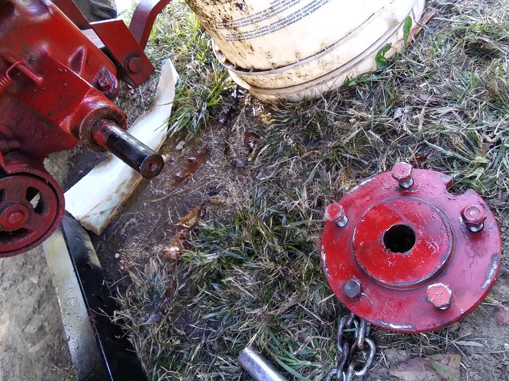

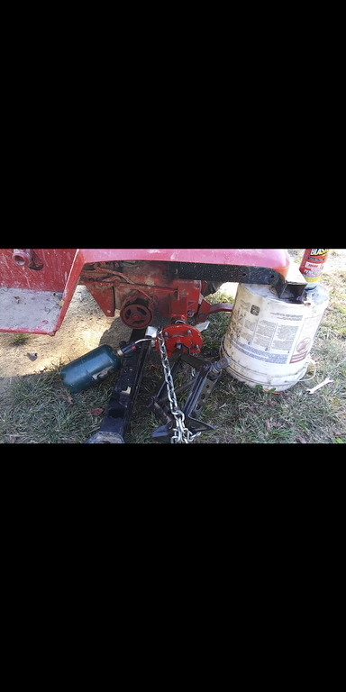

TractorChild97 158 #38 Posted October 5, 2020 So I finally got the hub off. At one point it had alot of pressure and popped almost 3/4 of the way off. After that it was still kinda tough. It honestly didnt take as much force as I thought but it was 100% stuck! It took me about 2 hours from start to finish. Heat, pb blaster and patience. I should probably try to take the other side off and replace the seal as well. If one goes bad its only a matter of time before the next goes bad right? 1 1 Share this post Link to post Share on other sites
ebinmaine 80,126 #39 Posted October 5, 2020 1 hour ago, TractorChild97 said: should probably try to take the other side off and replace the seal as well. If one goes bad its only a matter of time before the next goes bad right VERY nice work getting that hub removed. There are 4 seals on a manual transmission. 2 axle. Brake drum shaft. Drive input shaft. Not a terrible idea to replace all four. Don't forget to apply Nevercease or something to the axles as you reinstall. 1 1 Share this post Link to post Share on other sites
