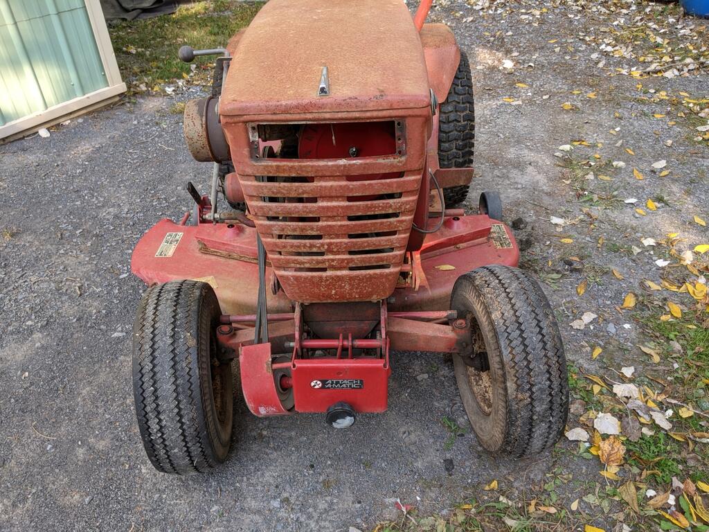

rjg854 13,422 #1 Posted September 27, 2020 The guy I got it from is a repairman that got it from the owner. It's got a broken rod, so he was going to scrap it. So I figured it's got many good parts on it so why not part it out. Better than going to the big corral in the sky. 8 5 1 Share this post Link to post Share on other sites

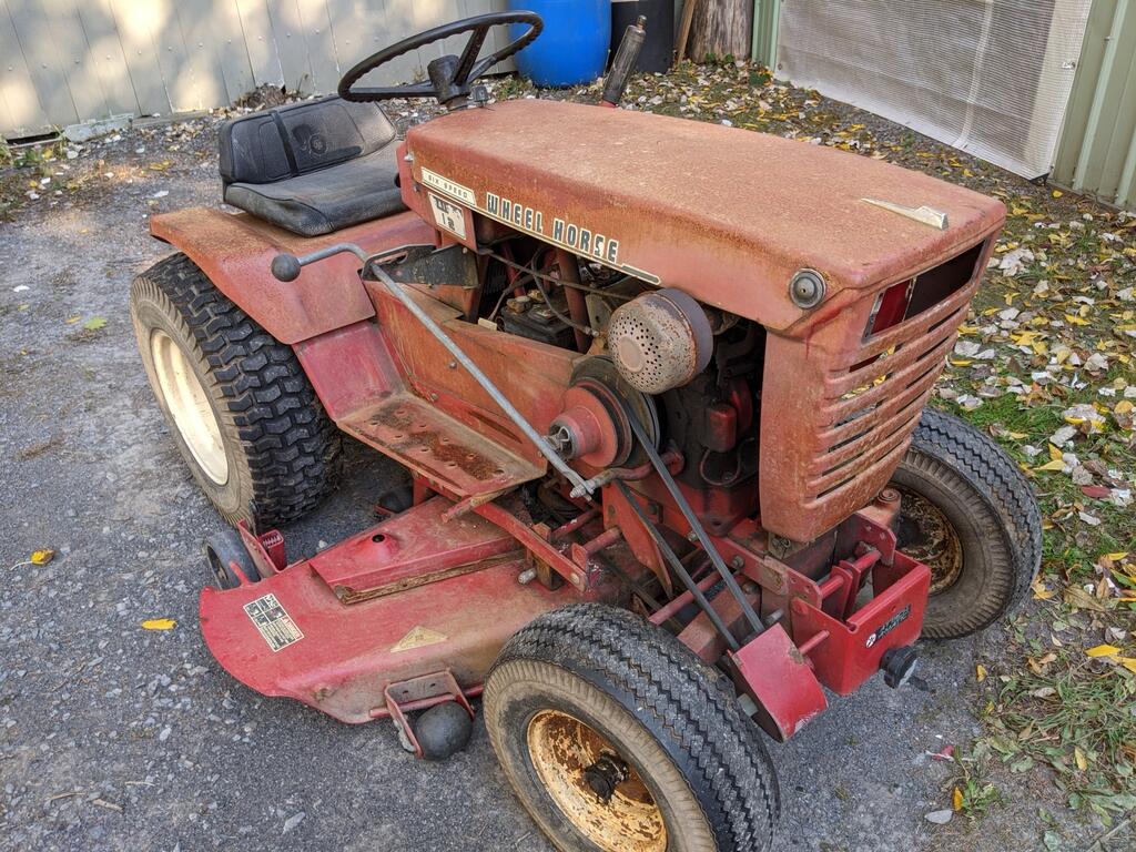

ZXT 2,402 #2 Posted September 27, 2020 Looks like a good tractor that needs an ignition switch and a used engine thrown on it.. No way it would be getting parted out at my house! It's in better shape than a lot of mine Have you confirmed that it actually has a broken rod? 3 Share this post Link to post Share on other sites
rjg854 13,422 #3 Posted September 27, 2020 The repairman gave me the ignition switch, that's how I found the tractor. No I haven't determined if the rod is broken I was taking his word on that. I've been looking around for an engine and will probably sit on it for a while before I actually do anything else. I'd like to find an engine and get it going again. Time will tell. 5 2 Share this post Link to post Share on other sites

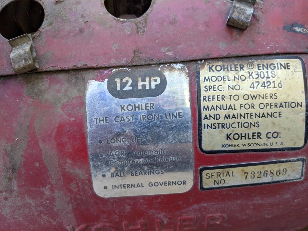

ebinmaine 81,153 #10 Posted September 28, 2020 The advantage you have here is that a ton of 10 horse and up Kohler engines would be a direct bolt in. Taking the head off is fairly straightforward. Remove outer sheet metal and there will be 8 or 9(?) Head bolts. Does the engine turn with the key at all? If so an easy quick check would be to remove the spark plug and turn the engine. If you hear no stroke differences while turning then further research is warranted. 1 Share this post Link to post Share on other sites

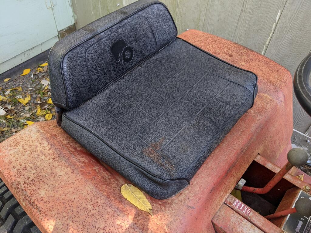

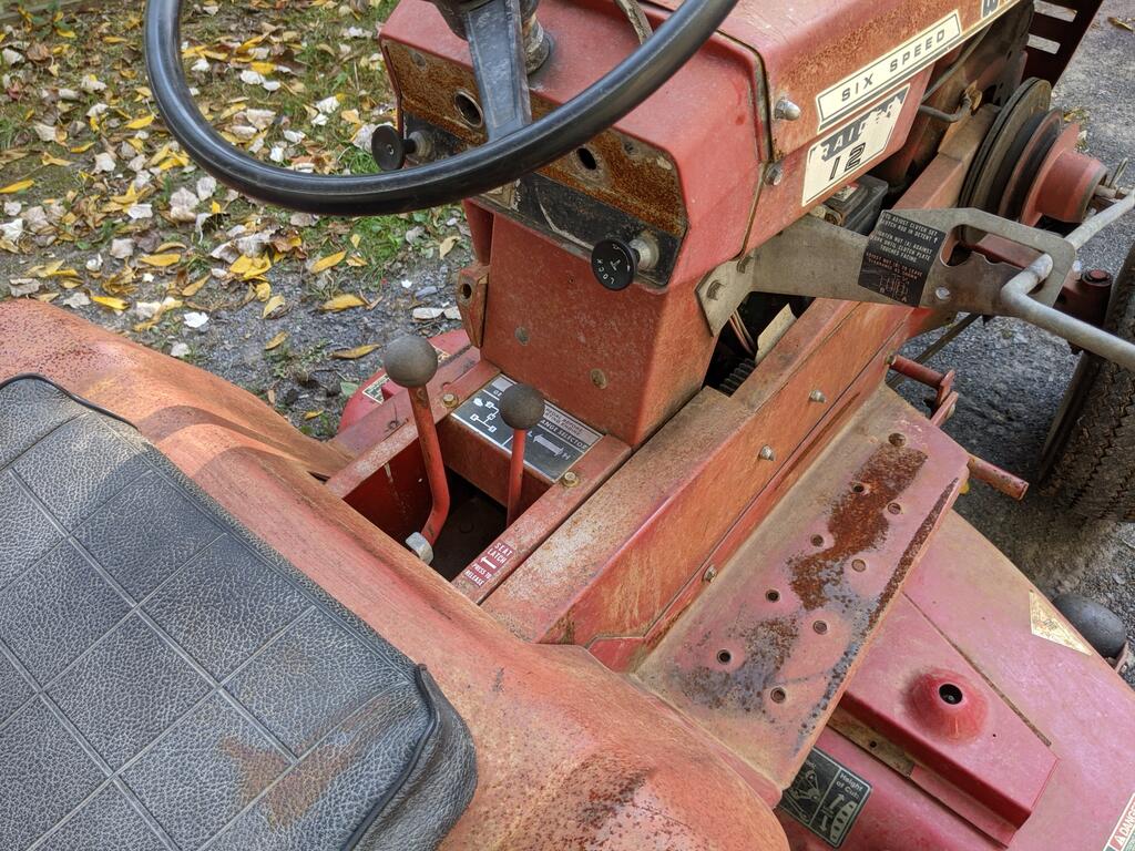

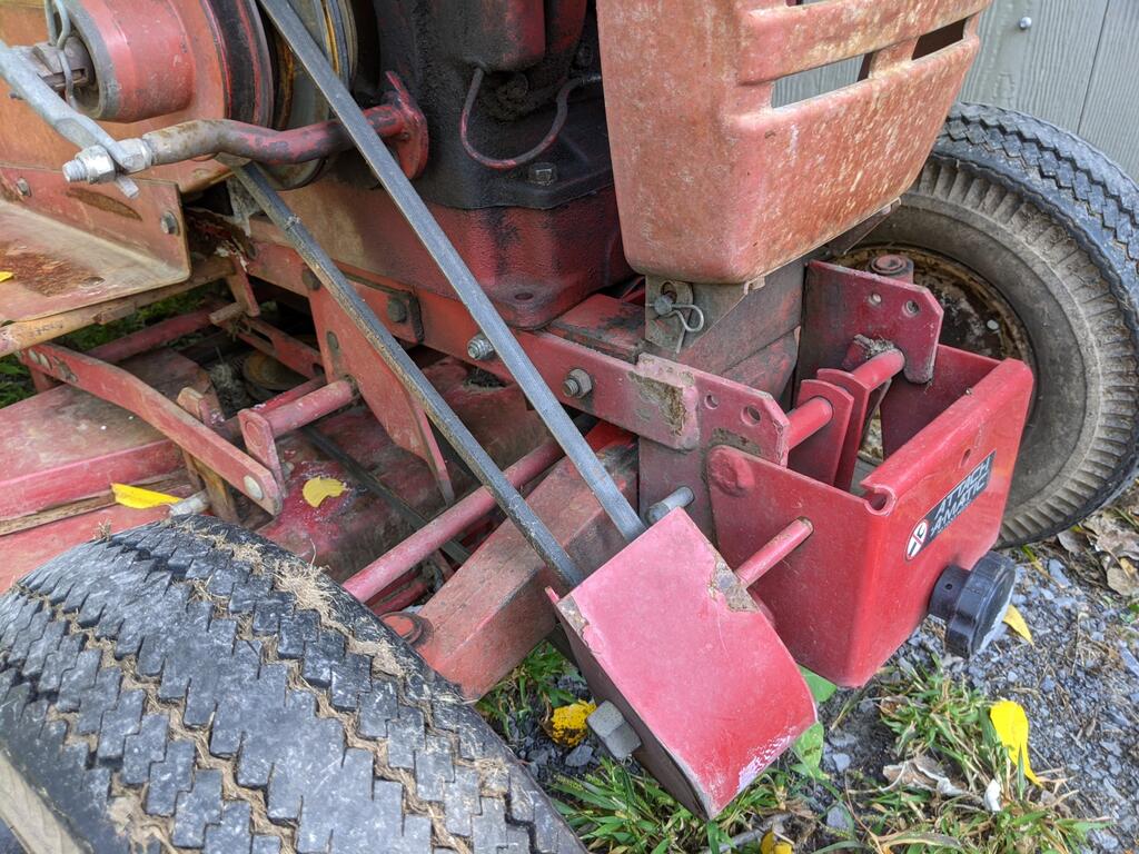

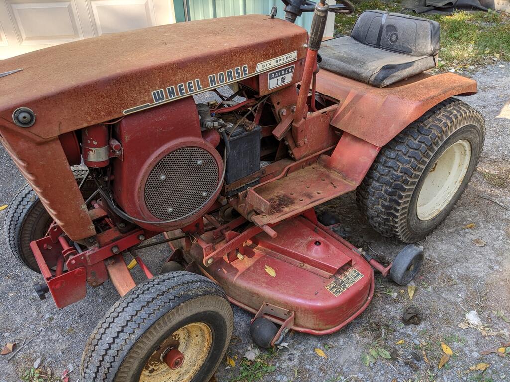

rjg854 13,422 #18 Posted September 28, 2020 The hood stand on the left side of the tractor is crack straight through, but that could possibly be welded up. Pretty much after going through things it's basically unmolested, and mostly complete. Tranny oil of course needs changed bad and needs a boot cover. Oil in the engine barely reached the stick. It needs a thorough cleaning and degreasing, just to be able to work on it. It appears to have not been that well maintained. But the wheels and tires are in really nice shape and are original branded tires. Mower deck is a later model with a mule drive conversion. Blades spin nicely and there's no drag or noises to the deck spinning it by hand. Even the seat doesn't have and tears and still has cushion in it. Tie rods are pretty much shot, so there's lots of slop to the wheel. Those are the obvious things so far with a once over. I am trying to find an engine first, but that may take some time. I don't want to put much into it until and if I can find an engine. As far as I'm concerned it can sit here till next Spring to give me the time for a search. The dealers tags shows it was sold in Watkins Glen NY, maybe 40 miles from me. 1 Share this post Link to post Share on other sites
ebinmaine 81,153 #19 Posted September 28, 2020 Well for 50 bucks you done all right. Just the bracket alone on that mule drive conversion is worth that. If the seat is really in decent shape that's worth $150 or more to some people. Transmission? I've seen those go anywhere for $125 up to $200. As far as a WORKING tractor goes, those are very very tough to beat. 12 Horse is enough to do most any task and the Limited Slip really adds A LOT to the capabilities. I've seen it demonstrated first hand with the comparison between my own Cinnamon Horse which does not have LSD versus Trina's 867 that does. Her and her tractor combined weighs several hundred pounds less than me on mine and she has better winter and mud traction than I do. 1 Share this post Link to post Share on other sites

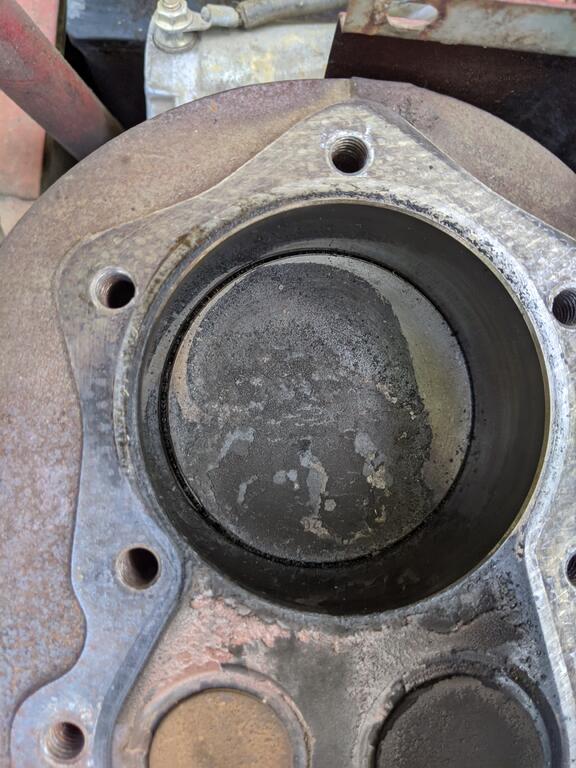

rjg854 13,422 #22 Posted September 28, 2020 1 hour ago, johnnymag3 said: I have a K12 engine, under 100 Hours. 12 hp. Im 1 Hour south of Albany... PM if you have a need for a nice Kohler for it..!! That's a saver for sure That sure is a great offer, I'm 2 hours West of Albany. This is what I found when I pulled the head He must have been in there because the bolts were loose. The bore "looks" good but I know it has to be miced. 1 Share this post Link to post Share on other sites
ebinmaine 81,153 #24 Posted September 28, 2020 Oh yeah .. for sure. That's a keeper. Share this post Link to post Share on other sites
rjg854 13,422 #25 Posted September 28, 2020 I'm definitely thinking of fixing it, but I don't think I'd keep it, got 6 already Share this post Link to post Share on other sites
