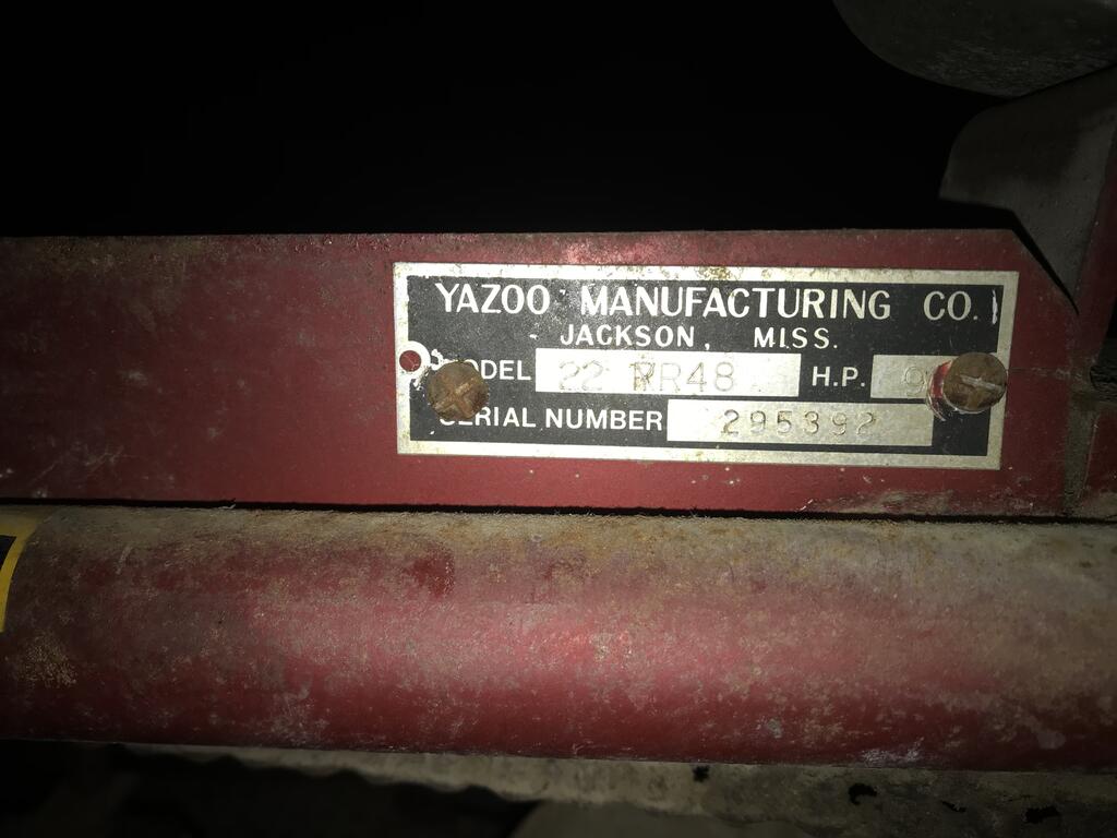

ZXT 2,402 #1 Posted September 13, 2020 Our local antique engine club had a meet today, and it was combined with an antique outboard club meet. Had a decent turnout and I wound up bringing this thing home. It's a Yazoo Master Mower YR-48, with a 9HP Wisconsin AENL. I eyed it last night as I was helping set up for today, buried in a U-Haul trailer under bins of outboard engine parts. When I got home I went ahead and threw some gas and a battery in my truck just in case I bought it. Today, once everything was unloaded around it where I could size it up a little better, I made an offer that I figured would be an insult and it was accepted. The seller (original owner) told me its history said it was a bear getting it into the trailer with 3 flat tires. I wasn't about to try to unload it with 3 flats. One front aired up without issue. The other front was off the rim and the valve stem was broken off. The rear was off the rim and deformed pretty bad. There wasn't a parts store in a 30 mile radius, and I know the owner of the property that we had the meet on quite well, so i went behind his shop and was able to find a wheel and remove the valve stem from it without damaging it. Popped it into the wheel and aired it up. Rear wouldn't air up. Back behind the shop I found another 8" wheel that also had a 5x4.5" bolt pattern. Threw it on and rolled it out of the trailer. Rinsed the 1988 fuel out of the tank, put a battery on it and after cleaning the sediment bowl, tapping on the carb to stop it from flooding over and cleaning the points, it fired up and ran fairly well. Drove it around and mowed a bit and then drove it up on the trailer! What do y'all think? Anyone familiar with them? I just thought it looked tool and liked it since it had a Wisconsin on it. Appears to be original paint as it has all of the factory decals in-tact and in good shape. Did I get hurt at $100? 5 4 Share this post Link to post Share on other sites

ZXT 2,402 #13 Posted September 13, 2020 The tank had some crap in it that was plugging the tank outlet, so I pulled it off, shook a chain around inside of it and rinsed it out. Cleaned the sediment bowl and it fired and idled after the first revolution. Sharpened the blades and mowed my yard. It cuts well, but I don't think it was intended as a finish mower as the deck doesn't let down enough. I'm going to change the oil and then I'll take it out to one of our places that needs brush hogged pretty bad and see how it does! Share this post Link to post Share on other sites
