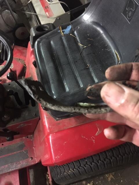

dsholler 54 #9 Posted November 22, 2020 (edited) Any recommendations for cleaning the band if you cannot get it off the tractor? The threads on the rod that pulls the brake band are damaged at the very end, so I cannot get the nut off for love nor money (well, without cutting it off and rethreading the rod, which seemed rather drastic). My thought was to remove the two machine screws and the plate that hold the band on in the front, sand and wire brush the band as best I could with it still attached to the tractor, and glue the new pad from @rmaynardon there. I am using the Goop not the silicone. (this is a bit embarrassing. He sent me the pad months ago and I am just getting around to it now....but it is pretty obvious why it wouldn't stop!) Edited November 22, 2020 by dsholler Share this post Link to post Share on other sites
