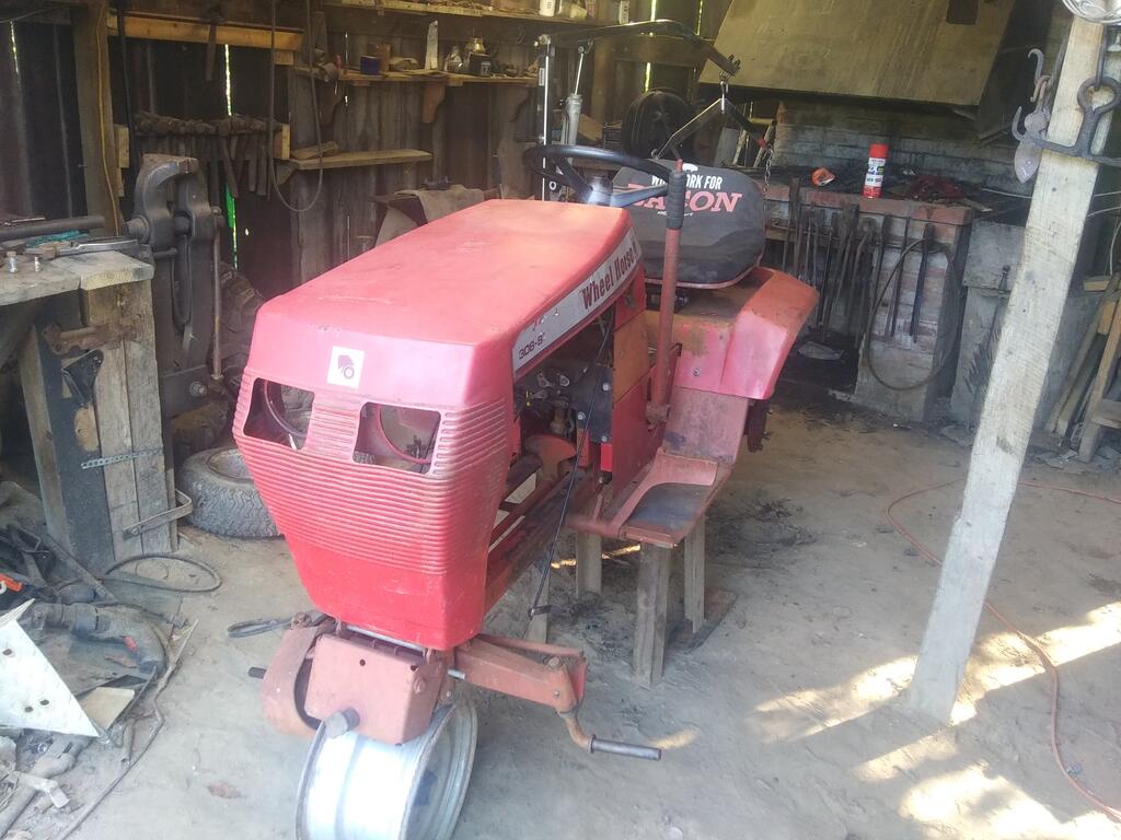

TractorChild97 158 #1 Posted September 9, 2020 (edited) I just recently picked up a 308-8 Wheelhorse without a motor no belt just a frame wheels and rear end. To check the transmissions in other lawn mowers I'll put them in every gear and try to roll it. If the tranny is good it scoots and the tires go different directions. With the wheel horse I could push it in every gear hi and low but there was some hold back and the tranny pully would start spinning. It makes the sound as if your riding downhill and the tractor is holding back. Im 100% new and have never had any wheel horse and know nothing. I would love to learn so lay it on me. Edited September 9, 2020 by TractorChild97 1 Share this post Link to post Share on other sites

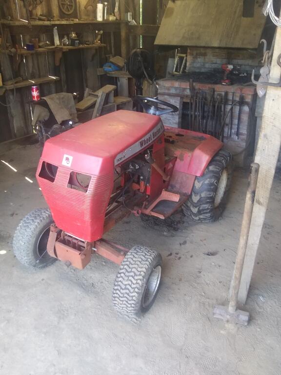

TractorChild97 158 #10 Posted September 9, 2020 Thanks guys big time. I'll get an engine on it and see what happens here soon. If I have a problem I'll definitely dive into the tranny but I'll be back here to have y'all lead me. I just now finished swapping axles in a Peerless 820. Thats the most work iv done in one. I'll post pics of the mower. : ) 1 Share this post Link to post Share on other sites

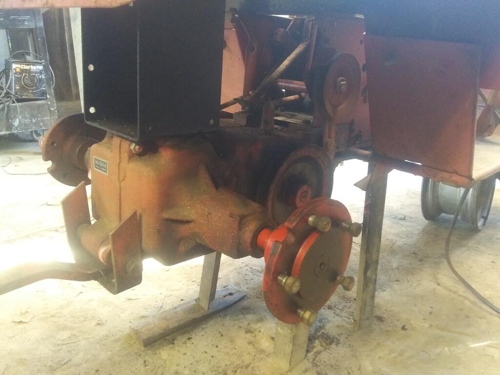

stevasaurus 23,536 #15 Posted September 9, 2020 I'll bet @WHX24 has a guard that will fit your 308-8. Welcome to Red Square. I'd say there is nothing wrong with your trans, but what you could do (instead of pushing it around) is jack up the rear end and try a few things that way. 1. with both wheels off the ground and the trans in neutral...spin one of the wheels in a direction...the other wheel should spin in the opposite direction. Do the same with the other wheel. If it works both ways, with no slips or funny noises, then your differential is good to go. 2. put trans into 1st gear...turn the intake pulley in a counter-clockwise direction...one or both wheels will turn in a forward direction. 3. Repeat with the rest of the gears. when you get to reverse, the wheels should turn in that direction. 4. Don't be shocked if only one wheel turns...simply get someone to hold that wheel from turning, and the other one should start to turn. 5. If you can shift between hi and low range, then that part is good. 6. If all goes smooth, you have a good trans. 2 2 Share this post Link to post Share on other sites
