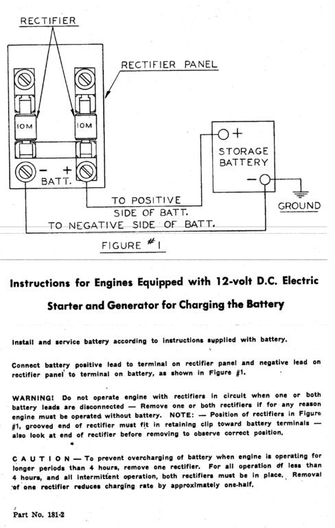

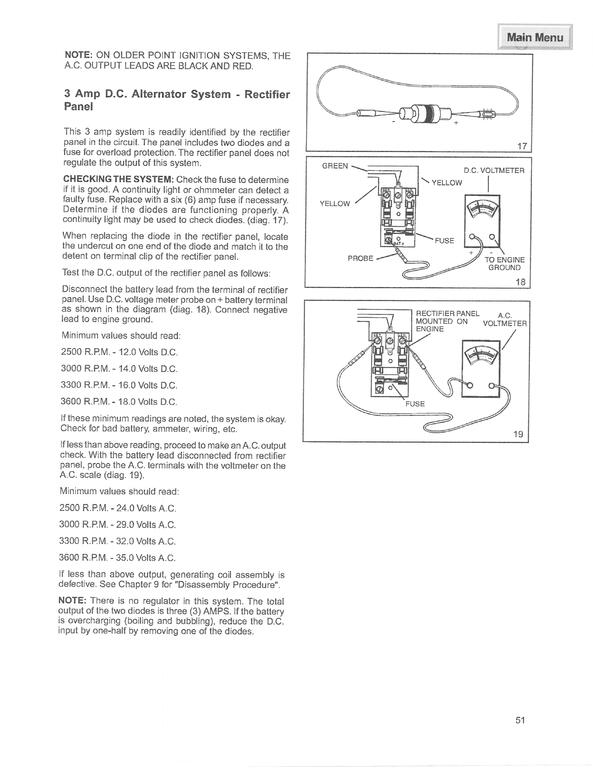

@formariz I saw some old posts about the diodes, should I replace them, how do I know if they are still good?

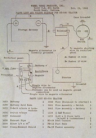

Thanks this all helps,. The key switch has 3 wires, 1 to the positive battery, 1 to the selonoid, and 1 to the to top of rectifier.  Is this correct?

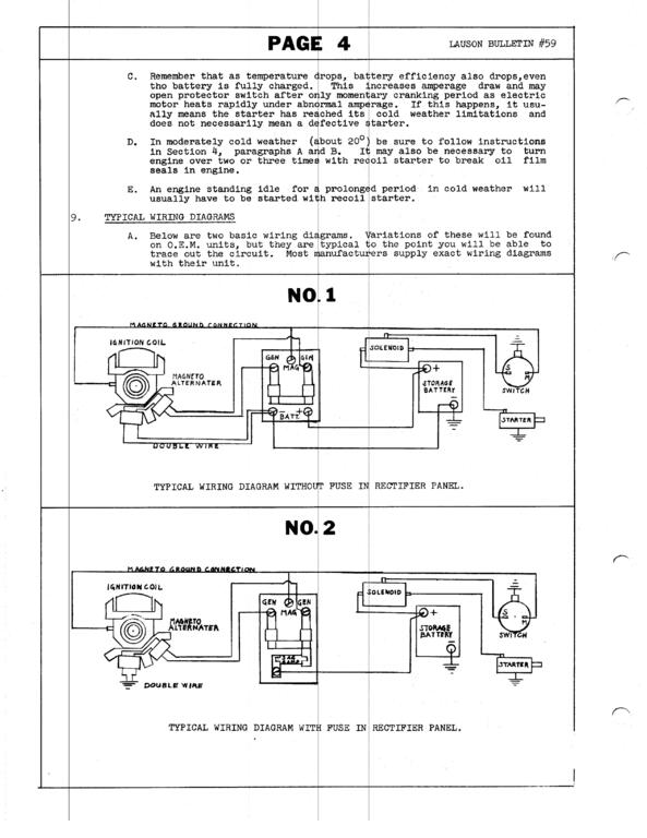

CAREFULL. If everything would be original to tractor absolutely no power to the switch. You will fry the magneto which is not easy to find. Solenoid is also unique to that tractor. It is activated by ground. Take a good look at diagrams I posted. Switch on that tractor is only used to activate ground to starter and to short ground to stop engine.

I think to be safe its going to be pull start for now and hold off on the electronics, going by the diagram the key switch should be 2 pole, so mine has 3 and doesn't follow the diagram.  I don't want to fry out sometime, this engine so far appears in great condition after pulling the head.

Just remove the diodes from rectifier if you are going to use it with the battery disconnected. Then it is just like running any normal magneto engine. To stop it either choke it or use a normal toggle switch connected to the center terminal of rectifiers to ground out magneto. refer to diagrams posted.
