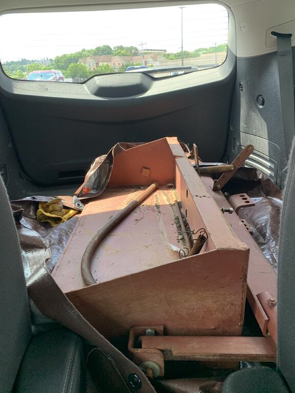

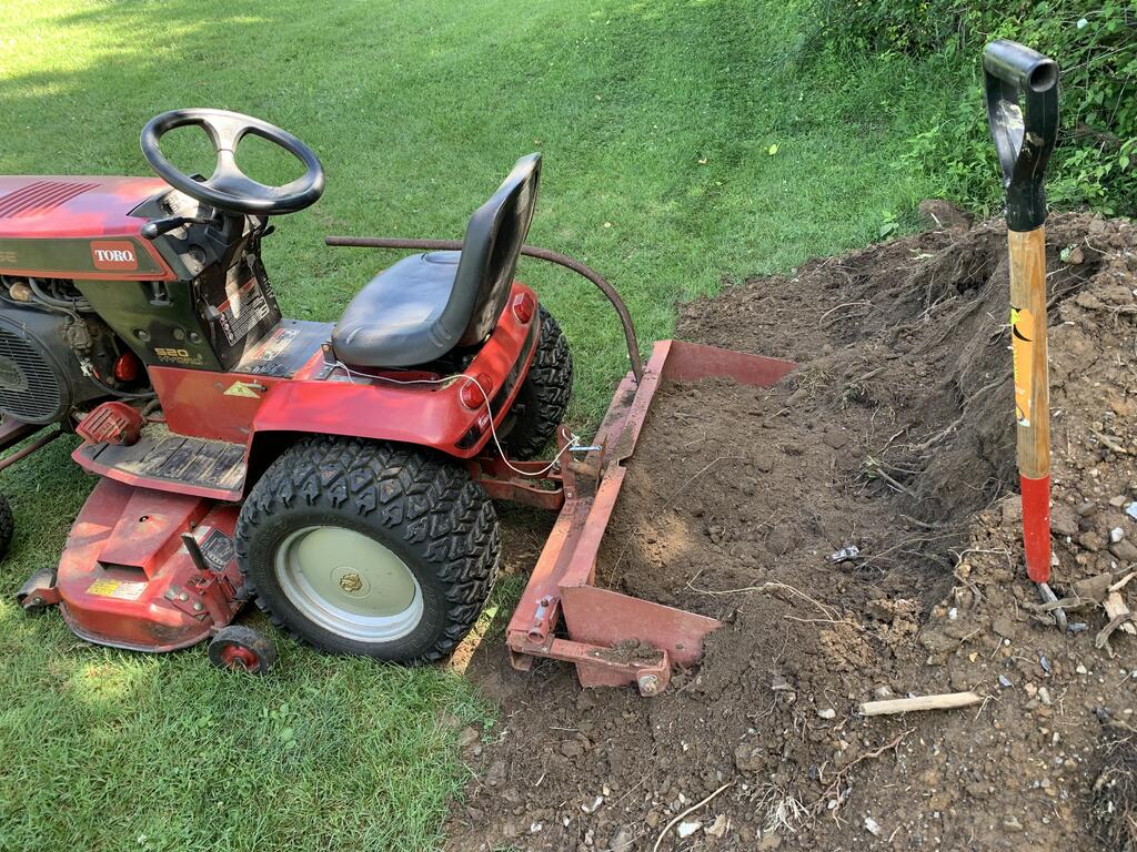

Jon D 82 #1 Posted September 7, 2020 Anyone use one of these? Picked it up cheap about a month ago and making some changes to it. Just welded the frame (it was bolted with pipe) and about to add a linear actuator for dump mechanism. Wonder how much fabrication it would take to attach it to the front? 9 Share this post Link to post Share on other sites
AMC RULES 37,260 #2 Posted September 7, 2020 Google "Johnny bucket" Looks like one mounted up in reverse. Neat attachment, dig it mounted on the back. Share this post Link to post Share on other sites

Jon D 82 #6 Posted September 7, 2020 47 minutes ago, roadapples said: Much rather have it on the front. The old neck don't work the way it used to. Handy unit.... I’m thinking about making a front sleeve hitch to lift it, either on attach-a-matic or build a different frame. Not sure if snowblower lift rod could get it high enough or if I’d need a second linear actuator to lift it 1 Share this post Link to post Share on other sites

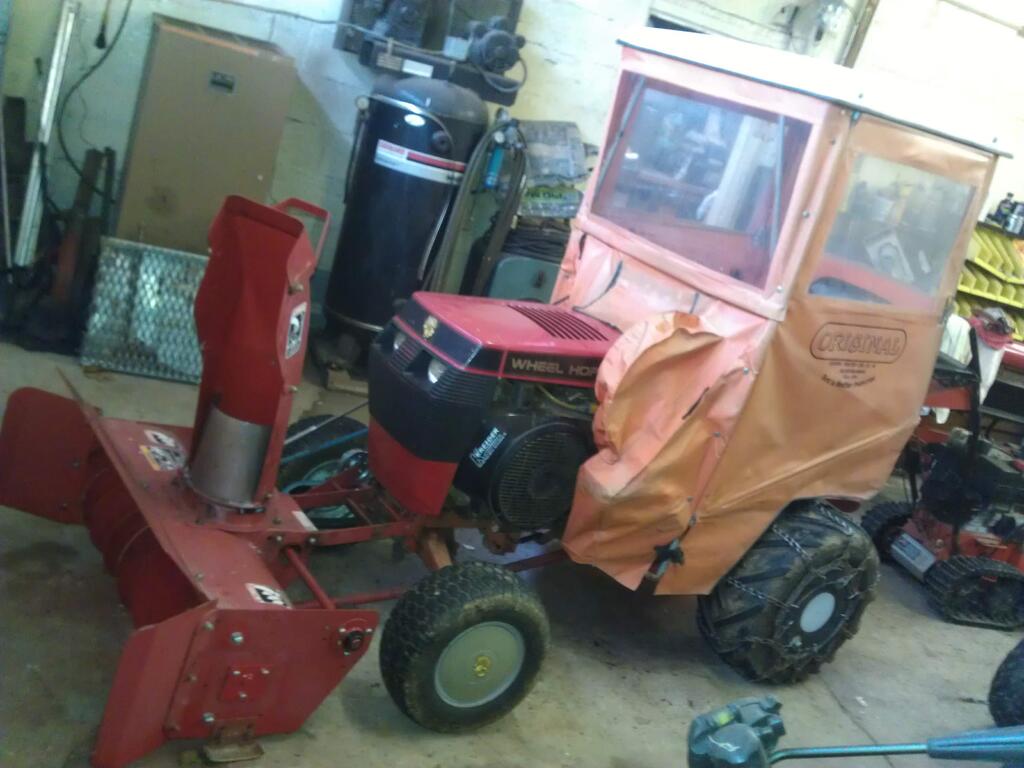

ebinmaine 80,960 #11 Posted September 8, 2020 Anyone know the weight of the larger snowblowers? Share this post Link to post Share on other sites
WVHillbilly520H 10,379 #12 Posted September 8, 2020 (edited) 1 hour ago, ebinmaine said: Anyone know the weight of the larger snowblowers? Approximately 250 for the deuce but it lifts and mounts differently from the singles which is how I would mount a front scoop/ Johnny Bucket. Edited September 8, 2020 by WVHillbilly520H 2 Share this post Link to post Share on other sites
