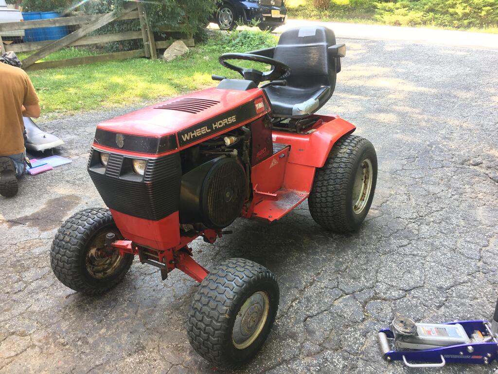

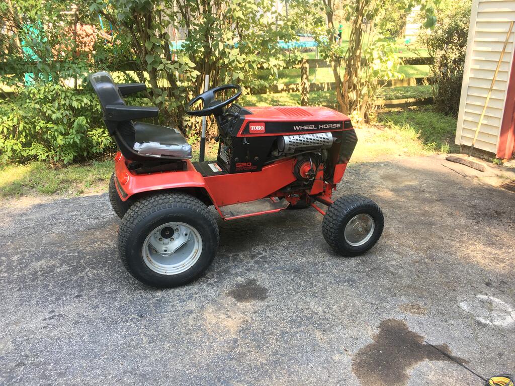

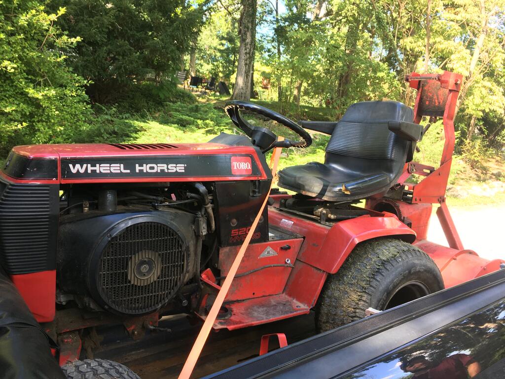

My Sons Score for the weekend
Sam Pasch
She's purddy for 150 bucks.

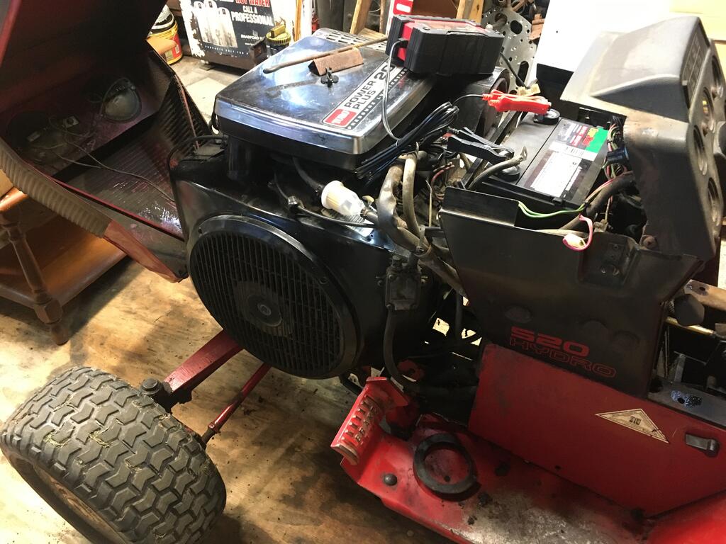

Put a battery in it and all of the electronics are good. All the safeties work and she cranks over. No spark. Coil is bad. Got pulse from the module and 12v to the coil. Wires and grounds are good. Compression is good so far. Not too much crap under the cooling tins.
 What a PITA to work on this thing. Lol. Kohler singles are so much easier. Haha.
Got a coil kit on the way. Hopefully we’ll have a verdict by weeks end.

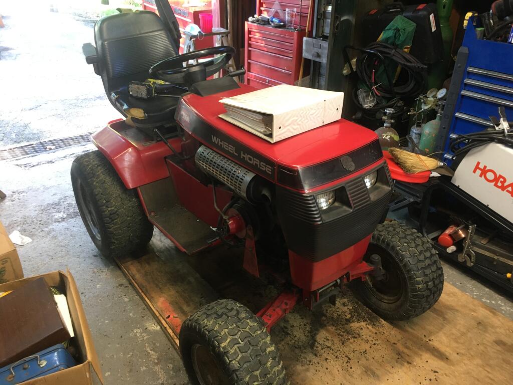

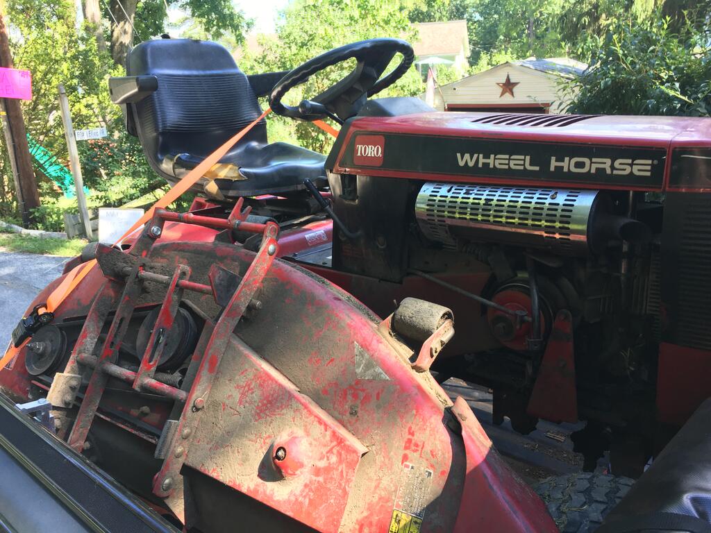

258CC4D0-F8B5-42B0-A0D0-21BE1A26EBFF.jpeg.1476a6f53a75fbe5d84d6937d6f65788.jpeg682786E3-C0FB-49CB-8267-062E603D56F6.jpeg.b8dbc0ed1db9539374f9b0a2aa3d9a1e.jpeg00FA2FC7-6C0E-463C-8636-519ECD77C763.jpeg.b37ae1733b006c12a53505a7c9368462.jpegEED68DC8-0E0C-41B7-AC00-775548DB8951.jpeg.fc2bbc1495691f238d5efb78cd19540e.jpeg

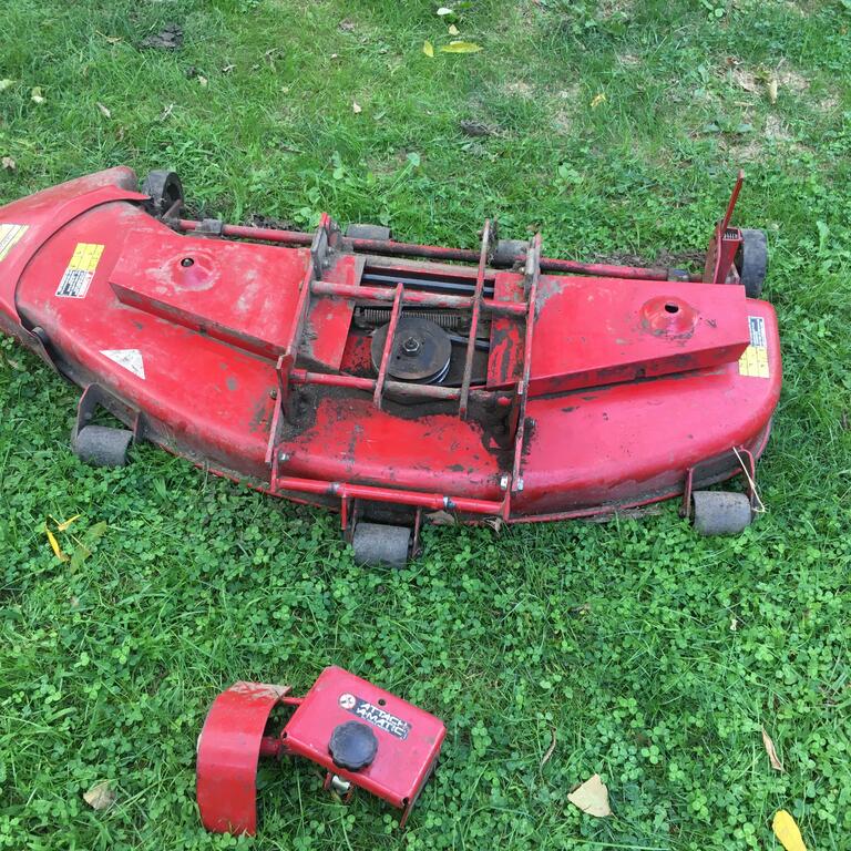

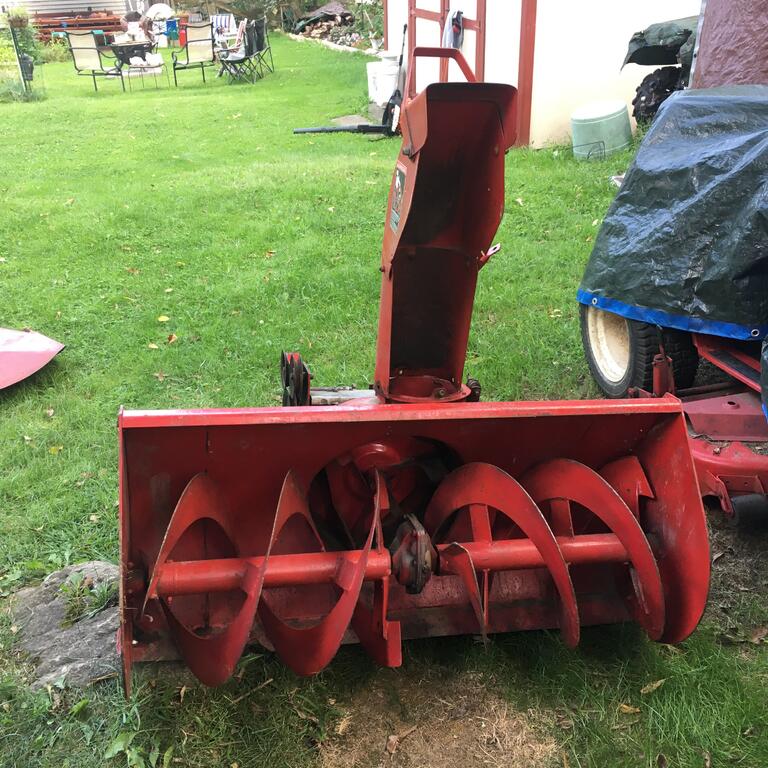

cleaned things up a bit. Missing the chute crank rod for the blower and drive belts for both attachments. Everything else looks good. Tranny fan was shot. ☹️ Hopefully the trans isn’t toast.

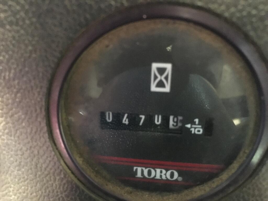

Based on the hours, if accurate, the PO probably didn't use it for long periods of time.  Does anything smell burnt if you pull the dipstick and take a sniff? Those transmissions are pretty tough.  Even if the trans is shot there is over $1000 there if you part it out.  Bill
  • Like 1
Burnerman
The trans fluid,what was left, was clean. All the fluids were drained for the scrapyard. It looks like it was just used and then parked. The snowblower got a lot of use And has a bit of wear. There was grass in the tire tread and the blades are worn out but the rest is perfect.  It was definitely garage kept. There’s no water or rust damage on anything. There is a film of oil and dust and dirt over everything.

It runs.
I followed the troubleshooting guide in the manual. It may have been a bad ground. Anyway it runs pretty well. Goes backwards fine but forward is slow. About 1/2 of what it should. It has plenty of power and will spin the rear tires under load but doesn’t go very fast.
gotta get a new hydro fan and my son can mess with the hydraulics. Lol.
 Update, the brake pedal isn’t returning back all the way pulled back on the pedal and she zooms down the road!!😁

I would guess the linkage is out of adjustment if it has full power but is slow.
Burnerman
Yes. The brake linkage is binding and it’s way out of adjustment. I yanked back on the brake pedal and it goes great. I just have to remove the little parking brake handle to get the side cover off.

 My son will probably keep this one. The deck is in great shape and the snowblower shouldn’t take too much to get going.

So I dig into it today after work and it purrs like a small diesel at idle. Carb bowl had crap clogging the main jet. Cleaned it all out, fixed the crappy trigger wire, new coil, condenser and plugs. Put on a fresh air filter and it’s awesome.
tmw the deck gets a cleanup and fresh blades and we’re mowing.
