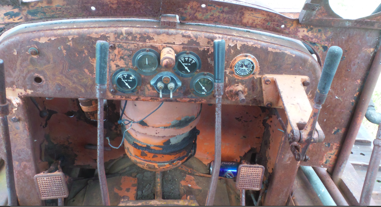

Tractorhead 9,217 #2 Posted September 5, 2020 Cool dash 2 Share this post Link to post Share on other sites
Pullstart 71,016 #3 Posted September 7, 2020 On 9/5/2020 at 6:27 AM, Tractorhead said: Cool dash Cool Everything! 1 1 Share this post Link to post Share on other sites
c-series don 12,321 #4 Posted September 7, 2020 Very cool looking dozer, I can only imagine what that looked like new! Who made it? Share this post Link to post Share on other sites

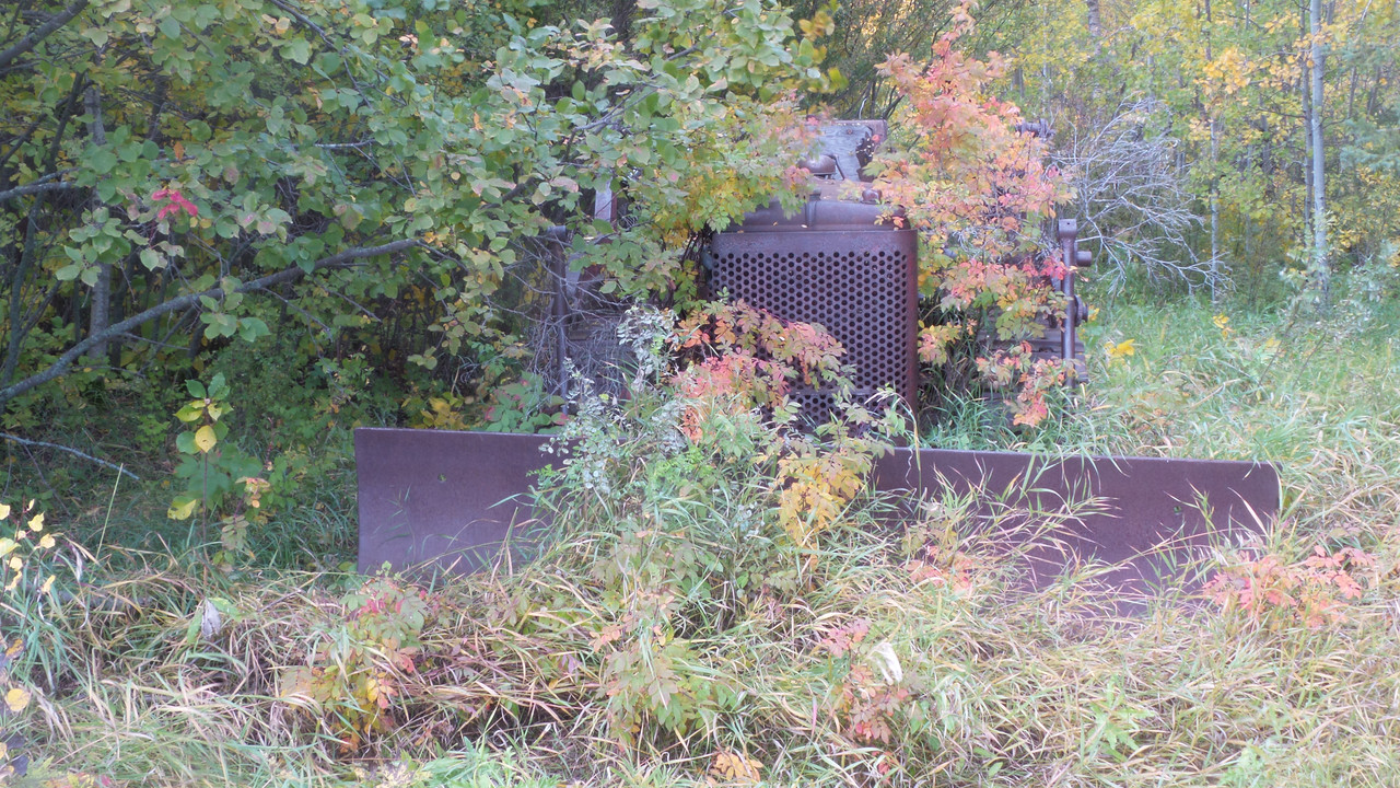

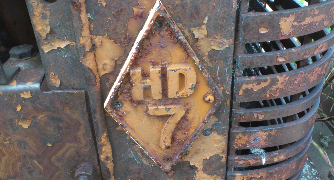

bc.gold 3,406 #5 Posted September 7, 2020 (edited) 40 minutes ago, c-series don said: Very cool looking dozer, I can only imagine what that looked like new! Who made it? Alice Chalmers made a series of HD crawlers the 7 has the 3/71 screaming Jimmy. The neighbour the CEO of Sperling Industries two years ago had a stroke, he recently handed over the reins of his company to his eldest son. This hobby farm was the jewel in his cap, Buffalo and Elk, the animals have been sold off and most of the land holdings have changed hands. Russ and Lynne kept the parcel that has the new house they built about fours years ago. Whenever I'm visiting his wife always places me at the table next to Russ, one time she served salmon from a guided fishing expedition Russ had gone on, as were eating the fish i looked over at Russ asking, and how much a pound did this cost ya. Edited September 7, 2020 by bcgold 2 Share this post Link to post Share on other sites

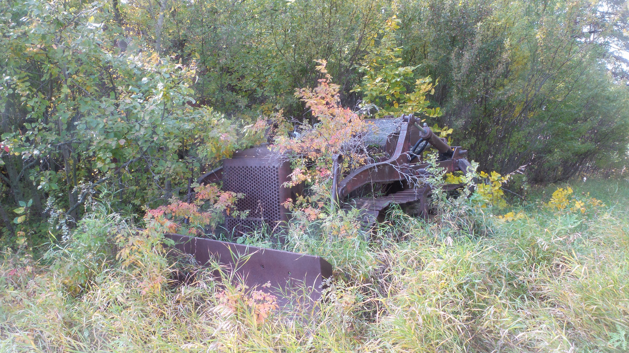

bc.gold 3,406 #6 Posted September 21, 2020 One of my neighbours ( Greg ) purchased the HD7 for 1K Canadian which would run you fellas south of the 49th about $800.00 US. Engine is not seized, sprockets and rollers have been replaced and the track pins are in excellent condition and have never been turned. PO wants it removed from his property before years end. Share this post Link to post Share on other sites
bc.gold 3,406 #7 Posted September 21, 2020 (edited) The HD7W is a WWII left over, built in 1943, during the second world war there were a lot of military training camps in Manitoba , one of my dump finds. A flame thrower nick named the life buoy because of its shape. I've also found a bunch of old airplane frames pushed into a brush pile, one neighbour had a complete RCA radio transceiver which was part of the lend lease program. So it's of little surprise to have this war relic show up, I've located and downloaded the technical manuals published by the War Department. Edited September 21, 2020 by bcgold Share this post Link to post Share on other sites

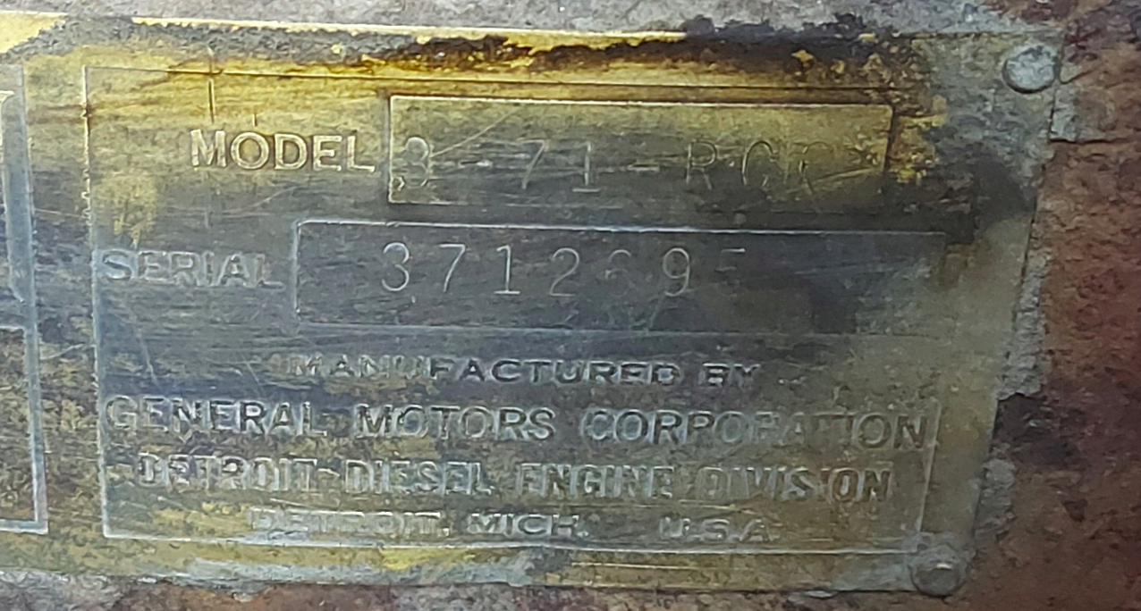

bc.gold 3,406 #11 Posted September 21, 2020 (edited) To further qualify this HD7-W as being military equipment the serial and model tag from the engine, 3-71-RCE which would have designated Royal Canadian Engineers. Edited September 22, 2020 by bcgold Share this post Link to post Share on other sites

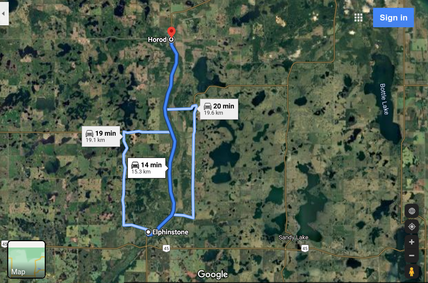

bc.gold 3,406 #14 Posted September 21, 2020 (edited) I would lay odds that our HD7W was used at the WWII German POW camp and has since not ventured far from home as you can see from the map Horod where the cat now resides is not far from Whitewater. Whitewater was a labour camp for German prisoners-of-war in Riding Mountain National Park, Manitoba. Operating from 1943 to 1945, the camp was built on the northeast shore of Whitewater Lake, approximately 300 kilometres (190 mi) north-west of Winnipeg. The camp consisted of fifteen buildings and housed 440 to 450 prisoners of war. From Horod the HD7W will be relocated to Elphinstone, bottom image. Edited September 21, 2020 by bcgold Share this post Link to post Share on other sites

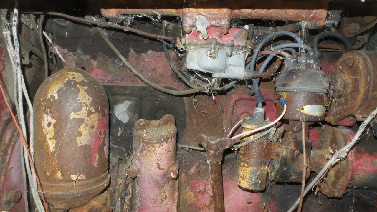

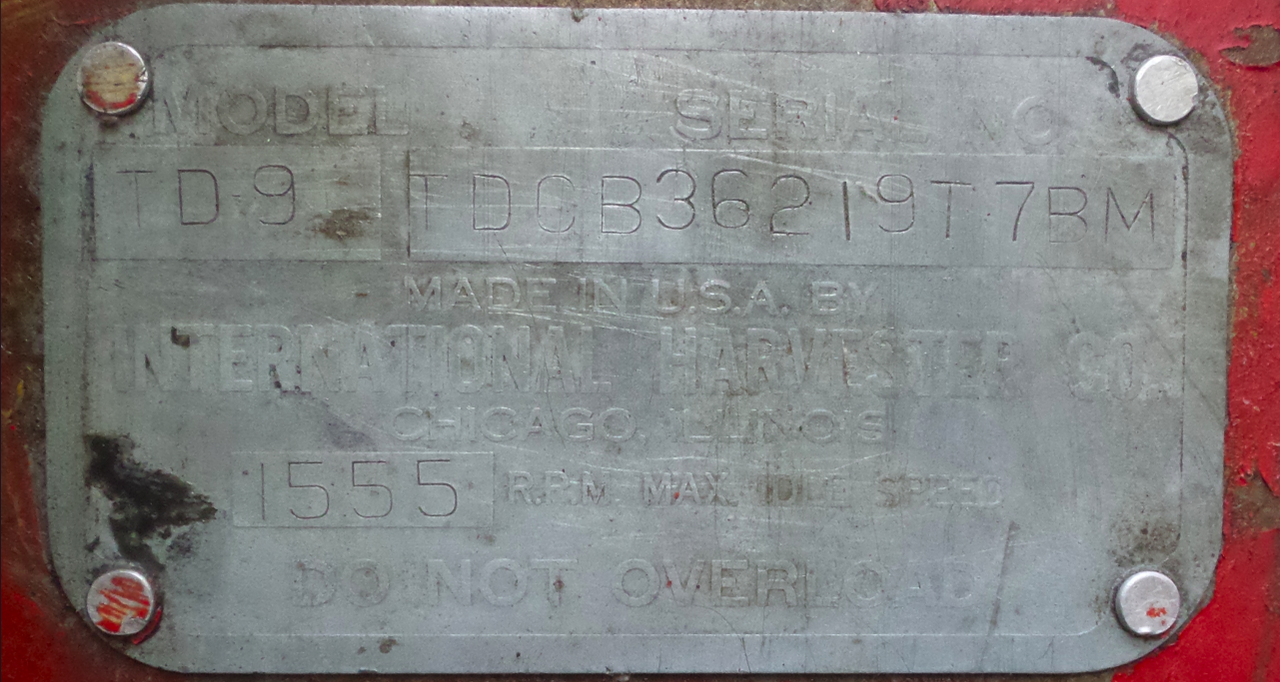

bc.gold 3,406 #15 Posted September 21, 2020 (edited) The International turns out to be a TD9, the serial number puts its birth date late 1940's The TD crawler engine used an electric starter, the engine first fired and ran on gasoline until it warmed up enough for the operator to switch over to diesel fuel. Edited September 21, 2020 by bcgold Share this post Link to post Share on other sites

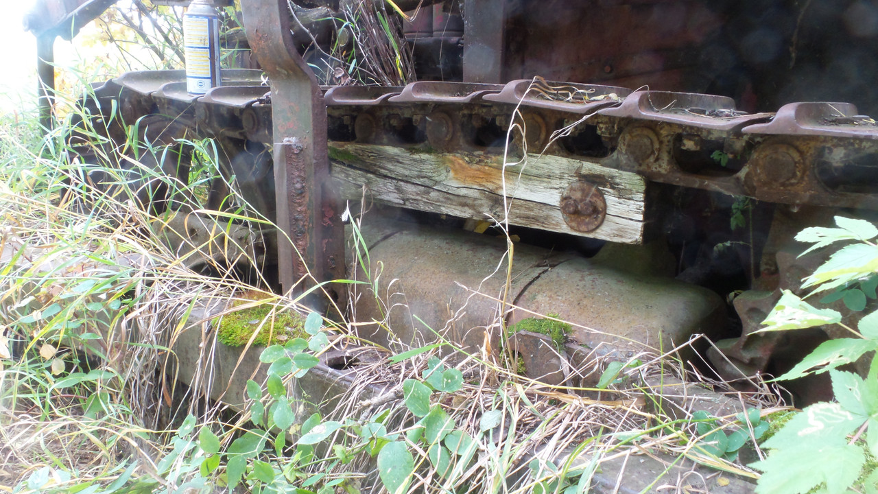

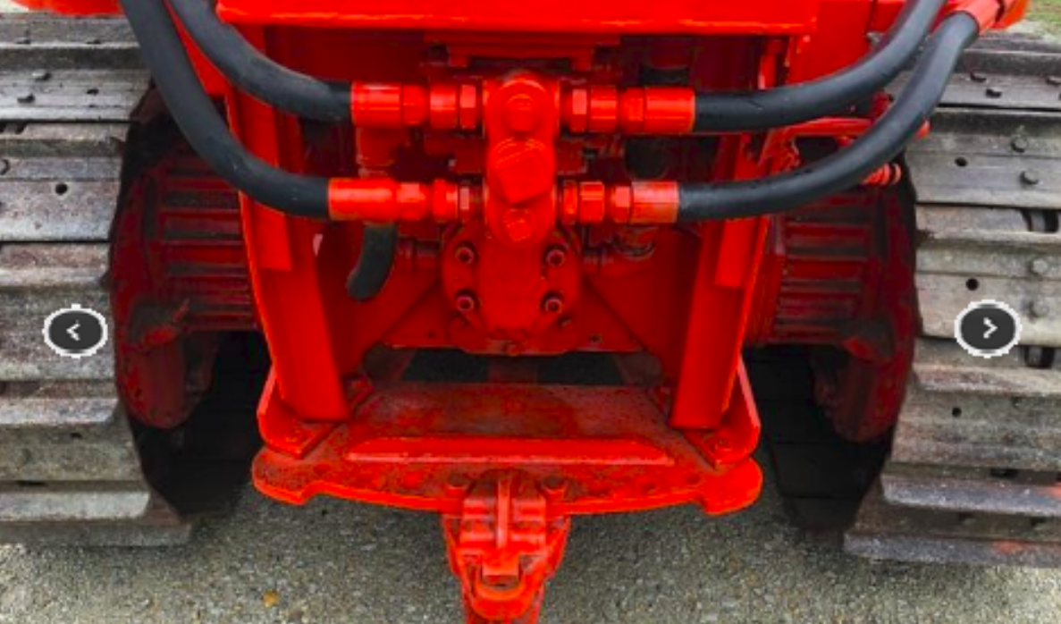

bc.gold 3,406 #16 Posted September 22, 2020 (edited) We now know why the HD7-W was parked, the distribution manifold for the hydraulics also contains the spool valve that lifts and lowers the blade. At some point a careless operator backed into something very solid and broke the casting, the part had been welded with regular type welding rod and the weld let go. Welding cast iron is an art that most people have trouble mastering. Edited September 22, 2020 by bcgold Share this post Link to post Share on other sites
bc.gold 3,406 #17 Posted September 22, 2020 Used tank, control valve and hydraulic pump - $750.00, the sales rep. hesitated shipping to Canada said it was too much hassle with the paper work. Told him not to worry about the paper as I would get in touch with my customs broker to arrange shipping and customs. I've used htis broker several times and have never had a face to face everything done via email and pdf files. Greg gets to lean how to use his multi purpose printer. Share this post Link to post Share on other sites

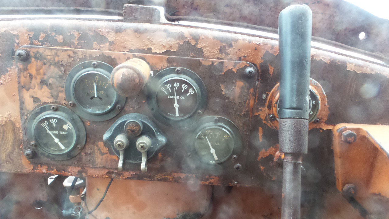

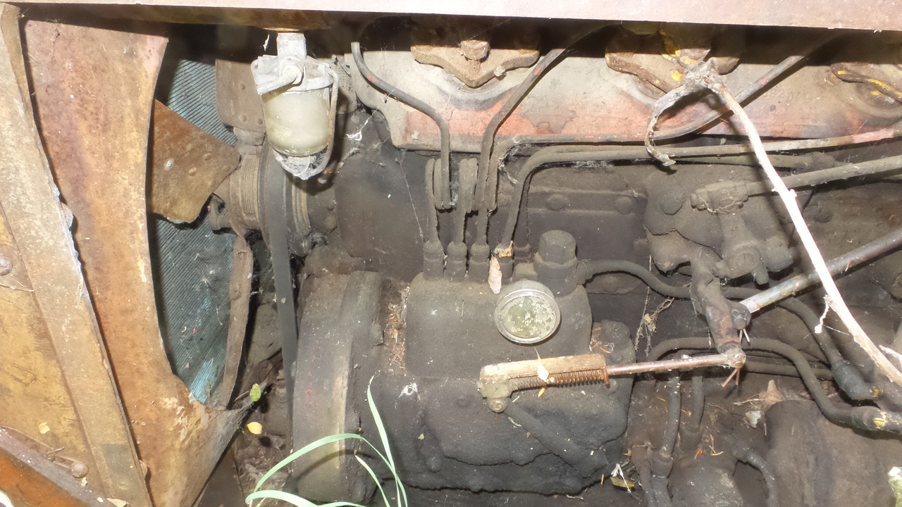

bc.gold 3,406 #23 Posted November 4, 2020 (edited) Missed moment, after sitting fifty years to the elements the HD7W made smoke and moved under her own power. Tomorrow she hitches a ride on a low bed into Elphinstone. I'll try to be there to Videograph the loading. Two of the injector racks were stuck and had to be freed up, the main clutch fine and steering clutches were bit sticky but improved with the move from the field to the home site. Edited November 5, 2020 by bcgold 2 Share this post Link to post Share on other sites
bc.gold 3,406 #24 Posted November 5, 2020 (edited) The HD7W walk around, decent oil pressure, injector on number one cylinder slobbers fuel by the quart but after sitting for 50 years not to shabby. The Detroit diesels are easy to work on and parts were made by the millions perhaps in the billions which kept the cost down. There's a decent injection shop in Brandon that does good work at decent prices. I rebuilt the injectors for a Mitsubishi Pajero and had the Brandon shop set the pop off pressure for me, decent guy to work with. Edited November 5, 2020 by bcgold 1 Share this post Link to post Share on other sites
