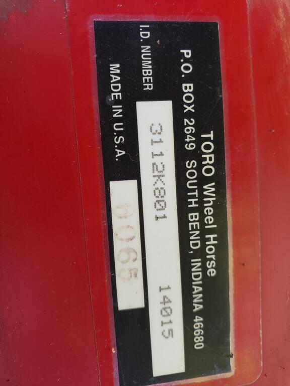

Darrell Chapman 4 #1 Posted September 4, 2020 I am new to the Red Square and I have just recently purchased my first wheel horse a 31-12K801-312-8 (tag attached) and I having a hard time figuring out the year so I can get some parts. I thought it was a 1990 but it does not have a hydrostatic lift and everything on 1990 does that I have looked at. Any help would be appreciated. 1 Share this post Link to post Share on other sites
daveoman1966 3,884 #2 Posted September 4, 2020 That is a 1990 model year. 31-12K801 1990 312-8 Garden Tractor 8 Speed Kohler When looking up model #, be sure to load it EXACTLY as I did here: 31-12K801 What parts are you looking for? Share this post Link to post Share on other sites

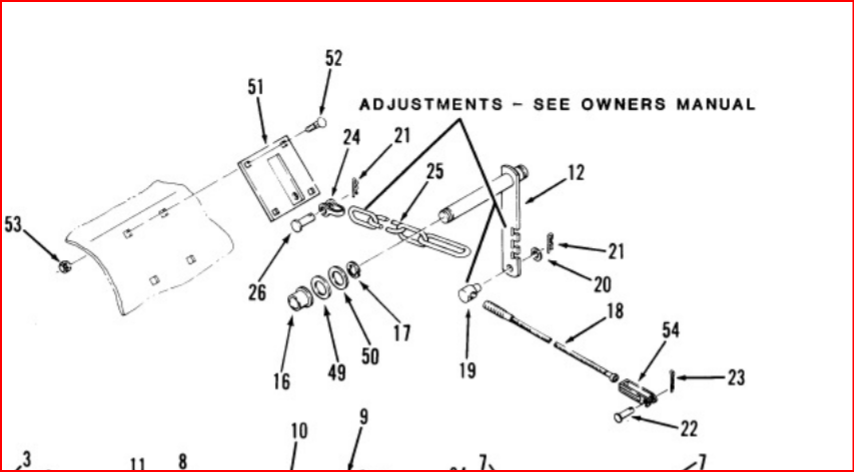

Darrell Chapman 4 #3 Posted September 4, 2020 I am looking for the linkage to connect to a tiller that came with it Share this post Link to post Share on other sites
WHX?? 58,347 #4 Posted September 4, 2020 Darrell If you need the manual for the tractor or tiller we would have them. This guy @wheelhorsemanmight have the tiller parts you are looking for. https://wheelhorsepartsandmore.com/tiller.html 1 Share this post Link to post Share on other sites
gwest_ca-(File Mod) 12,535 #5 Posted September 4, 2020 Welcome to the forum. May not be the same model tiller but this parts list will show everything that is required. More on the tractor - 2 pages https://www.wheelhorseforum.com/search/?&q=31-12k801&type=downloads_file&search_and_or=or&sortby=relevancy Garry Share this post Link to post Share on other sites
Darrell Chapman 4 #6 Posted September 4, 2020 I can find all of the manual except nothing that shows the lift mechanism for the tiller, I can find diagrams for electric lift but not manual. Thanks everyone for helping. 2 Share this post Link to post Share on other sites
WHX?? 58,347 #7 Posted September 4, 2020 (edited) This is the entire lift parts for manual or HY lift. If this tiller was mounted on the tractor the rear rockshaft, #12, & lift cable should be there. Its in the tunnel under the seat. If it's not there you will need it. Instructions on how to put it all together will be in the tiller manual. Edited September 4, 2020 by WHX24 1 Share this post Link to post Share on other sites
Darrell Chapman 4 #8 Posted September 4, 2020 Thanks Jim , can yo send whole page with part numbers please or tell me where to go to find it. Share this post Link to post Share on other sites
WHX?? 58,347 #9 Posted September 4, 2020 Click on the fuzzy pic in Garry post and it will take you to the IPL download. Here is a manual but might not be right unless we know your tiller model but will be close. Sorry not the best copy. 3314-767_1992_Tiller_36in.pdf Share this post Link to post Share on other sites
Darrell Chapman 4 #10 Posted September 4, 2020 Thanks everyone this really helps. 1 Share this post Link to post Share on other sites
