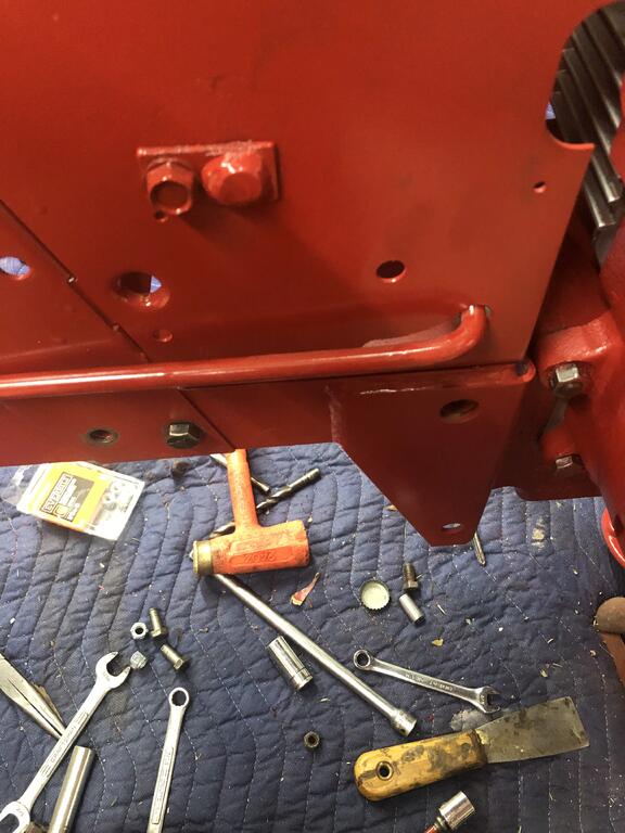

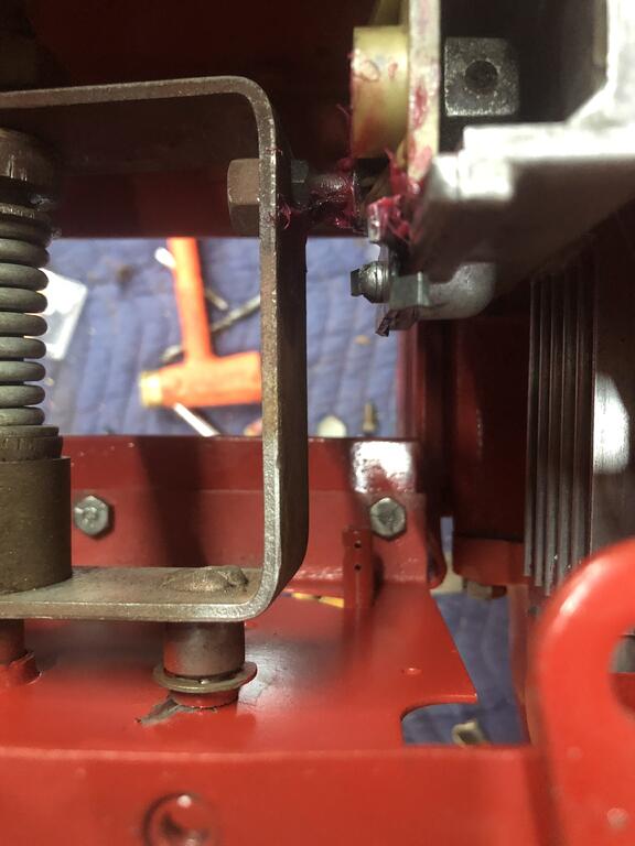

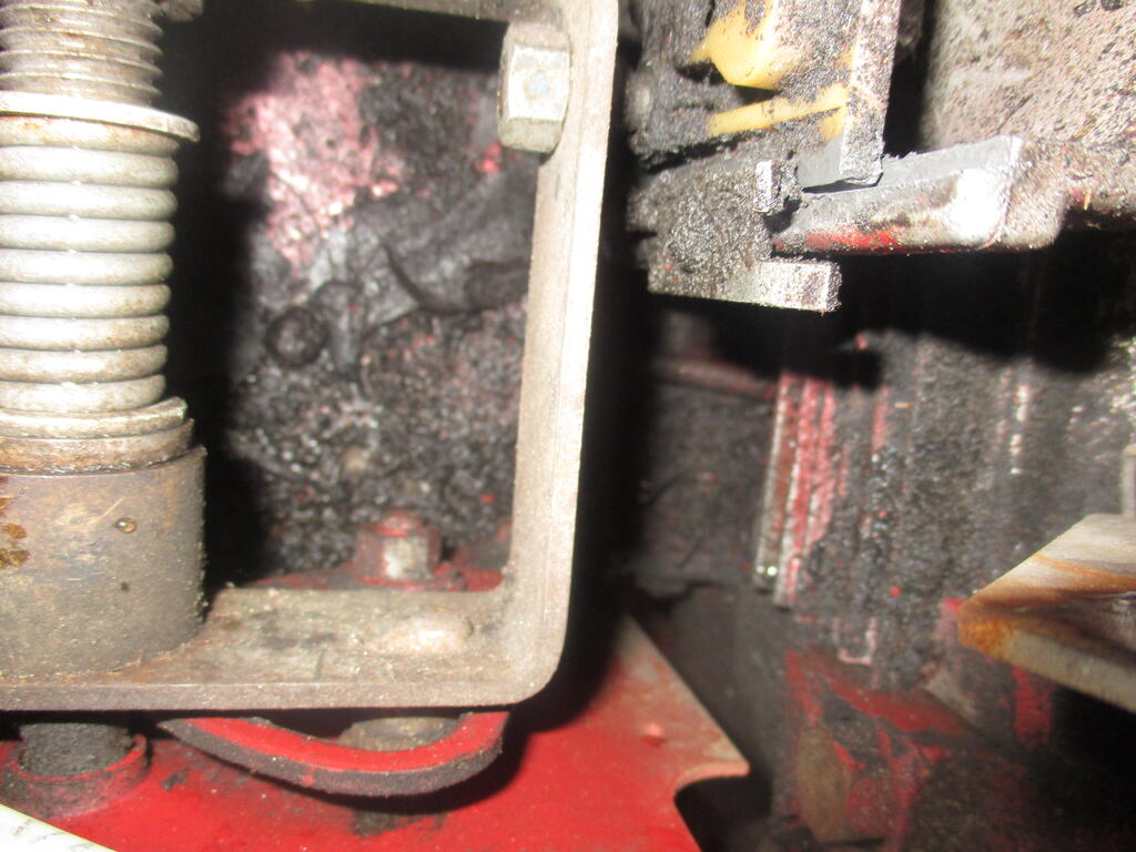

Kenneth R Cluley 713 #4 Posted August 22, 2020 Don't know if this helps, this is my 69 Charger 12. Model#1724, serial#572695. 1 Share this post Link to post Share on other sites
Kenneth R Cluley 713 #5 Posted August 22, 2020 Eccentric plate rotates on bolt at lower end and rod thru with cotter pin/washer, rotates along roller when brake activated. 1 Share this post Link to post Share on other sites

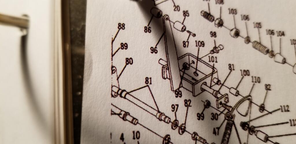

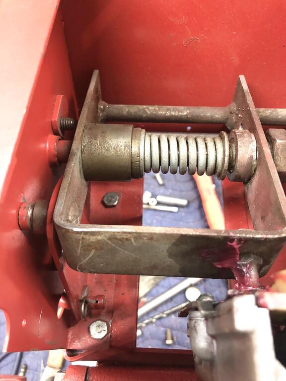

gt14rider 1,283 #9 Posted August 23, 2020 Part #110 connects to rod,to foot pedal 1 1 Share this post Link to post Share on other sites

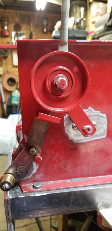

The Tuul Crib 7,354 #10 Posted August 23, 2020 (edited) Here's what I have so far. Looks like everything works. The drive belt idler doesn't seem right. Edited August 23, 2020 by The Tuul Crib Share this post Link to post Share on other sites
pfrederi 21,312 #11 Posted August 23, 2020 Idler rides on top of the upper belt run not below.... 1 1 Share this post Link to post Share on other sites

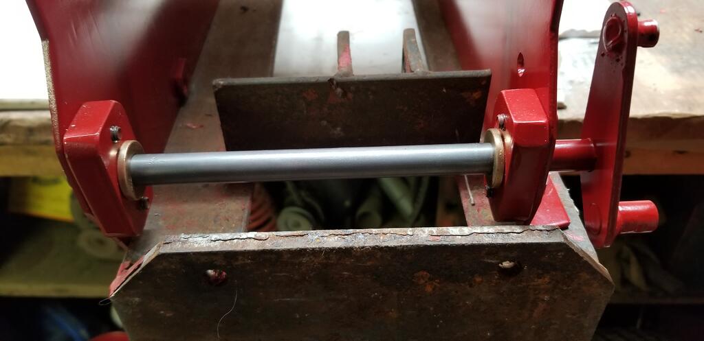

Achto 32,927 #12 Posted August 23, 2020 (edited) The belt should run like this. Sorry I'm late with pictures. This pic is of a Bronco 14 but same idea. Looks like your missing one piece yet. The picture that GT 14 Rider posted shows the brake pedal set up well Edited August 23, 2020 by Achto 1 Share this post Link to post Share on other sites
The Tuul Crib 7,354 #13 Posted August 23, 2020 8 minutes ago, Achto said: The belt should run like this. Sorry I'm late with pictures. This pic is of a Bronco 14 but same idea. Looks like your missing one piece yet. The picture that GT 14 Rider posted shows the brake pedal set up well No worries! Now this is what I have been looking for! I see the part now that I am missing. It probably wasn't there to begin with when I got the tractor about a year ago. Thanx Randy 1 Share this post Link to post Share on other sites

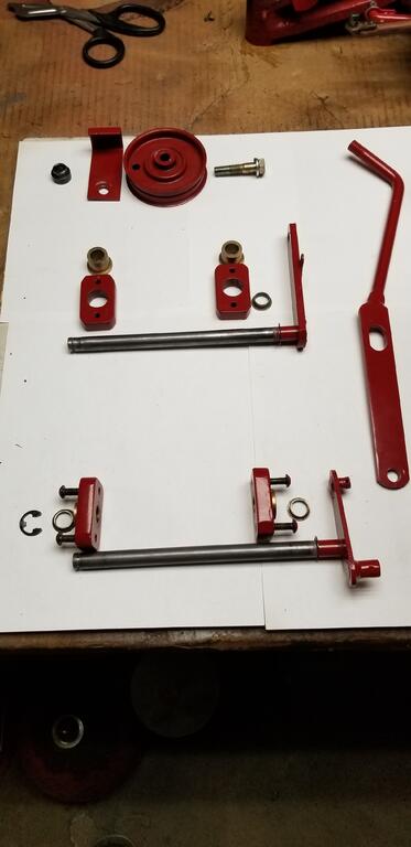

Achto 32,927 #14 Posted August 23, 2020 That part should have a shaft on it that runs through the frame. I'll try to get a part number for you a little later. Share this post Link to post Share on other sites
The Tuul Crib 7,354 #15 Posted August 23, 2020 Just found the piece that was missing. Now all I need is the spring! 1 Share this post Link to post Share on other sites

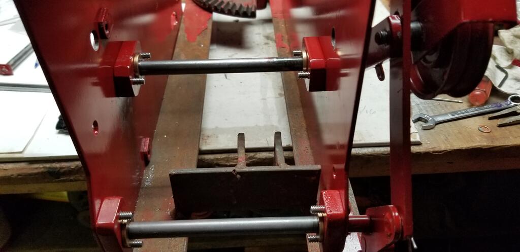

gt14rider 1,283 #16 Posted August 23, 2020 This set up off gt14, should be similar 2 Share this post Link to post Share on other sites
The Tuul Crib 7,354 #17 Posted August 23, 2020 (edited) Nice work! I wish I had access to a machine shop. Unfortunately I have a wood shop which still isn't all that bad! Edited August 24, 2020 by The Tuul Crib 1 Share this post Link to post Share on other sites
